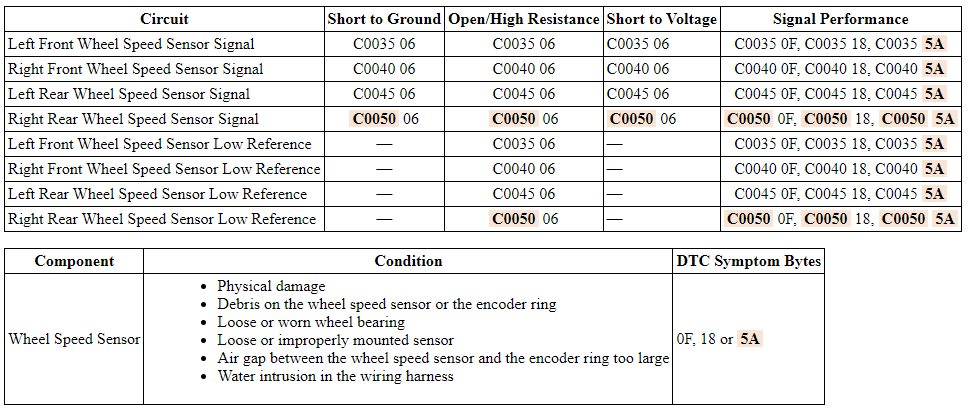

As mentioned before, the symptoms point to a damaged tone wheel in my opinion. The open circuit codes would likely come right back after clearing if there was an open circuit/sensor.
Because it takes some driving and sets a plausibility code leads me to believe that the tone wheel has debris or damage or some similar fault. Possibly even rust/corrosion jacking under the sensor effecting the air gap.
In any case, without ABS data, you are left with little troubleshooting ability unfortunately, beyond what the code set conditions can tell us.

I agree with Noah, you can't use an external source to do any kind of bypass testing on this system. If anything, you learned more about circuit integrity when the C0050-06 code set. :silly: GM digital wheel speed sensor systems are excellent at detecting circuit issues, and your Cruze didn't have one until you unplugged that sensor.
From GM SI:
Note: If any of the symptom codes 0F, 18 or 5A are set, refer to the Diagnostic Fault Information table for possible mechanical faults or conditions.

With this information that you sent me I feel confident about getting the hub from RockAuto.

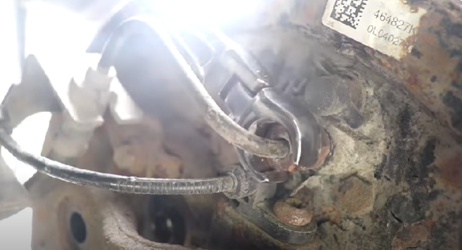

I had seen a video that shows my dilemma, just can't remember which video. The screw securing the sensor is right under the brake line going into the wheel cylinder with about 1/2 an inch clearance between the two. The screw is a torx screw.
4 years 10 months ago - 4 years 10 months ago #52790 by Tyler
Replied by Tyler on topic 2011 Chevy Cruze w/1.8l engine
Ah yeah, I remember that now! For anyone following along:
I always just left the line and WSS installed? :silly: But that may not be possible for you depending on how crusty the hub and backing plate are.
If you do have to take the wheel cylinder line off, no big deal. Cap the line while you're working to stop fluid loss. I like these little MityVac plug sets, but you can use whatever is handy.
www.amazon.com/Mityvac-MVA6004-Vacuum-Line-Cap/dp/B007TMSNYM
When you've got everything reassembled, just bleed the brakes like normal using the bleeder screw. As long as you get the air out, and you didn't run the master cylinder dry, you're golden. B) The ABS will never know the difference.
