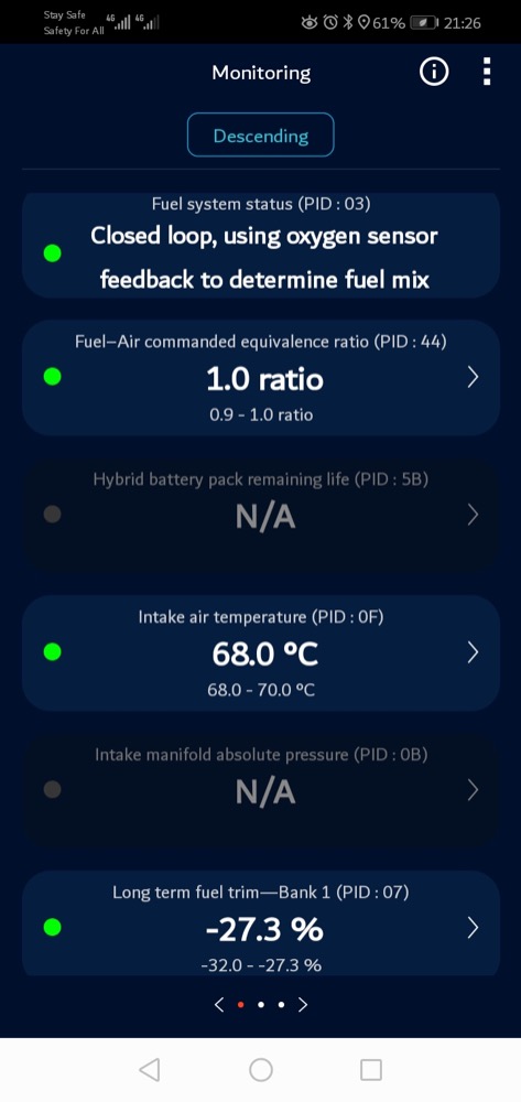

Good day,
I do appreciate coming across the forum as i have learnt from other people car related challenges.
I am kinda DIY guy. I am being faced with P0172 P0101 toyota camry 2008 2.4ltr, 140K Miles... i have tried all i could to get rid of these codes even with the help of some local technician, but to no good result. The fuel trim is STFT -2.6% LTFT -35% I notice the LTFT does not fluctuate at all even on diffrent RPMS and on the high way.
I have change MAF sensor, AFR sensor, Checked the PCV valve, checked for Vacuum leak, Checked/clean the injectors. I also notice the the car stall while trying to start on cool engine even worse on cold engine. It does this every morning on when the engine is cool. There is black smoke on the exhuast tail pipe and misfire somtimes at a stop light.
Please kindly advice as i have exhausted all ideas...

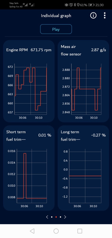

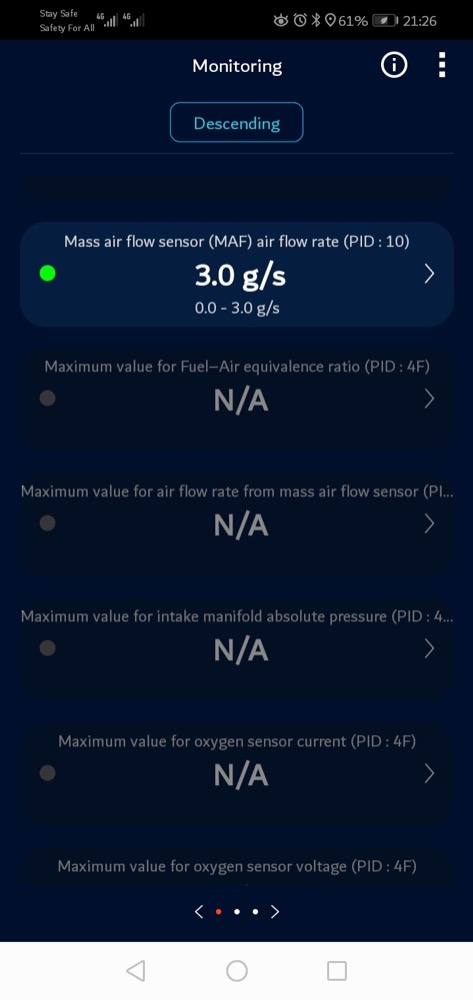

5 years 3 months ago #50146 by osinor
Replied by osinor on topic STUBBORN P0172 and P0101
Maf shows 2.9 at idle 3.0 - 3.1g/s on load

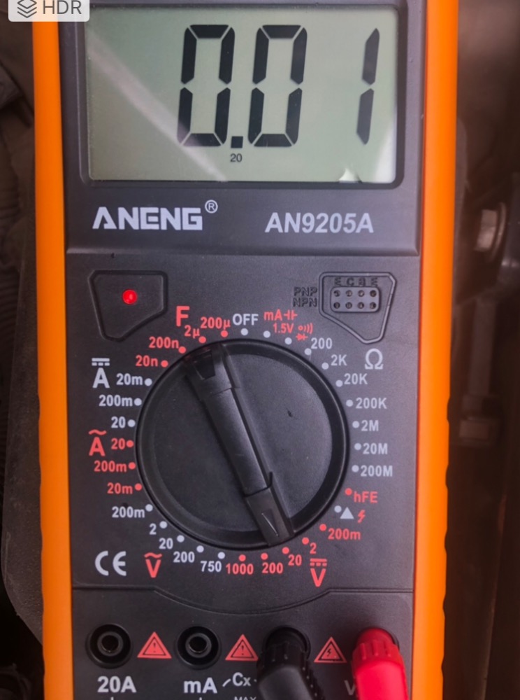

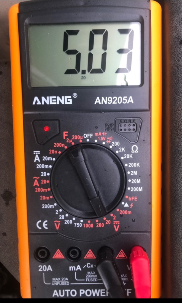

  • osinor
  • osinor's Avatar Topic Author

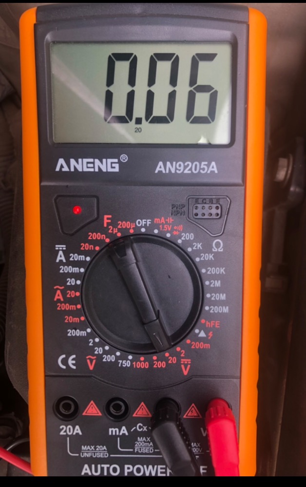

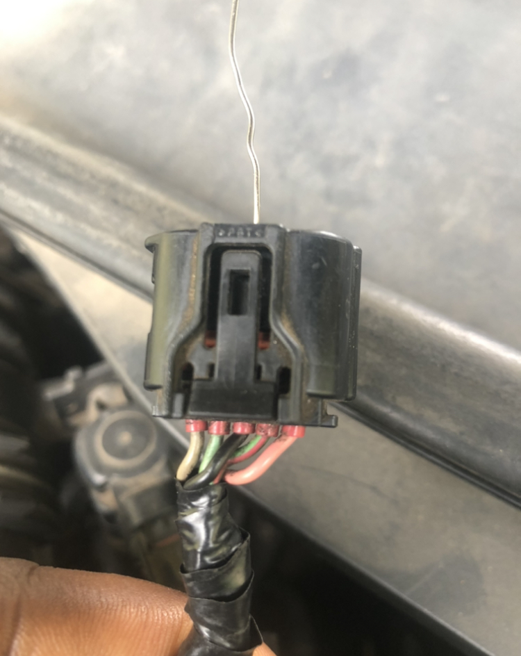

5 years 2 months ago #50260 by osinor
Signal is 5.3V but other wires reads  0.01 while the middle black wire which is earth reads 0.06
paper clip could not go through the connector due to the tightness.
see photos
  • VegasJAK
  • VegasJAK's Avatar
  • Silencing the Parts Cannon
5 years 2 months ago #50377 by VegasJAK
Replied by VegasJAK on topic STUBBORN P0172 and P0101
You have a five wire sensor harness. 3 wires are for the MAF and 2 wires for the IAT.
3 wires of MAF. 12v feed, 5v signal reference and a ground.
2 wires if IAT. 12v feed and ground.
I do not have wiring diagram for your Toyota but two outside pink wires should be IAT.
DO NOT use paper clip to probe female ends of a connector as this will bend the legs open and cause a bad connection. If you probe the female ends just touch them lightly.
If you do not have 12v on the feed wire for the MAF you have an open. You should have two 12v wires. One for MAF and one for the IAT. If no 12v, go to the ecm and check feed there. You'll need wiring diagram for this. If 12v at ecm then the MAF feed wire is open some where.
5 years 2 months ago #50379 by jreardon
Replied by jreardon on topic STUBBORN P0172 and P0101
i.imgur.com/wNByFpL.png
You'll need to have the circuit loaded, meaning plugged in and key on, and take live measurements back probed while there's current flow. Since we're dealing with negative trims, my first thought is over reporting sensor and higher voltage which would lead me focus on the ground wire. A bad ground would elevate signal voltage I think, so check that one. I know the colors don't match but the designation for each pin should be right.
