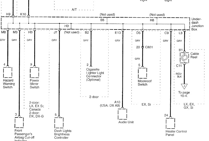

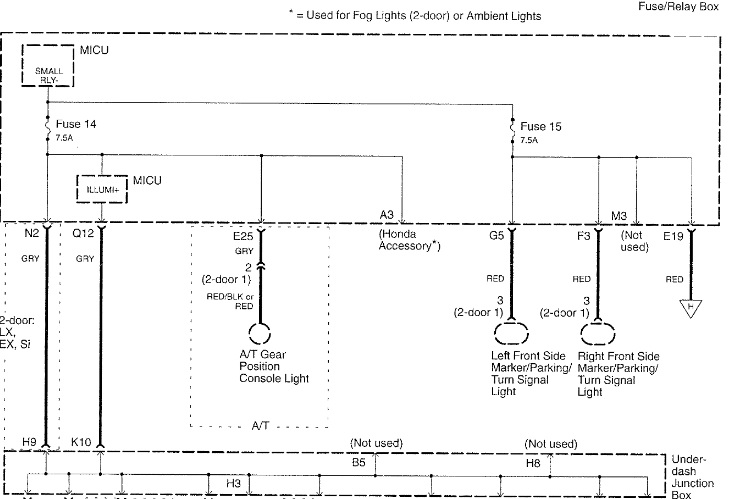

Which fuse were you looking at, specifically? It's tough to see on the wiring diagrams which one is the back up circuit. I had a glance at the power distribution, and I see a fuse #14 in the under dash box that seems to cover some of the systems you listed:
Does your draw go away when you pull this fuse?
When you noted using a test light on the positive cable, do you mean that you put the light in series between the battery post and the cable end?

Fuse 23. 10A "backup". When the fuse is pulled, it stops killing the battery. But, when I shut the car off, the tac needle sits at idle rpm. So then I have to turn the key to accessory until the needle drops to 0, then off again. If I don't do this, it still kills the battery.
And yes between the cable and post
