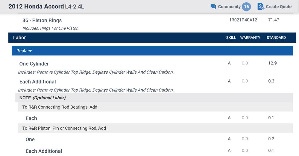

I've sent many customers to the dealer with that TSB in hand. Dunno how many got their rings replaced or not. :silly: The ones that didn't get recall coverage just ate plugs/oil for the rest of their life.
I sure as hell wouldn't do piston rings for 6.2 hrs. :lol: Cylinder head labor in Mitchell is 11.0 hrs by itself. Oil pan is 2.3 hrs. Add some time for the pistons and rings, and you're closer to 15.0 hrs.
