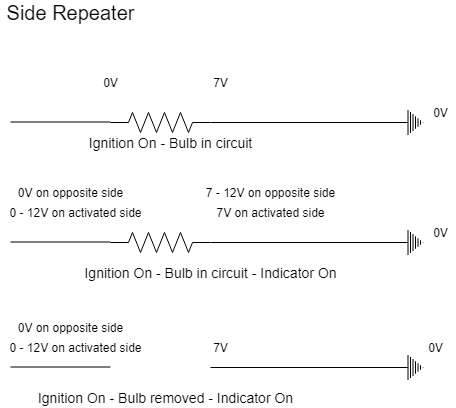

5 years 3 months ago - 5 years 3 months ago #49890 by The Toecutter
Replied by The Toecutter on topic Help with short and/or bad earth.
I'm getting the voltage without load or supply being present as well though. For instance on the side repeaters:
With ignition on, both side repeaters have a dim glow.
With left hand indicator on, the left side repeater pulses with a dim glow, the right side repater flashes brightly
With the right hand indicator on, the right hand side repeater pulses with a dim glow, the left side flashes brightly.
Voltages measured as below.
Last edit: 5 years 3 months ago by The Toecutter.
5 years 3 months ago - 5 years 3 months ago #49893 by jreardon
Replied by jreardon on topic Help with short and/or bad earth.
When the source voltage is switched off and the bulb is still there, other circuits tied to that bad ground will find an alternate path to ground through the bulb. It's a back feed as a consequence of a bad ground.
When you have the ignition on, there's a circuit wanting to use that ground, but it can't so if finds another path to ground. Instead of the current going down the bulb, it's going the other way, maybe through another bulb, then finding a ground. That would be why both side repeaters glow dim when you turn on ignition.
Last edit: 5 years 3 months ago by jreardon.
