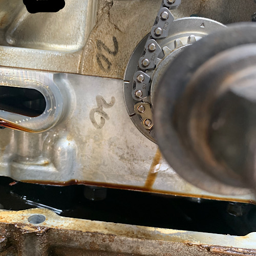

i really need urgent help, I am new into scope and can’t really understand how this scope thing work, I have a problem with this Honda 2014 civic , 1.8 litre engine, this car has what I called the dreaded P1129 ( map sensor) , owner had the map changed but still problem persist,
car came and I check the 5 volts and the ground current, all are present, the signal line is also good,
but I don’t know how to use the scope to point where exactly the issue or leakage is, I have checked the timing and the chain and the adjuster everything is fine… attach is picture of the timing

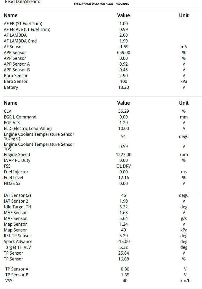

i have also attached freeze frame data for the error code..
thanks

4 years 10 months ago #49804 by Matt T
Replied by Matt T on topic 2014 Honda Civic - with error code P1129
Looks like it set on decel at fairly low RPM. How do your MAF,, MAP, and fuel trims look at idle?

The "Idle Target" is 720 RPM, but does that match the idle RPM?
Does your idle vacuum change if you complete the Idle Relearn? My thinking behind that is maybe the map voltage is too high after decel because the throttle plate won't close enough to make enough vacuum.
The MAF is reporting around 3 gram per second on this 1.8L engine and fuel trims are almost perfect so I'm assuming this air weight is correct at idle.
Your idle vacuum is around 17 inHg, which I think is borderline okay. Borderline. Is it okay for the PCM? I don't know but I think it could be a little better. Could this be because the Idle Learn is not complete?
At wide open throttle, does your MAP sensor (kPa) equal your BARO reading (I saw 100kPa for BARO in the freeze frame)?
How high does Calculated Load get when you go wide open throttle in park?
I believe Honda calls the Calculated Load PID "CLV" according this this site:
alexey-bass.github.io/honda-hds-help/Civic-2013/PGM-FI.html
Are there any drivability issues?
