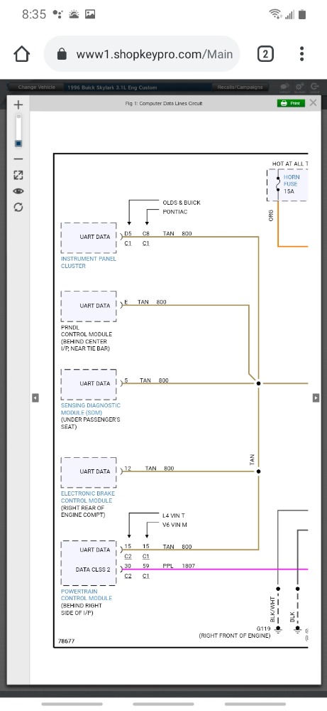

Replied by Noah on topic "SERIAL DATA " need info... 1996 Buick Skylark
I took a guess and figured you have a v6 4dr? It probably doesn't matter, but the diagram I saw of the cluster shows a tan wire labeled UART.
That's your data com line that transmits data (ie oil pressure, temperature, rpm) from the engine computer to the cluster. Vehicle speed is sent on it's own dedicated circuit.
It looks like there's only 5 modules hooked into the UART circuit:
Yout can disconnect then one at a time to see if the problem goes away.

5 years 3 months ago #49825
by Matt T
Replied by Matt T on topic "SERIAL DATA " need info... 1996 Buick Skylark
The vehicle has two networks. UART which appears to be your problem on the tan wire. Class 2 which is the purple wire at the bottom of the diagram Noah posted. That is probably the one your code readers are using to communicate with the PCM. So the fact you can pull P codes doesn't really tell you anything about the state of the UART. And both of the codes you did pull point toward a problem with the UART......
Regards no module under the passenger seat does the vehicle have airbags? They might've been optional on a '96??
I've attached an article that goes into detail about how these older GM networks function.

4 years 3 months ago #56869
by GuitarGuy123456
Replied by GuitarGuy123456 on topic VICTORY ! ! 1996 Buick Skylark ...
First, Many thanks for the responses I got in the search for answers concerning our Buick..
Second, glad for the forum as there is so much to learn..
Third.. Learning to NOT be a parts changer.. !!
So...
The plot to the electronic project thickened when the lower intake manifold gasket went from a weepy leak to a full on blown gasket..
This was now a make or break moment.. Dash completely apart, electronic problems and now a blown lower intake manifold gasket..
I thought fix the gasket,,, I might get a better price if it at least ran if I could actually get it started to sell it..
That repair turned out to be a very good distraction from the electronics problem as "THAT" I can easily fix.. plus I now had a good reason to uncover my Safety Kleen basin/tank..( I love the smell of that stuff).. Anyway,
I cleaned all the parts and reassembled that GM 3.0.. All went wonderful and after a dozen tries , the car started and ran as it did before..
Now back to the electronic problem,,
I visited a local shop here in Fayetteville NC. (Bills Auto Electric). They instructed me on EXACTLY where to find the AIR BAG module. It is under the passenger seat, under the carpet.. I removed the seat and cut a 3 sided door in the carpet to reveal the module. With battery disconnected, I unplugged the very corroded module. Remade all the miscellaneous wires that hung randomly from the column. Reconnected battery,, and gave it a try. Started immediately. The dash lights that were ALL on prior... went out.. except for the Air Bag light which made sense.
Repeated starts were perfect. Gauges all working properly, check engine light out.. ..
Was able to source an air bag module from a junk yard in Kentucky, and it was a perfect match...
So, the Buick that was 1/2 a step from the "FOR SALE" sign is back on the road!
THE BOTTOM LINE IS,
The serial data line was corrupted by the corroded air bag module. With it out of the circuit, the remaining modules communicated properly.
Seems if you can remove each module to identify the offending module without hurting anything.. Lesson learned, also if someone says the module is under the seat, and you don't see it, look under the carpet!!
