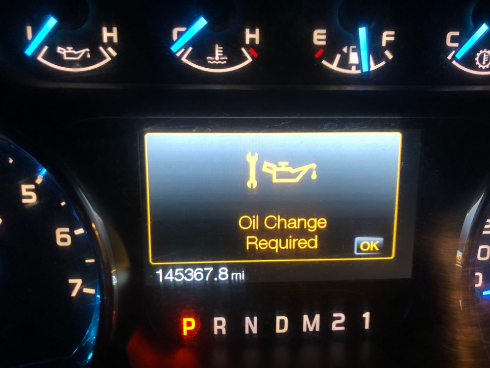

So this is an interesting one... my friend (who live in another state) has this truck... The other week the change oil indicator came on the dash, he changed the oil and went about his way, but when he went to reset the light it was stuck on. By that I mean, when you turn the key on the truck says: oil change required, and then if you press the "OK" button the message should go away and you can see the screen again, but no matter what you do pressing the OK button does nothing. He went ahead and put a new switch pack in, and this did nothing. All the other buttons on that side work (cruse, radio, etc...) but the OK button seems to do nothing. Someone suggested that it might be a clock spring, but my understanding of the wiring diagram, was that all the buttons use the same two wires, each button just has a different resistance to tell the computer what you are doing, is this correct? He has tried disconnecting the battery, touching the cables together, resetting KAM, and unplugging the display... nothing has worked. Thoughts, or a reliable mechanic around Greenville, TN?

Has your friend gone into the settings menu to reset the oil life? I forget the exact path, but it's in there.
That's the source of the oil change message.
If they can't navigate through the menu because the OK button doesn't work, then that's a different discussion.

Yeah he can’t get to the menu because the ok button isn’t working. All the other buttons work and he had replaced the switch pack that has the ok button

That's the "change oil NOW!!" message that comes on after ignoring "change oil soon". So it might be impossible to clear it without a scan tool. Maybe ask your friend if the OK button quit working when the message changed??

Interesting… I do believe they occurred at the same time which seemed coincidental but stranger things have happened! He was up by me last weekend and there was no way for me to clear it with my 525x. Ford OE software maybe?

Just had a look at the OE diagram. Appears that the message center controls have their own two wires that go to the up/down/left/right/OK buttons, and no where else. Switch pack -> clockspring -> instrument cluster.
If your 525X can talk to the cluster, you could see if there are input PIDs for the buttons themselves. Or, go to the clockspring and take a couple voltage readings at the connector on the column side. See if they match what's on the steering wheel side.

Ok thanks. I looked for the data PIDS and could not find anything besides the cruise buttons. I'm not sure how much electrical testing he want to do so he may just take it to a shop, or just roll the dice and put a clock spring in
