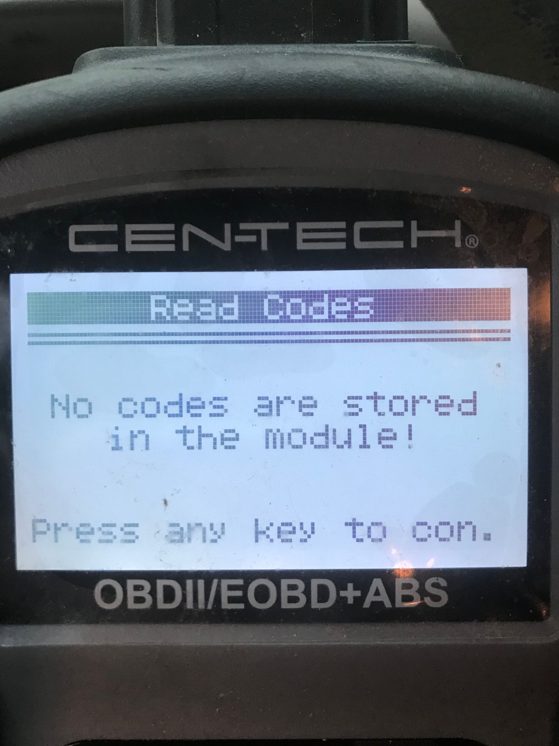

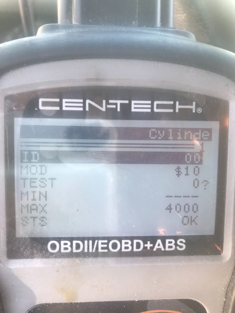

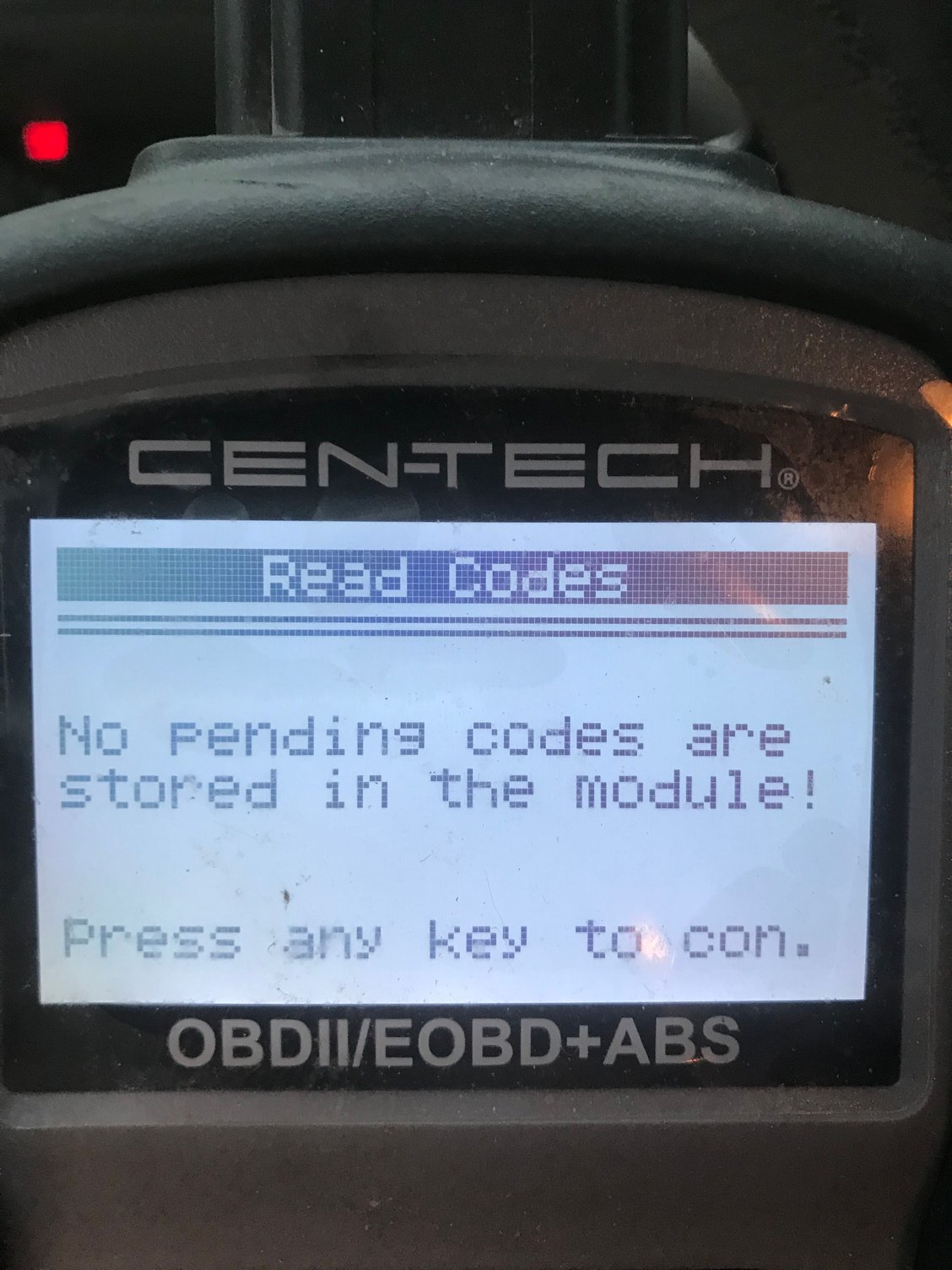

Introduction: I was originally looking for an OBDII forum and this site came up. I am chasing gremlins and looking to see anyone here can help, unless there is a specific forum or scanner diagnosis forum I should go to. Sorry in advance for the long explanation.
Subject: 1999 Ford 5.4L 2V NO CODES!!! Maybe I should just wait until it triggers a code. I just want to keep ahead of it if I can. I can not afford surprise repairs.

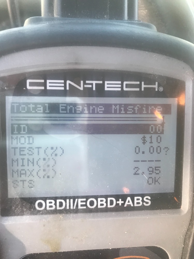

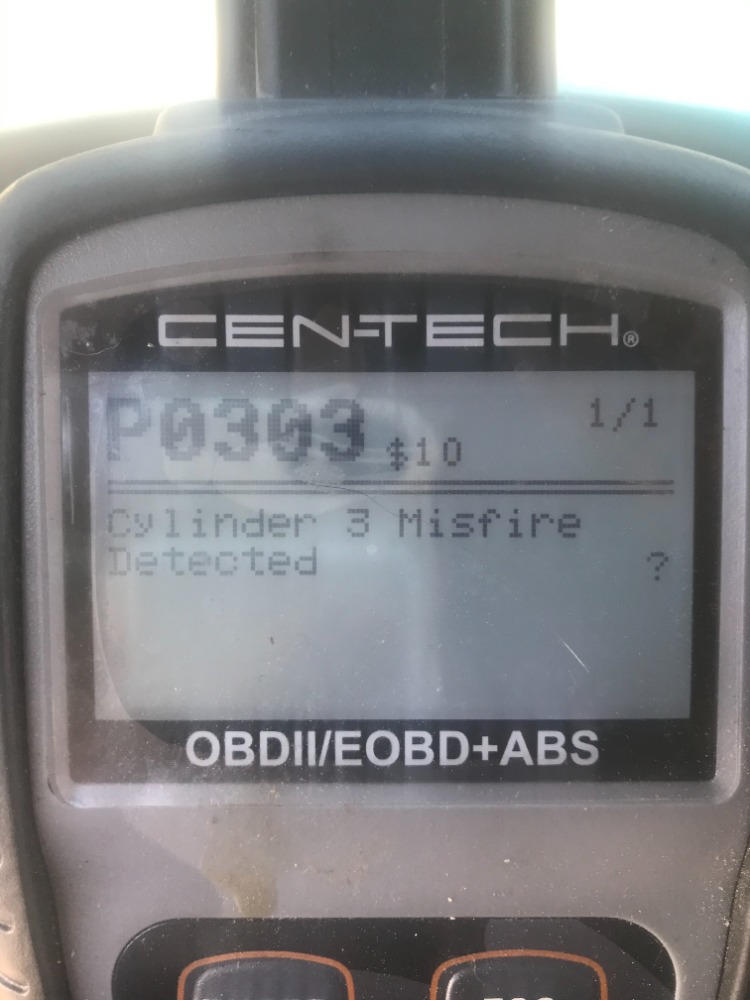

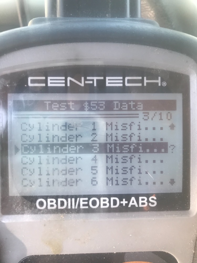

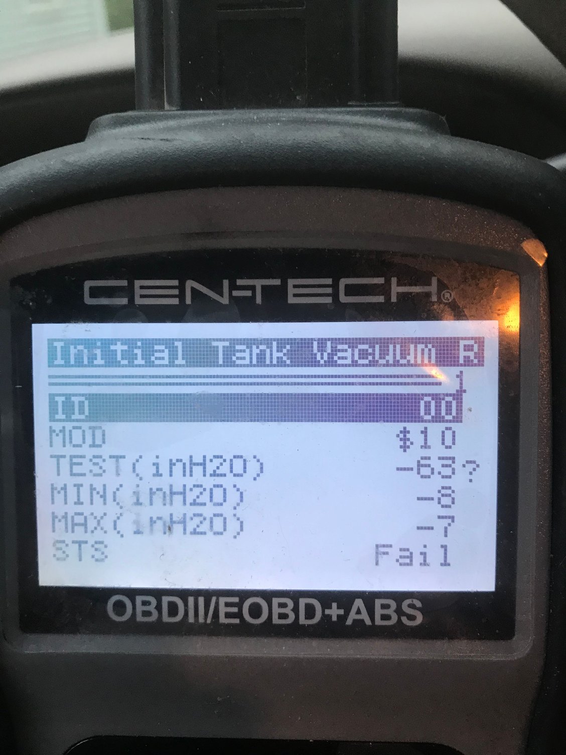

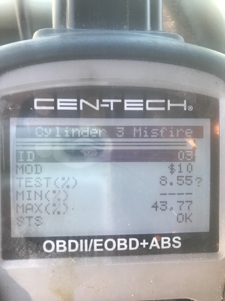

Current Condition:
Intermittent rough idles, while engine idles RPM would drop and slowing increase as I guess the PCM make adjustments. While under acceleration I'm pretty sure I feel something I think is a miss. Once in a while, while stopped and at idle it feels like a transmission downshift and then followed by a rough idle. While cruising I feel a vibration (which I think might be me misinterpreting as a miss). I believe it may be bad rear axle bearing(s) or tire(s) looking into that soon. I'm getting worse mileage now under 10 mpg in the city 10 plus on the highway according to onboard computer.
Previous Conditions
At Idle and acceleration to 60 - 65 mph both SHRTFTB1S1 and SHRTFTB2S1 show fluctuating readings, SHRTFTB1S2 shows zero continuously, and SHRTFTB2S2 stays fixed at 99.2. These were this prior to exhaust repairs.
The LONGFTB1 and LONGFTB2 both read 0.00 and rarely change.
O2 readings are all under 0.80
Rough start on the morning of 5/17/21
Recorded Fuel Trims that morning not sure if this is the correct way to do this.
I got 315 freeze frames in a 20 minute ride.
The Shorts got no lower than 20 and no higher than 26.9
The Longs never changed once and stayed at 00.0 the entire time.
Let me know if I did this wrong or if it was not even necessary.

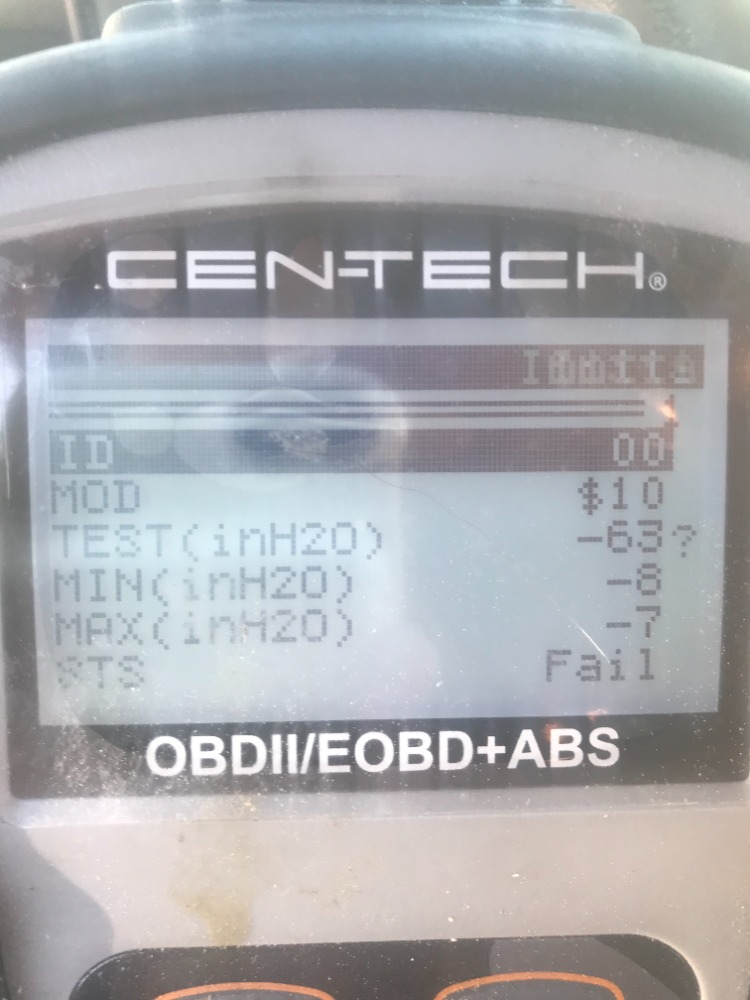

Maybe I need a smoke machine? Any suggestions without the use of and air compressor? Maybe a DYI? I see Amazon has a few AUTOOL units for sale with built in air. I question the pressure on their SDT 106 unit. It has an output of 9-11 psi. I thought I read somewhere that an EVAP test should not exceed 1 psi. I questioned the seller and they replied with "9-11psi is the pressure range that the automobile pipeline can bear. If the pressure is too small, the leakage detection will not be carried out. I hope it will help you." Does this make sense?
Any help is much appreciated. Thanks in advance.

4 years 10 months ago #49238
Replied by Tyler on topic Chasing Gremlins? Failed Scanner reading with no CEL/IM Readiness Incomplete
Hey JuanRiveras! Welcome to the forum.
There's quite a bit of info in your post, so let me answer where and how I can.
Part of the problem is the SHRTFTB1S1/B1S2/B2S1/B2S2 PIDs. They're junk.
:lol: Rather, they're very misleading. Any fuel trim PID you see with 'BxSx' attached to it is not your true fuel trims. The numbers you want are gonna look like STFTB1/2 %.
Speaking of, let's retake your fuel trim readings. Shorts + longs at idle, 1500 and 2500 in Park with loads off. I know the longs are stuck at zero, check them anyway.
Let's leave the catalyst monitor alone for now? Until we get a better idea of fuel trims.

Thanks for the welcome.

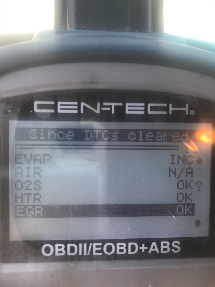

CAT is now complete this morning, EVAP still Incomplete.
Ran all three from a cold start have not driven the truck since late Saturday afternoon. Start up was rough see readings below. Idle got rough to a near stall and then recovered.

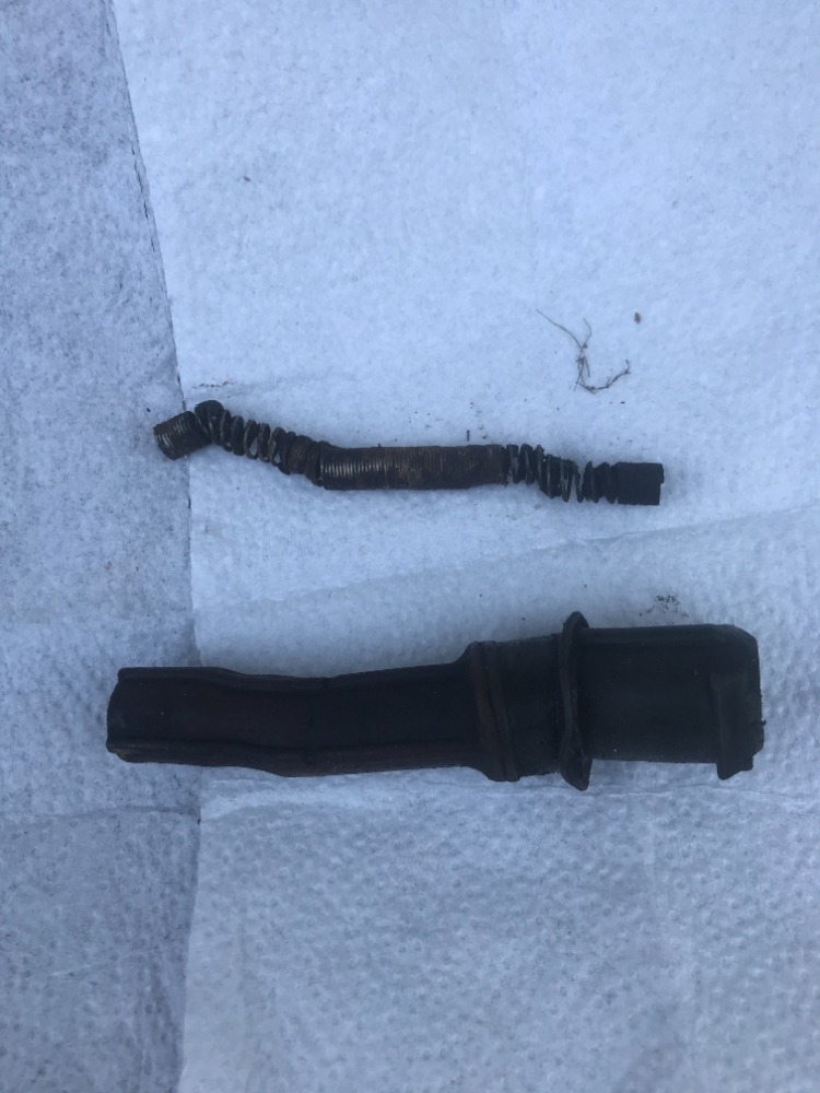

EVAP Incomplete
Initial Tank Vacuum
Total Engine Misfires
Cylinder #3 Misfire Data
Cylinder Events (not started today)
Pulled COP #1 looks almost new after 5.5 years. Cleaned the outside and figured I'd pulled it apart, inspect, clean the contact, then greased it and put back together to in #3s spot..
Pulled #3 wow....
I remember this COP pack and plug working their way loose a few years back, The plug went back in and torqued to spec without any issue, and the pack went back on as well. Don't remember it looking like that though. I would have changed the boot it's not like I don't more than one complete set laying around. LOL, I have a complete intake system in my basement plenum to carb less some Boots, Springs, and graphite rods now.
Repair/Replaced: Boot, Spring, and graphite rod all used Ford OEM and look new as well.
Before putting both COP packs back I checked to make both plugs did not loosen, both were tight and dry. Installed both of them, Cleared the codes. Ran all three trim readings again (stored on my scanner). Took it out for a long drive and did six 60/40 runs.
Hopefully I do not have wait ten months to find out the COP pack moved to #1 is bad, at least it is number one now. Now waiting again for everything to completed again.
Still have Initial Tank Vacuum failure.

I think the COP Boot caught the top of the plug and got bound up and bent. I surprised it never through a code earlier not being seated 100%.
Truck seems to be running better,
