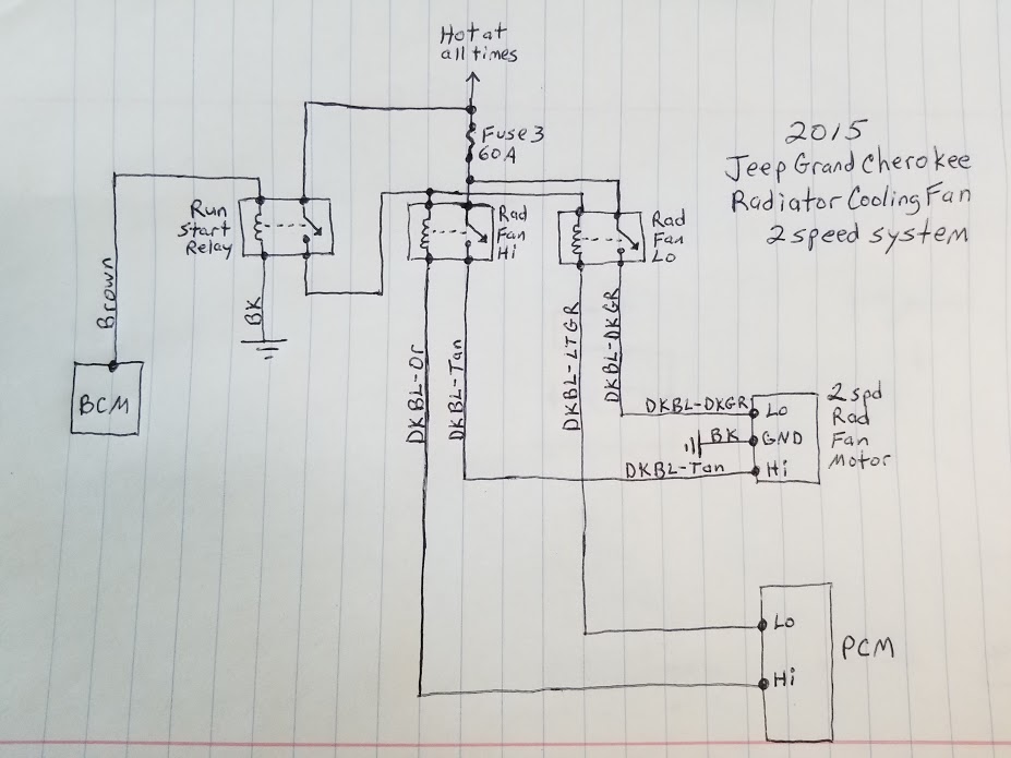

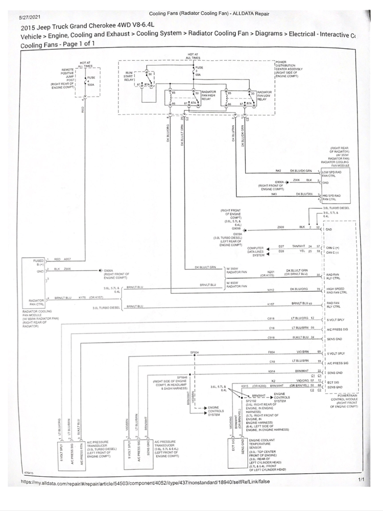

I'd start with load testing the two large cables at the fan connector. Use a headlight or other similar heavy load. One wire to red, the other to black. Does the bulb light brightly? If yes, I'd consider those circuits good. If not, find out if the power or ground is missing.

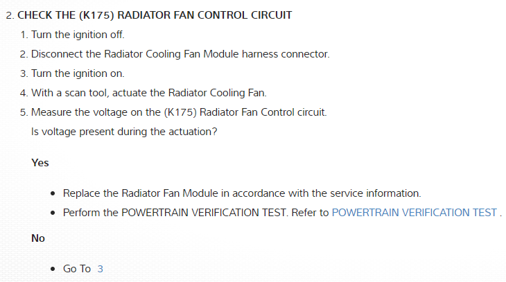

The small wire is a PWM signal from the PCM directly based on commanded fan speed. I found this step in the P0480 flow chart. See attached.
Check for voltage on the small wire as directed. I don't know what you're going to see? :silly: But the flow chart seems to be happy with just about any. Let us know what you find and we'll go further.

What voltage do you have at the computer? Connector C1, pin 30.
If you have higher voltage at the computer, but only 40mV at the fan connector, then you have a wire problem. It could be a broken wire or high resistance somewhere along the wire.
If you have 40 mV at the computer then check for a short to ground. Unplug the computer and unplug the fan to isolate this wire and check for continuity to battery negative. The only good reading is OL.

I'm sorry Jeffrey, I'm still not clear. Does one of the big wires light a test light connected to B-? Does the other big wire light a test light connected to B+? If so, we'll consider those circuits good enough for now.
The small wire will only show voltage during commanded fan activation, per the flow chart. The PCM may be doing some kind of circuit check, as you noted, and shutting the circuit off in response. Does your scan tool have bidirectional capability?
