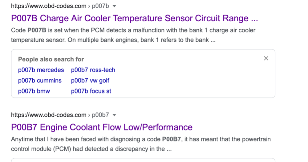

- Desmond6004
5 years 5 months ago #49128
by Desmond6004
Replied by Desmond6004 on topic Audi A4 1.8T 2014 CJE engine code
The following user(s) said Thank You: Pieter
- Pieter
- Posts: 17
- Thank you received: 3
5 years 5 months ago #49131
by Pieter
Replied by Pieter on topic Audi A4 1.8T 2014 CJE engine code
Got it wrong way around thanks for pointing it out. Will edit it.
