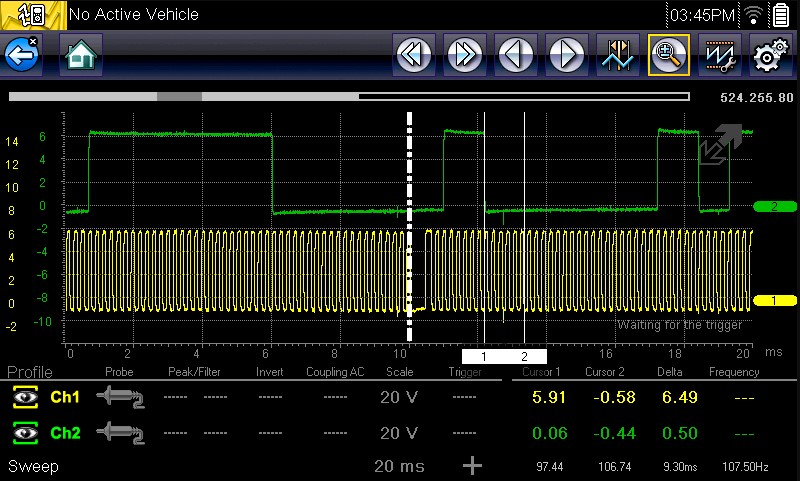

Need a known good cam crank relationship 2007 avalanche lc9 vin 3
  • Cheryl
  • Cheryl's Avatar Topic Author
5 years 5 months ago #49025 by Cheryl
Looking for a known good waveform couldn’t find one on iatn or anything. To see if cam timing is off I only have 11 inches of vacuum where vacuum port on intake feeds purge valve
5 years 5 months ago #49053 by Tyler
Couldn't find one for an '07, but this is from an '09 Suburban. Didn't list the VIN or RPO. :(
members.iatn.net/file/view/?id=87247&detailed=1
