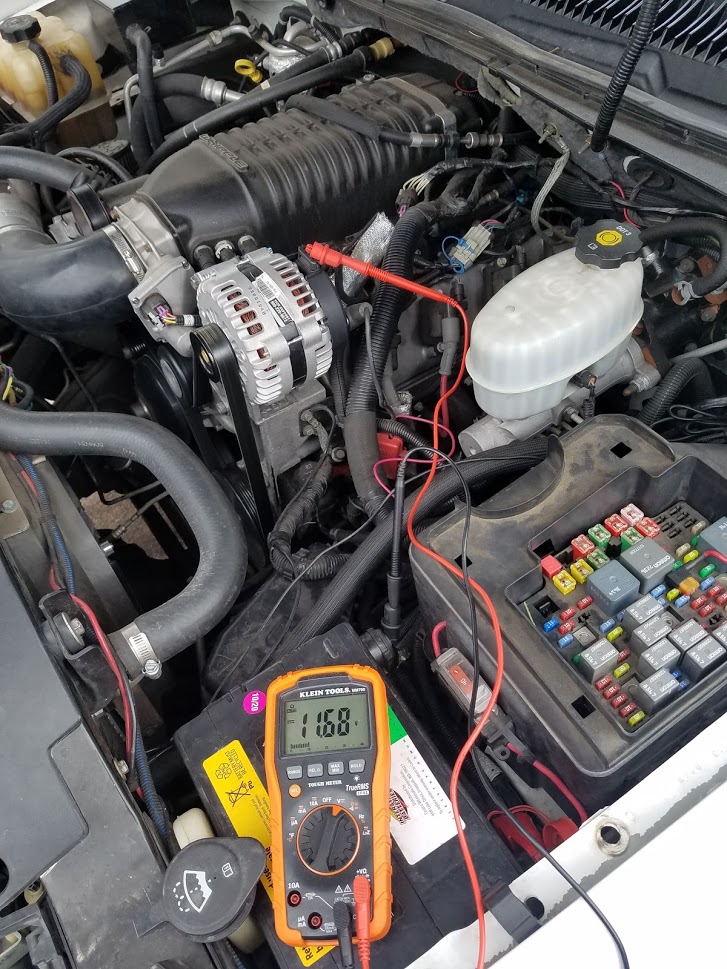

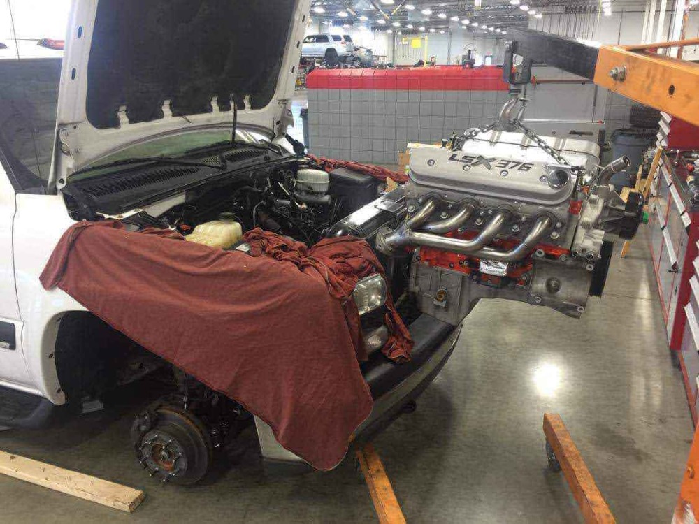

Here we go!
In July of 2020 I bought an 03 Suburban 2500 Quadrasteer with a swapped in GM LSX 376 B8 (58X reluctor) and a 2.9 Whipple supercharger. There is a lingenfelter module to adapt the reluctor signal to the 24X the ECM is looking for. We drove it from Reno, NV to Duluth, MN with no problems. It's been a fun rig for my wife to haul our 3 kids in. We were rear ended in December of 2020 in a Blizzard. Burb held up great (Car that hit us was totalled) and we decided to fix it. Got the frame straightened out and reinforcements welded in. Drove it for a few weeks with no issues. I replaced the damage reverse camera one Saturday and shortly after that started experiencing stalling while driving. I did not unplug the battery but its connects to the fused radio. I did try to activate the camera without ground connected but I'm not sure if that would do anything. connected ground and good to go. Sometimes it starts right back up after coasting off the road, Sometimes It will crank but not start. It will usually re-start if jumped or if you wait a while. Worst part - NO CODES or CEL.
Brought it to a shop and it never died for them, figures. $50 down the drain.
Suspected the charging system so I threw in a new alternator, no improvement. Had the battery (new in October 2020) tested at Advance auto and tested good. checked the wiring with ohmeter and alternator to battery and battery to ground beeped. looked for broken grounds and nothing seemed loose and I had continuity. Changed the crank position sensor because I had one handy.
Then, in desperation, I found ScannerDanner on Youtube, Started backprobing the alternator and I wasn't sure my readings were making sense. I'll add them here later. Feeling a little overwhelmed by all the "possible" issues I'm finding wwith no clear direction.
I do have VCM suit from HP tuners and the only thing that seemed off at idle were negative fuel trims. I did also see a tone of engine codes were disabled. I may try to re-enable the codes to give me some more direction.
Cleaned the MAP sensor near the airbox, and am going to clean the throttle body next. After that I'm gong to pull my plugs and check gaps.
I have a scanner on the way and picked up Pauls book.
I did find that the SBA supplemental Brake Assist) fuse was blown. Not sure if this is related to my issue or if braking while coasting off the road caused this. I changed the fuse and no improvement. Fuse has not re-blown.
Have not checked fuel pressure yet, but I have no reason to suspect it. Power was good, also fuel level is good per guage. I'd also filled it up recently enough to trust the guage.
Seems like if you keep the RPM's high it will stumble and come back instead of stalling. Drove it home in 2nd gear too keep them up after it died on my 3 times in a mile or so.
Burb is parked in the driveway right now and tried to start it yeasterday with good crank no start at all. Could be that battery voltage is below some threshold? Seems weird to me that it will usually start if jumped but it cranks fine when not jumped. I did not jump it yesterday. Hoping the tool gets here and I can see the issue.
I'm going to be the wiser for fixing this thing, but getting my tail whipped right now. Looking forward to no longer being a parts changer.
-Brady

I,ve had some issues with broken/ missing body and frame ground straps on chevys causing no start and when jump starting them you would get enough current to flow through whatever fasteners was still making the connection.( the fuel pump could run but would'nt be able to make enough pressure to start the vehicle) it may be worth doing voltage drop test on the body and frame while it is doing its crank no start. if you dont have a DVOM you could also do a quick and dirty test by connecting a jumper cable from batter ground to the frame and again to brake master cylinder and see if it starts
5 years 5 months ago #48656 by Ben
also I just seen the pictures and your voltage is 11.76??? I cant make out what wire is being tested if that is battery voltage that very well could go to low during cranking for the pcm to operate.

I'll post up the wiring diagram this evening with respective tested voltage. Battery tested 12.6 across the posts if I recall.

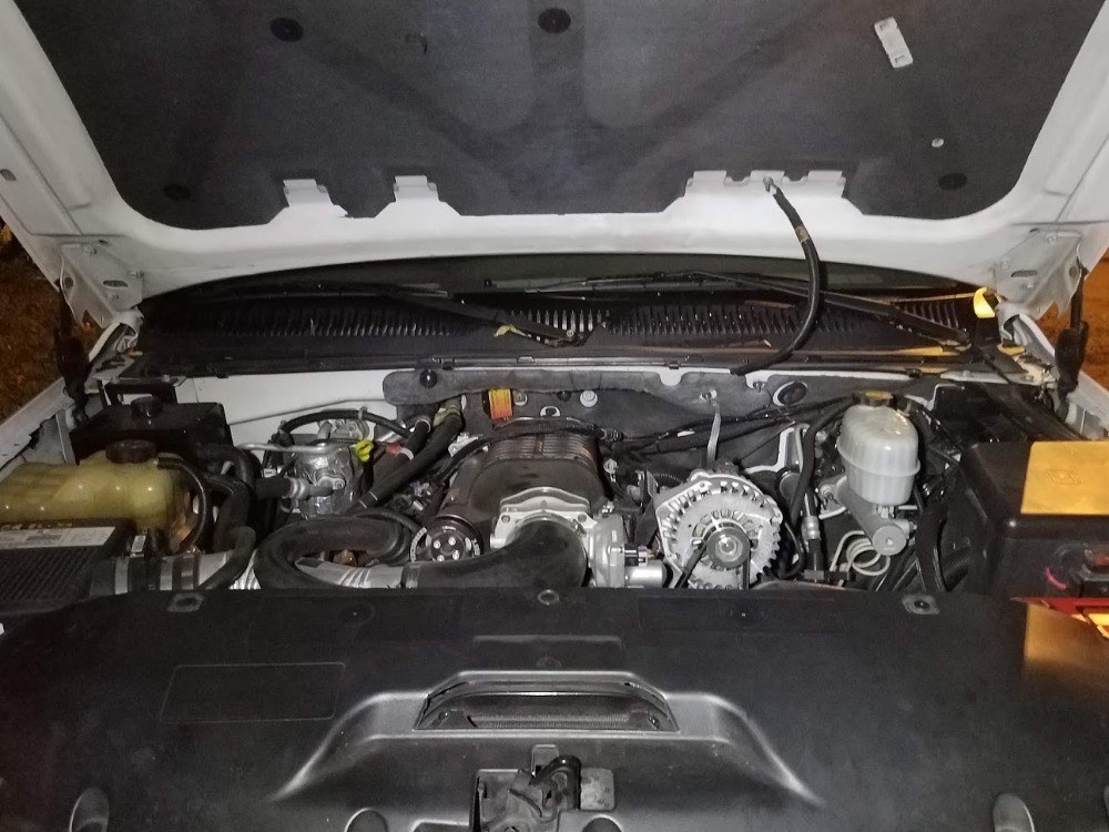

Got out with the scan tool last night and made the following notes:
1. There is no fuel pressure port on my Whipple fuel rails. There is a bung for one, so I need to get something that fits in there.
2. Battery voltage was 11.5, threw on a jump pack and I was up to 13. Threw on the battery charger and this morning I had sulfuric acid on my work bench. looks like that was an issue though I'm not confident it is THE issue. we'll see once I can get to costo to warranty this one out.
3. No RPMs on crank, I suspect the wiring to the crank position sensor. or the TRG-002 module. Cranked great with the 13volts off the jump pack.
4. Disconnecting the radio did nothing for me.
5. Looked for the fuel pump ground strap and couldn't find it. Need to look when it's not cold and dark.
6. Cleaned the throttle body just because I wanted to feel like I was accomplishing something. checked the wiring and connections and no issues visible.
7. There's a module that goes bad in the windshield wiper system. I have anew one to swap in, may as well do that while I'm doing this.
Need to check the Viper security bypass module and see if it seems ok.
Last edit: 5 years 5 months ago by Bkorwin. Reason: forgot item

Got into the vehicle yesterday,
Found that my wiring loom going to the crank and cam sensor were both melted. Pulled the harnesses out and will be testing wire continuity to see if I found my issue. hoping after I get this back in I get my RPM signal back.
Also have the fitting I need to check fuel pressure. More updates to come.
