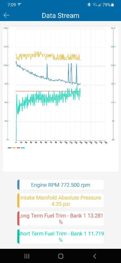

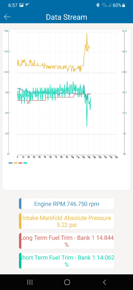

On Park or Netural, LTFT increases at idle and 1500 rpm but comes down on 2500rpm.
At idle, if you shift it to D4, then LTFT comes down too. Just Park and Neutral are issues.
Also possible at Idle on Park, if you turn on the AC, then it no longer maxes out.
You can see in the first photo below that LTFT ramps up on Park - then I moved it to D4 and it started coming down.
Also, if I introduce a vacuum leak by loosening the IAC valve botls, LTFT does not increase at idle. Pls see in the 2nd photo - there is spikes in rpm.

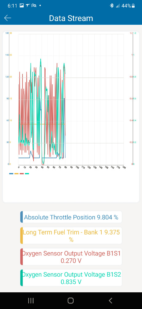

I also want to see oxygen sensor and TPS data with a snap throttle and a road test WOT with TPS. The oxygen sensors should both go rich.
You can always use a shopvac on the blower end and place it in the exhaust and spray the exhaust around the cat when it’s completely cool and look for bubbles.

One thing changed lately - LTFT had gone down from 11.7 to 9.375. So at idle & Park at 2500rpm, it still was climbing up to 11,7.
Secondly these were done when the coolant is at 172 and Closed Loop.

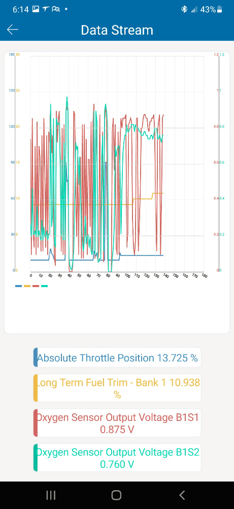

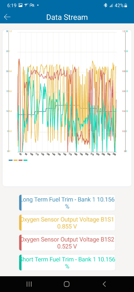

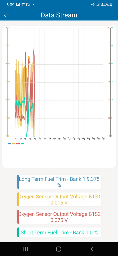

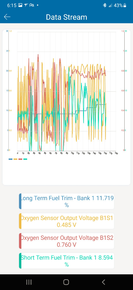

I did the WOT first - repeated it again. So WOT happened as below and photo below too:
35 - 40 1st WOT
75 - 80 2nd WOT
Then at 95, I did Park gear and 2500rpm:
Then I started driving and LTFT came down:
Should I perform the snap throttle at Park gear and engine is warm?
