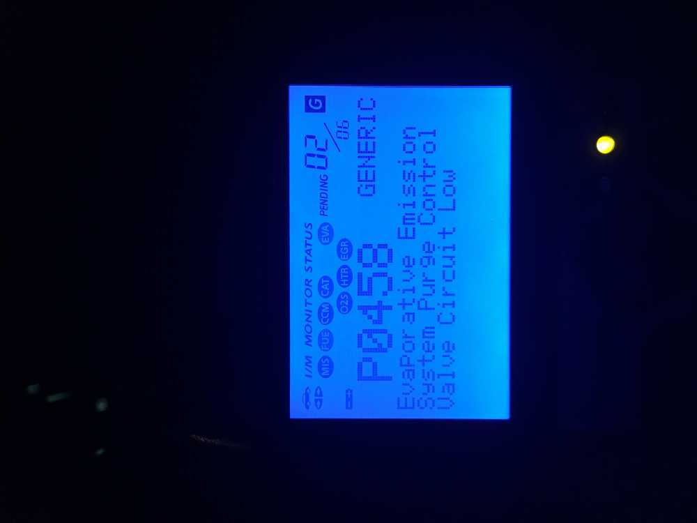

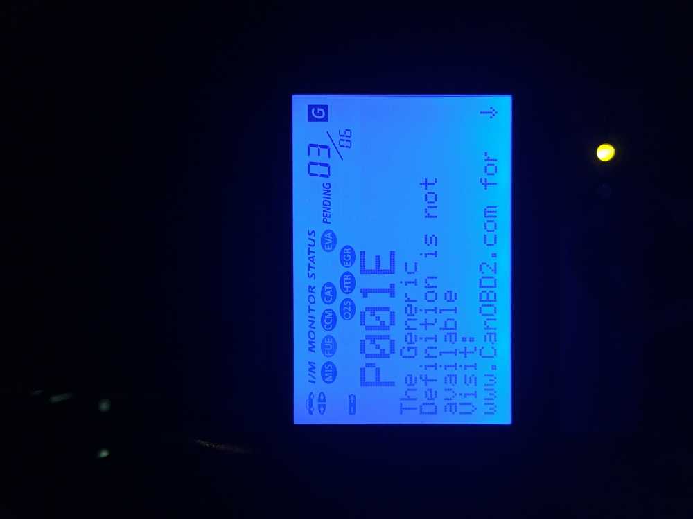

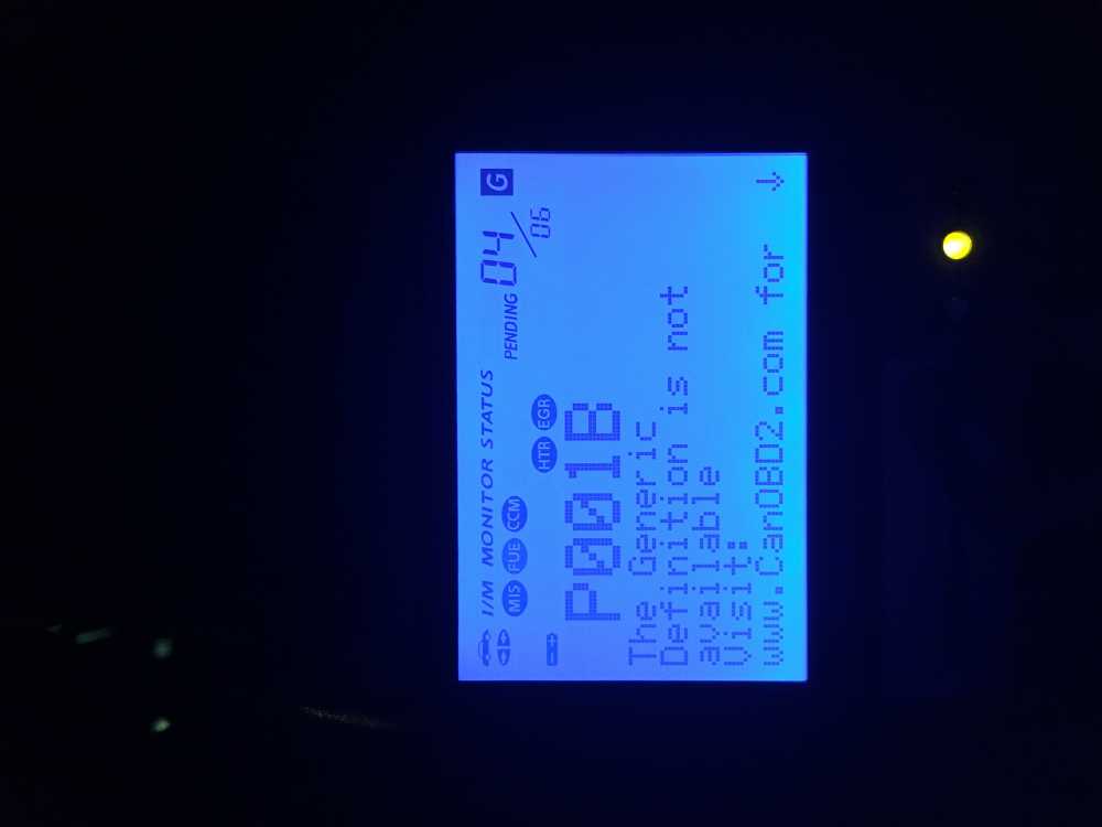

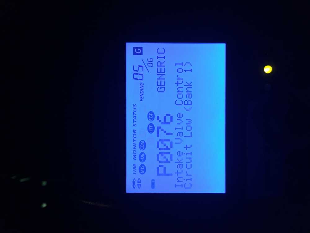

:blink: I don't know what else to do. I replaced cam reset solenoid"VVT", cleaned the two cam profile solenoid, replaced camshaft position sensor. And I still have p0012, p001E, p001B, p0076. It doesn't trigger the CEL but it's in my scanner, also drivability sucks, feels sluggish on high throttle, it won't pass 4K rpm up hil. I already flushed engine twice and put fresh oil and filter, replaced fuel filter too, spark plugs are 1 1/2 old. I changed the fuel cap too. Looks like I have a bad purge valve

The codes point to a short to ground on the vvc control circuit on bank A (Bank 1).
I would start by disconnecting the camshaft profile solenoids for each bank and measuring the resistance of each. You may find the solenoid on bank A has a low resistance in which case replace the solenoid. If that isn't the case the next stage is to check out the wiring harness for damage between the solenoid and the engine computer. If a visual inspection shows no damage you may need to disconnect the harness at the computer and the vvc solenoids and check the ressistance between the control wire and ground.

At this stage everything seems to point to a short either in the wiring or PCM. Hopefully it is a simple wiring fault not a PCM fault such as water ingress.
Having a known good solenoid gives you a head start, identify the control wires on each and with the solenoids unplugged measure the resistance between the control wires and the cylinder block and also the control and ground return wires.
Then reconnect and disconnect at the PCM and do the same tests.
It may be as a last resort you have to go for more invasive tests such as cutting the control wire for bank A solenoid close to the PCM to test if the short to ground is in external wiring or internal to the PCM.

I was trying to navigate to my previous post. This issue has been resolved! I managed to get a schematic and diagnosed that I have a loose fuse "slot" 15amp fuse that powers both cam profile solenoids, Vvt solenoids, purge valve and leak detection. That explain I changed most parts and it would works and stop, this explain one day I have a CEL and sometimes not but scanner was able to pick it up. Anyways, I fixed the fuse holder tab, had a good contact now! Works like a champ.
