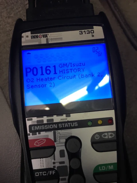

1996 Impala SS LT1 (Intake backfire) no check engine light
5 years 7 months ago - 10 months 2 days ago #47401 by D250
Last edit: 10 months 2 days ago by D250.
5 years 7 months ago #47402 by Cheryl

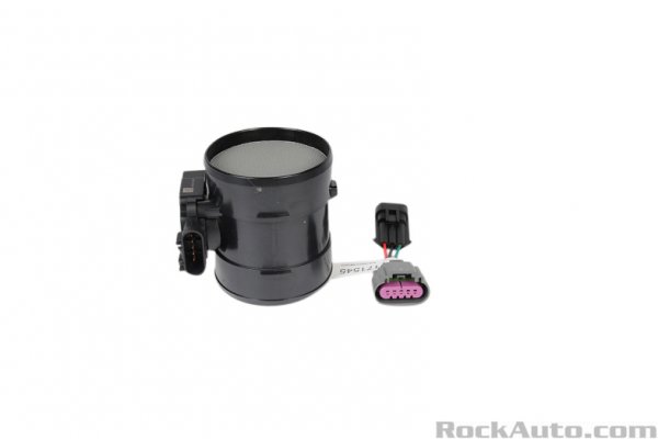

Popping through the intake is it going lean. How’s the mass air flow sensor look? The old gm you can clean them real easy pop out 4 screws take maf apart clean it. Bet it’s dirty from the j&l filter

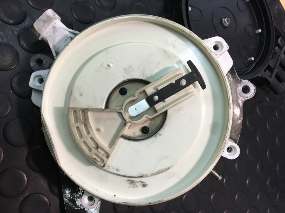

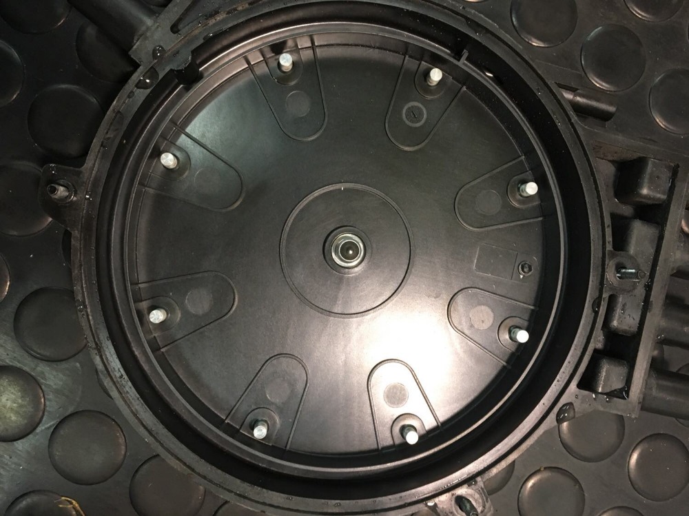

5 years 7 months ago #47413 by Hardtopdr2
Popping through intake would be distributor timing, valve adjustment/timing chain or valve spring issue
5 years 7 months ago - 10 months 2 days ago #47446 by D250
5 years 7 months ago #47451 by Hardtopdr2
just check distributor timing cause that bolt can come loose or the knock sensor wire can get under the distributor clamp if not being careful
5 years 7 months ago - 10 months 2 days ago #47477 by D250
5 years 6 months ago #48092 by Hardtopdr2
well i meant for you to check base timing of distributor advance or retardation of spark timing with timing light. sorry should have made that clear.
