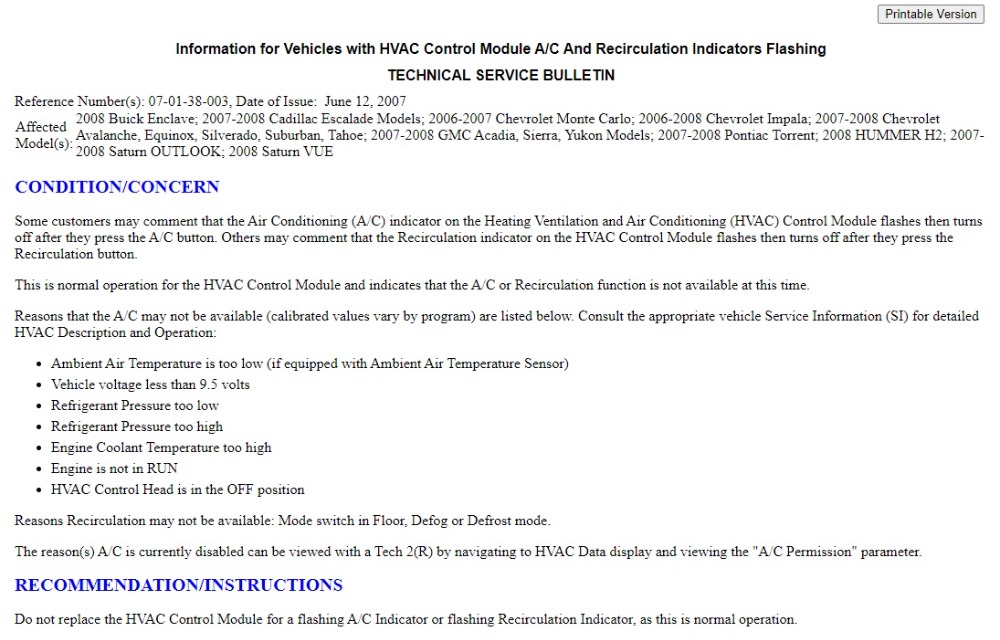

Check the A/C pressure sensor reading in the PCM. If it's near zero, that'd be why the light flashes. :lol: Find out where the refrigerant went.
You can also check the A/C Disable history in the PCM. Should store the last eight reasons it disabled the A/C.

I Found & attached a TSB on this issue.
