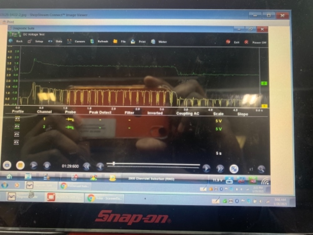

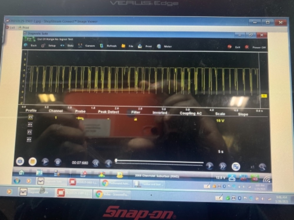

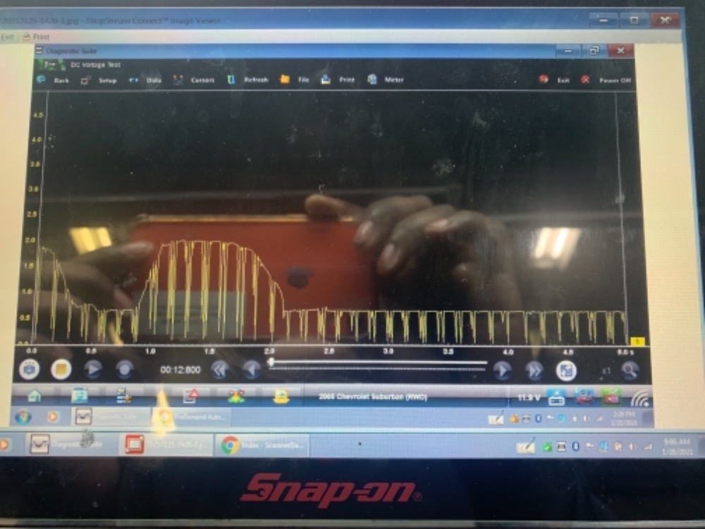

2005 Chevy suburban APP sensor 2 circuit
- DigorDiePerformance
- Posts: 12
5 years 9 months ago #46251
by DigorDiePerformance
2005 Chevy suburban APP sensor 2 circuit was created by DigorDiePerformance
2005 Chevy suburban APP sensor 2 and Throttle body Position Sensor 2 circuit have drop outs in 5v and sensor circuit. What's my next step?
- Cheryl
- Posts: 1216
- Thank you received: 215
5 years 9 months ago #46262
by Cheryl
Replied by Cheryl on topic 2005 Chevy suburban APP sensor 2 circuit
Does the code come back as soon as it’s cleared? Or take a few days
- Posts: 6146
5 years 9 months ago #46268
Replied by Tyler on topic 2005 Chevy suburban APP sensor 2 circuit
Pretty sure those dropouts are normal. Part of the PCM's diagnostic strategy to detect if APP1 and APP2 (Or TPS 1 and TPS2) get shorted together.
What's the fault code? Like Cheryl asked, how long does it take to reset?
- Posts: 12
5 years 9 months ago #46290
Replied by DigorDiePerformance on topic 2005 Chevy suburban APP sensor 2 circuit
No, code is P1125
- Posts: 12
5 years 9 months ago #46291
After reset the code with a short drive p1125 shows passed in the DTC code status lookup.
- Posts: 12
5 years 9 months ago #46295
I think you're right about the dropouts being normal on the app/TPS sensor 2 side of the circuit. I.have 2007 Chevy 6.0l truck in the shop. Same dropouts on that circuit. For now im just clearing the code and shipping it since it passes.
- Posts: 6146
5 years 9 months ago #46296
I'm pretty sure P1125 is part of the constant component monitor? :huh: Which means it's always gonna show Passed, until it fails.
Has anyone tried a new APP yet?
DigorDiePerformance wrote: After reset the code with a short drive p1125 shows passed in the DTC code status lookup.
