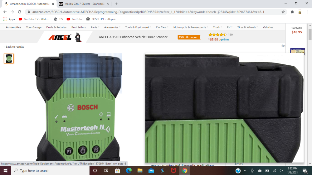

Whoa i have opened a can of worms with the wifey{scan tool pricing}. would love j2534 pass thru.
5 years 9 months ago #45632 by Hardtopdr2
Replied by Hardtopdr2 on topic Malibu Gen 7 Cluster
Gds2 will cover most vehicles newer than 2007 they are a bosch unit. The newest one is mastertech2 which says it can do ford, gm, mazda, Volvo etc. But depending on year model of gm you may need a tech2 with candi module (covers 1996 to some 2008 gm vehicles). Otherwise look for a brand specific one for what your using it for.
The following user(s) said Thank You: abbottjames712
  • abbottjames712
  • abbottjames712's Avatar Topic Author
5 years 9 months ago #45634 by abbottjames712
Replied by abbottjames712 on topic Malibu Gen 7 Cluster
would love this. #someday
