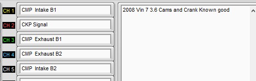

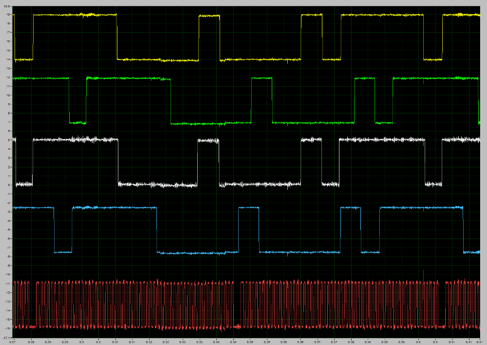

Hi im reaching out to get some help on a p0008 trouble code, I know there is a tsb regarding stretched timing chain(s). I was hoping someone had a known good cam to crank correlation waveform just to be 100% percent sure that the issue are the timing chains.
Thanks
Last edit: 5 years 10 months ago by Choche07.
5 years 10 months ago - 5 years 10 months ago #45155 by Chad
Replied by Chad on topic 2011 Camaro ls v6
3.6L
Intake cams line up. Exhaust cams are offset.
This folder contains files for Snap-on, Pico, and ATS
drive.google.com/drive/folders/1Nf45q4n-...DCLjlRsr?usp=sharing
