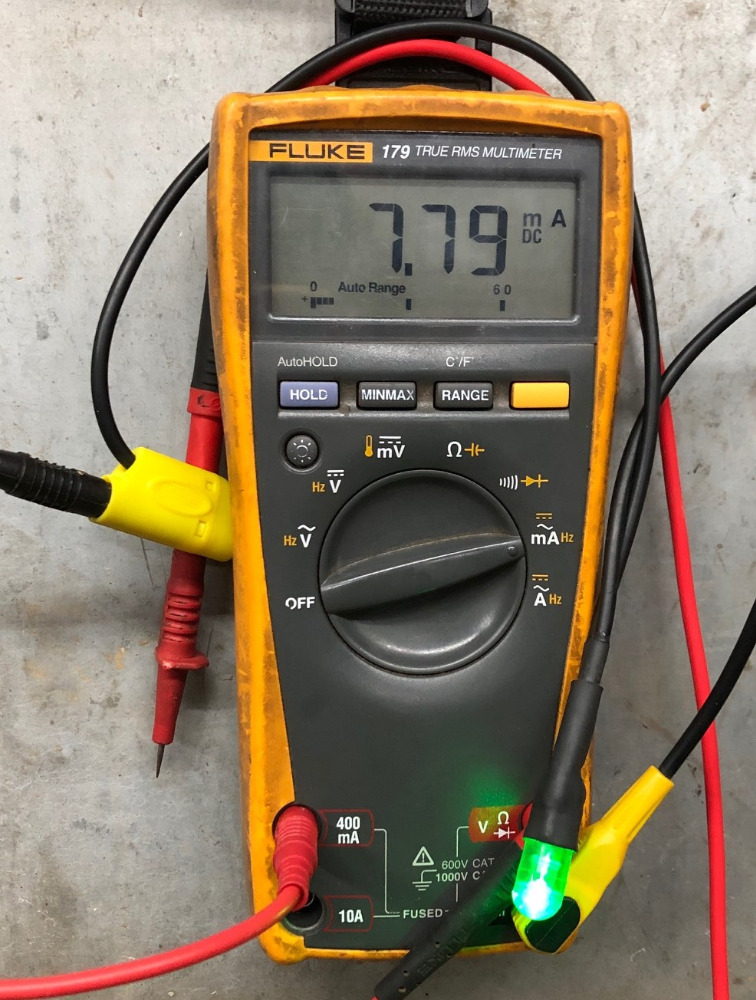

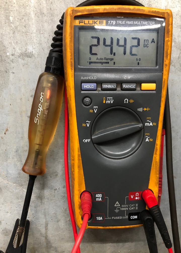

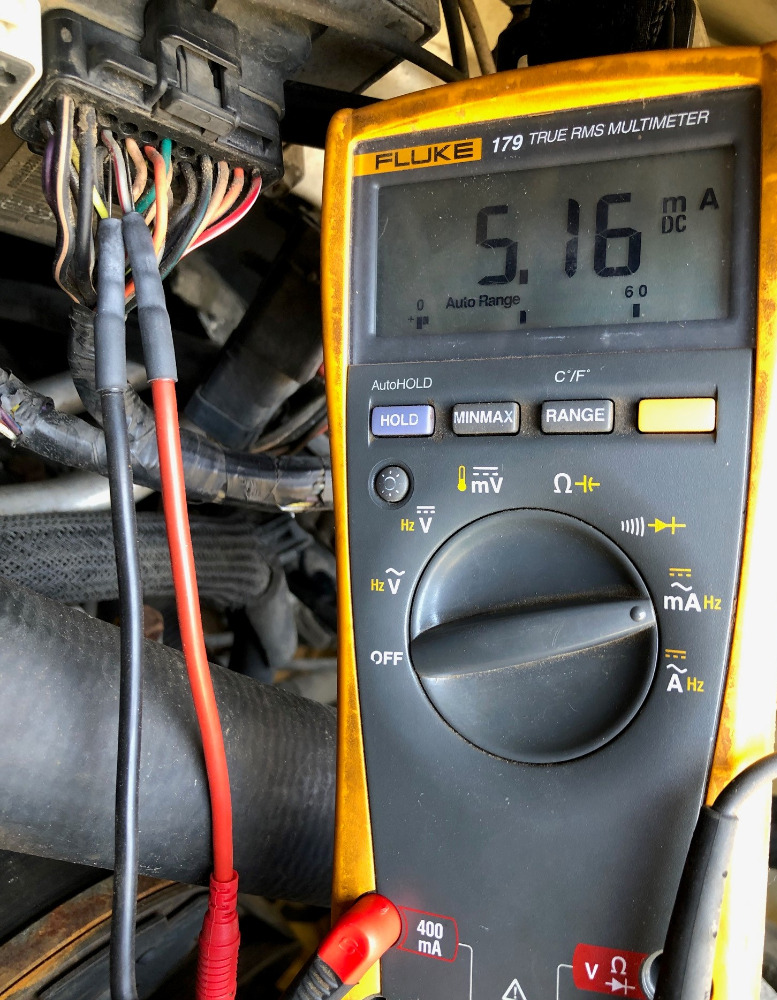

The signal wire you can easily drop, since it's a real low current voltage. It's especially about the 5v. circuit, to confirm it's an ECU issue, dropping the 5v. or it's a sensor doing it. With more then one sensor on a line it's quite easy to check, disconnecting different sensors... this specific one I referred to had only 1 sensor on it, so it's a bit harder to condem one or the other.
In your tests it's clear it's taking several miliamps (the green led one is only 7.79ma). That should never take the 5v. down, unless indeed there is an issue. An other idea I had is taking 'a' sensor and put short leads with pins on it so you can plug it in any circuit to test. Ultimate question is still, with how many (mili)amps on average is a sensor putting the strain on a circuit
So how does it compare to a test light (led or bulb)
