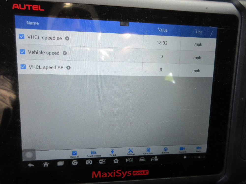

5 years 11 months ago #44630 by atikovi
Recently bought car with the following codes P0500 P1720 P1715 P1574 all relating to speed sensors in the transmission, not ABS. Brought up live data on my scanner and one reading shows 18 mph at any speed below 18 mph, even when stopped. Can this possibly be right?
5 years 11 months ago - 5 years 11 months ago #44631 by Matt T
Those codes all appear to be related to a mismatch between the "regular" VSS signal, from the TCM over CAN, and another generated by the ABS module and transmitted to the ECM via the cluster over CAN. I'd scan the entire vehicle to see if there are any related looking, or U, codes. If that doesn't turn anything up then start looking at PIDs in the ABS and TCM modules.

5 years 11 months ago - 5 years 11 months ago #44636 by Tutti57
There is definitely one that reads something like that at a standstill. I've seen it before and again recently on a 2018 sentra. I questioned it and saw in the manual it said approximate vehicle speed was the expected value. Our main cvt guy said he's seen it and thinks it's normal, but there's obviously something going on with those codes.
I've got a '14 versa I can check on, not sure if it's the same transmission though, about that one not reading 0mph.
Common wire issues with those are seen after a replacement having to do with that round one not being plugged in all the way. it twists and is weird. There is a special tool for it (that I've never seen be used) but I just put channel locks on it and make sure it's seated. Also there is a sensor on the back and one on the side that easily gets busted off or broken if you're not careful.

  • atikovi
  • atikovi's Avatar Topic Author
5 years 11 months ago #44637 by atikovi
The problem occurred when I was driving the car for the first time after putting in a transmission from a parts car. Drove 30 miles on the highway and it drove great. On the drive back I had the cruise on at 55 mph when it disengaged by itself. Then the CRUISE light was flashing. A few minutes later if felt like someone slammed the shifter into low as the rpms went to like 6500. I pulled over and shut it off. Turned it on and it was back to normal. Got off the highway and a mile from home it went into a limp mode. Wouldn’t go over 1800 rpm even if I did a restart. Managed to make it home where I pulled the codes as shown. Erased them and car drives fine again but need to find the cause before it happens again. Should I keep driving while monitoring those 3 sensors outputs?

5 years 11 months ago #44765 by atikovi
Disconnected and reconnected two of the three accessible speed sensor connectors and have been driving it around town this weekend off and on. Drives great. Full scan shows no codes in any modules. The original issue only happened after driving an hour on the highway so I wasn't expecting anything anyway yet.
I did set the fluid level by the book, at the correct temperature and letting the fluid dribble out while running. Scan tool says the G sensor is calibrated and not sure about the relearns. Remember doing something like that with the scan tool but I'd think it would throw a code for that if there was a functional issue related to it.
Going to drive on the highway next and see what happens. What should I be monitoring?

5 years 9 months ago #45756 by atikovi
Just an update since my last post. When I changed the fluid I also removed the round external filter which I had replaced before putting the transmission in the car, just to check if it had any bits inside after 50 or 60 miles of driving. It didn't, looked good as new, so put it back in.
It's in a canister with a thin o-ring to seal it. Apparently the o-ring got distorted on installation, 15 miles after taking it for a test drive on the highway it stated acting up again and eventually wouldn't move. Large puddle of trans fluid under the car. Fluid leaking from filter housing. Towed it back. Got a new o-ring and was careful to put the filter housing back straight and square and refilled with fluid. Also had to degrease the underside of the car from all the fluid that sprayed back there.
Went for an extended drive yesterday. 55 miles out and 55 mile back. Ran fine. No stored codes. Hoping it was just the connectors at the sensors that I cleaned up was the problem. Will drive some more and see.
