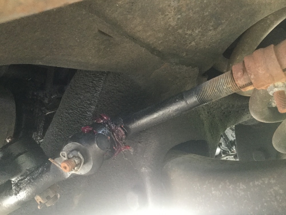

So every year, when the weather gets cooler, my front end starts squeaking and I go under and grease up the front end. Everything has grease fittings except the 2 connecting pieces (forgot what they are called) that make up the bar that connects both wheels. I got a needle end, that hooks up to my grease gun and I just poke it in the boots there and give it 3 pumps. I give everything else 3 pumps also.
This year, normal squeaking come colder weather. I grease everything up and old betsy goes silent.. but this time about a few days later, shes squeaking again.. thats weird. I grease her again, goes silent for an hour and starts squeaking. I look under and pretty much all my grease is pushed out from the tie rod fittings and ends, the ball joint ones look fine.
How are my fittings pushing the grease out? Can there be too much and its just getting pushed out when the wheel turns and "pulling" the rest of the grease out? Doesnt make any sense to me. Everything seems still to be good, the whole front end is relatively new. The boots arnt cracking or breaking or anything like that.

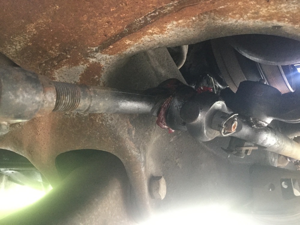

And just because pictures always help, heres the "connecting pieces" of the bar that goes across the wheels with the tie rod ends on either side.

Ok UPDATE!!
So I've learned these are my inner tie rod ends.
One thing I remember doing is "rotating the boot around" to "spread the grease around inside... which I have never ever done.
Went under the truck and sure enough, the boots have formed into a specific "shape"
And I rotated them around to find their little homes, turned the truck on, had someone turn the wheel for me and watched them move and they wernt pushing out grease (just a normal little bit around the edges) after I greased them up.
So maybe thats all it was LOL
Thank god I didnt goto a shop, they would have said REPLACE! And I just realized that these inner tie rods DO HAVE grease fittings on the side... of course the dealership who charged me under $3,000 for my complete front end so many years ago didnt put grease nipples on these, and as a matter of fact, I found out after the job was done. Nothing had grease in them!!

So, after moving the boots around, is the front end still making noise? It's not unusual for that style of joint boot to overflow grease during use, in my experience.
You may not want to hear this from me? :silly: But it's also been my experience that once a joint starts squeaking, greasing it is just a band-aid. The same squeaking joints also usually have play to some degree. Even if it's not making noise right now, I'd still suggest dry park checking the steering linkage, and inspecting the ball joints for play.

Pumping grease in hides wear for a short while but when the truck is on the road the suspension moves and the free movemen due to wear forces the grease out.
One thing to watch is over greasing bursts the seals on the rod ends.
