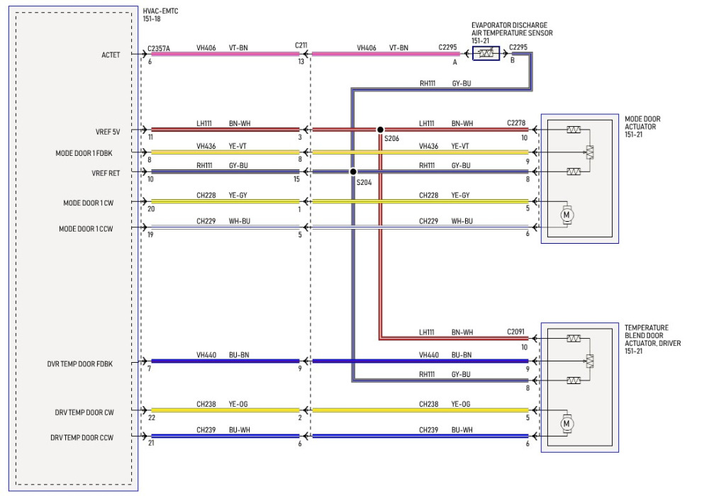

Does anyone know what fords vref return is? That a ground?? I’m working on a single zone ac temp door not working that’s what one wire is labeled on the schematic. It’s a manual system not electronic

If it connects with another wire/sensor i would say it is a ground. But if you dont have a signal wire it could be your signal as well. Can you post the diagram?

Hmm I would have thought it would be a 5vref
5 years 11 months ago #44436 by Noah
Replied by Noah on topic Re:2010 fusion
Sounds like sensor ground to me.
5v (vref)
Signal
Sensor ground (vref return)

Noah that’s what I thought. I went from dlc pin 4 to vref return and got 5 volts. I told the shop sounds like a bad ground but they were all like you sure you know what your talking about etc I said yes. Then left because they didn’t want to pay up for my advice. Haven’t heard back I’m assuming it fixed it running a redundant ground

Sensor ground shared with mode door and the evap temp sensor. Quick look at the evap temp PID should give some direction ;)
