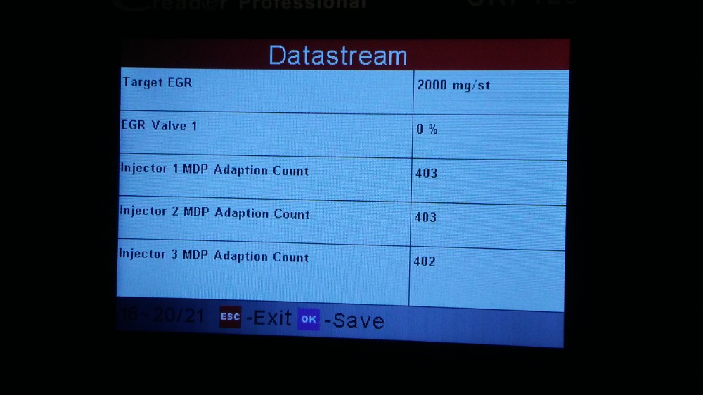

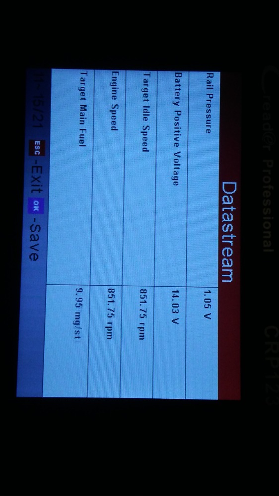

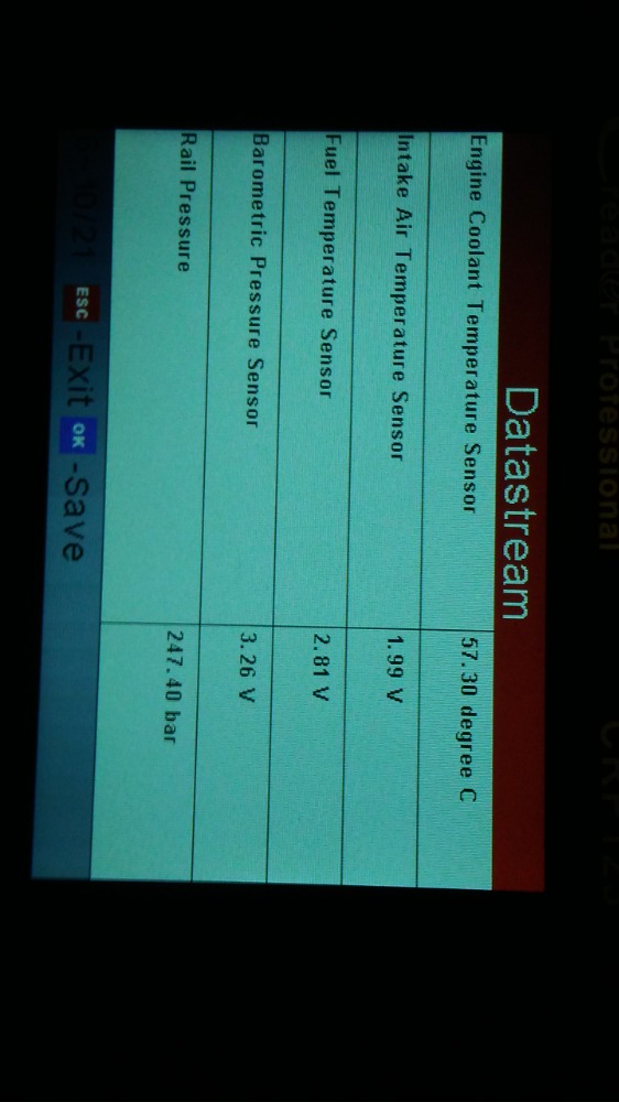

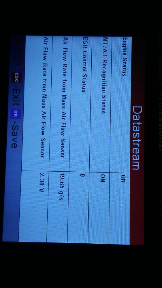

Not expert at all on diesel engines but I see those maf readings too low.
Here are some PID's of my mothers Sedona (not sure whether is 2.7 or 2.9). Anyway, Maf readings are higher.
If air flow is not coming from intake manifold, then could be coming from EGR, isn't it?
Regards.
Regards.

Replied by MikaelTheorin on topic Kia Sedona Ex 2.9 CRDI 2006 MAFS sensor readings strange numbers!
Thanks a lot for the readings! I didn´t see the attached pictures at first glance at the post...

During a good drive the readings looks a lot like the one you posted guafa.
Thanks again for your posting!
