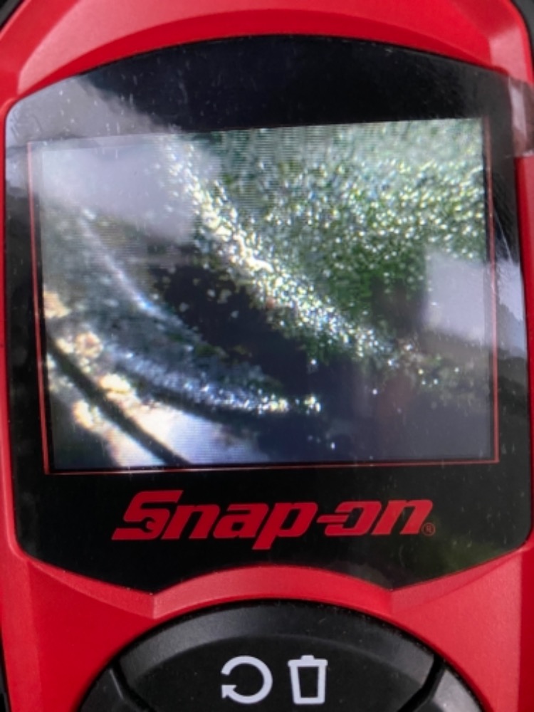

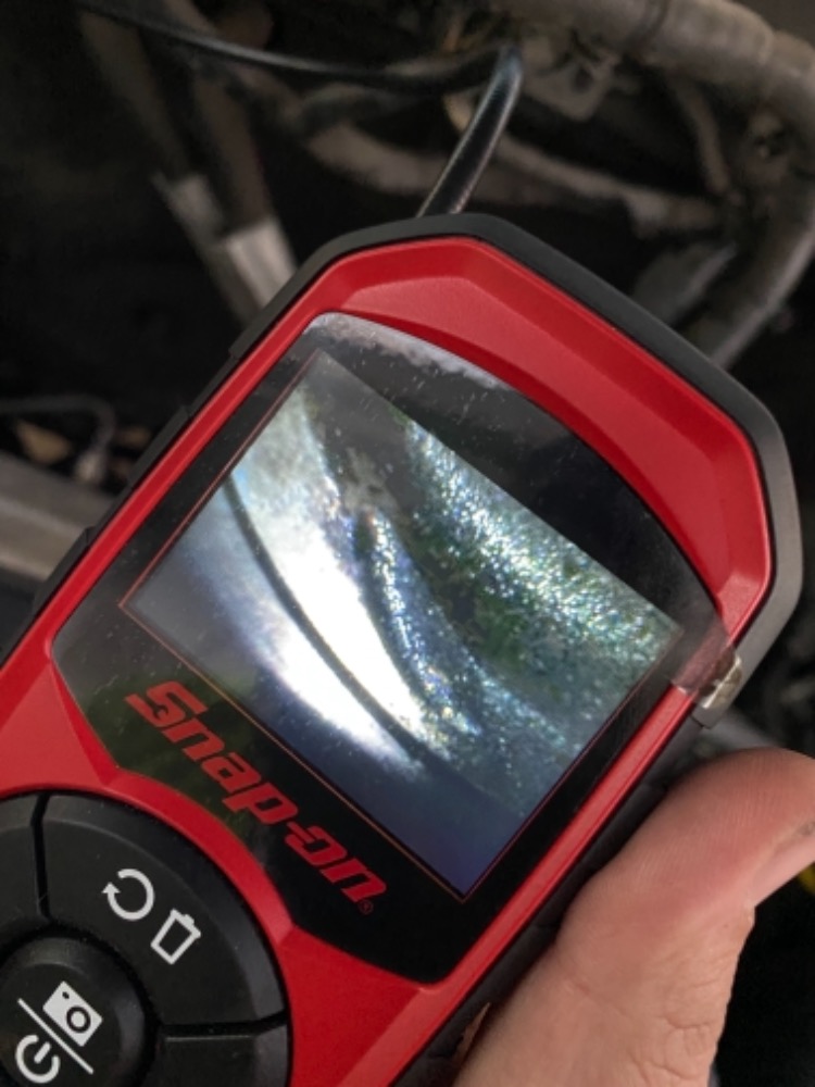

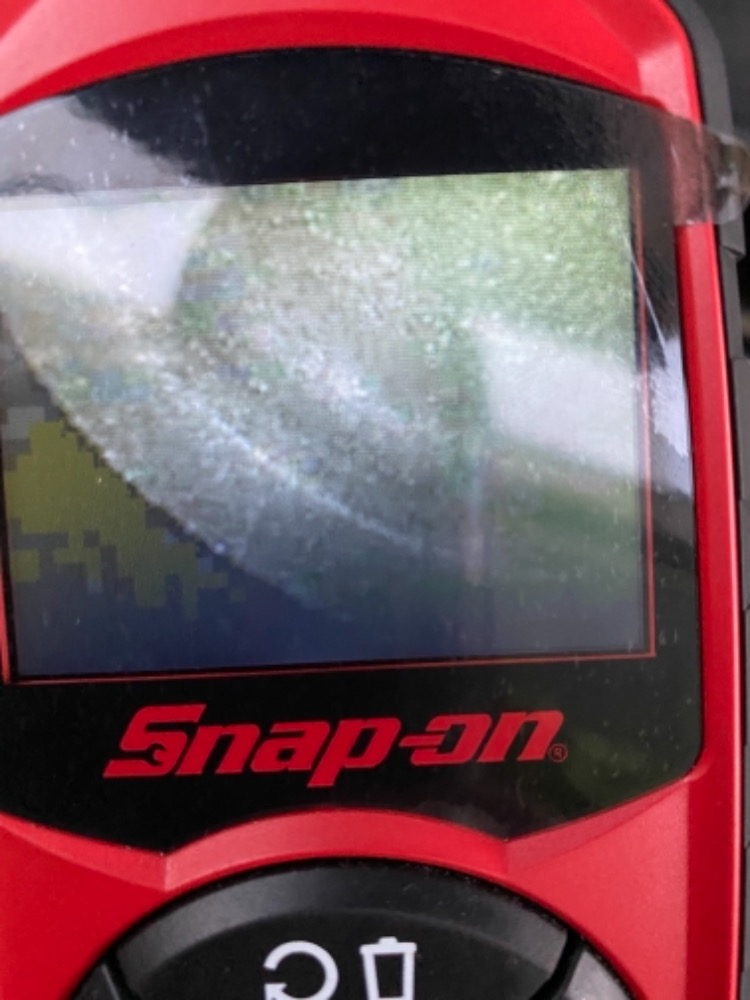

6 years 1 week ago #43924 by FordGuy1990
Replied by FordGuy1990 on topic P0301 Ford Escape
Here’s what the piston looks like, not sure if that’s the valve or a part made into the piston? Any ideas, the piston is clean expect where those to pieces are
  • FordGuy1990
  • FordGuy1990's Avatar Topic Author
6 years 1 week ago #43925 by FordGuy1990
Seems to be intermittent, sometimes it’ll idle rough others it’ll idle like new, but regardless of the idle when you get around 50-55 you’ll get a vibaration.
