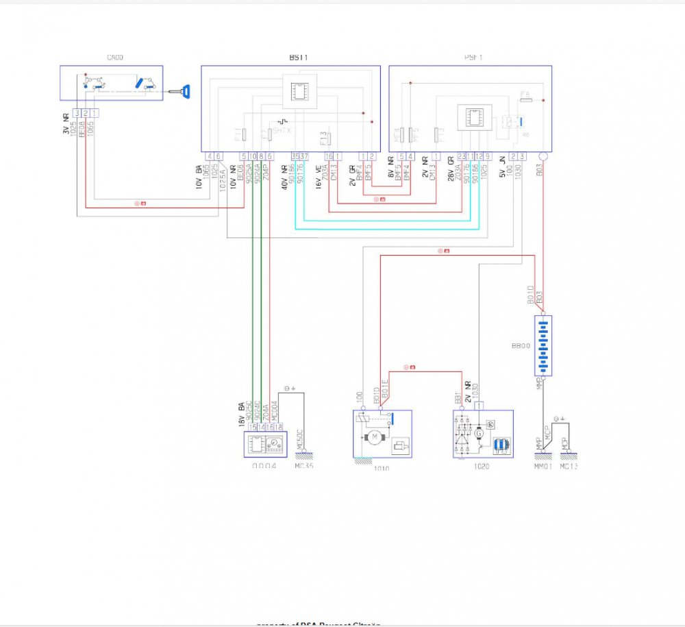

10 years 2 months ago - 10 years 2 months ago #791 by Doc
Replied by Doc on topic No crank
I can have a look on Carweb for a wiring diagram for you if you post or PM your reg & VIN
Also you can register on the peugeot website as an independent operator for info.
Once registers you can buy all the info you need public.servicebox.peugeot.com/pages/index.jsp
Added a generic 207 DV4 starter diagram for you.
PSF1 - Engine fusebox
BSI1 - BSI
1010 - Starter
1020 - Alternator
0004 - Instruments
HTH
Doc...

Doc wrote: I can have a look on Carweb for a wiring diagram for you if you post or PM your reg & VIN
BSI1 - BSI
1010 - Starter
1020 - Alternator
0004 - Instruments
HTH
Doc...
Thank you for finding this for me! I am still wondering of I have a problem within my fuse box as when I take out fuse 8 the pin that connects the wire which runs down to the starter still gets 11v, also fuse 13 is getting a constant 12v when the ignition is switched on when it is only meant to be getting this voltage when the key is then turned to the start position, could anything else be causing this before I go any buy a new fuse box? Also with fuse 13 and fuse 8 the pin is still getting about 11v but at the end of the wire at the solenoid the reading is 0 when attached?

I wouldn't worry about F13 at the moment.
Is the voltage at pin 2 enough to light a test lamp connected to GND with F8 removed?
When key is turned to start measure the voltage at Pin 2 back-probed (F8 fitted)
As a double check, if you have an inductive Amp clamp then test for current flow on 100 - Pin 2 on cranking.
207 have issues with the loom running from engine fuse box, it is well worth giving the wires a good tug and visual inspection as you may have a short to power back feeding up the loom.
Hope this helps (HTH)
Doc...
PS, double check your engine GND and body GND - there should be two separate body GND points just behind the L/H headlamp, they are normally covered in grey sealer but water gets underneath the sealer and corrodes the grounds.
Last edit: 10 years 2 months ago by Doc. Reason: Added info
10 years 2 months ago - 10 years 2 months ago #839 by Tyler
Replied by Tyler on topic No crank
I like where Doc is going with this. Having 11V on pin 2 with fuse #8 out is screaming 'resistive short' to me. The voltage going to zero with the solenoid wire connected reinforces this. Looking at the pin numbers for the connector at PSF1, I see pins 4 and 5 getting fused battery power at all times. Wondering about corrosion between those pins and pin 2.
Mark, didn't you say you had this same symptom with both this fuse box and the old fuse box? If that's the case, then I'd say you don't need a fuse box at the moment. We may get there later, but I'd like to hear the results of Doc's suggested testing first.

10 years 1 month ago #1400 by Andy.MacFadyen
Replied by Andy.MacFadyen on topic No crank
"When I touched the positive terminal on the battery it was getting pretty warm."
Also 0.57v is too much betweem the engine block and battery negative is too much, you have a bad engine ground.
All the main connections to the battery need removed and cleaned and the main earth cable needs checked and the connections cleaned at the engine block, body and battery .
