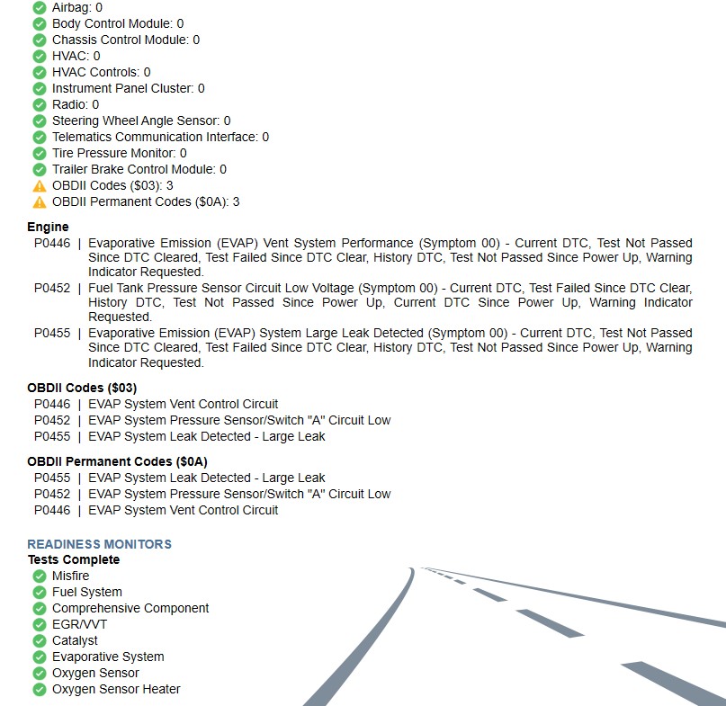

Nope, fair comment. :cheer: I actually didn't include all the codes that were present when I first scanned the truck, mostly because I didn't feel they were relevant to my question about the FTP PID. This is the results of my initial code scan:
The P0455 was the main reason for the smoke test. Is it likely that we have a large leak AND an FTP sensor problem? Of course not. But I've been burned by multiple failures too many times to assume. :) I could have checked the Freeze Frame for the P0446 and P0455 to see when they set compared to the P0452? But the truck is already on the rack, and the smoke machine is handy. Like I said, paranoid.
