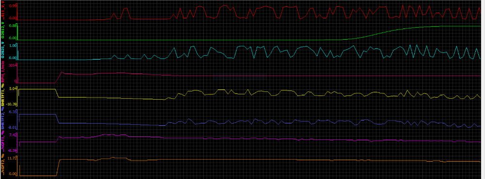

Hi there. I'm having an issue with my car using too much fuel, the mileage seems to have almost halved over the last few months, it smells rich when it starts, and tends to hesitate in 3rd/4th gear, or when hard accelerating usually up a hill. Other than that though, it starts and idles OK and generally runs fine. The car is a 2001 Ford Mondeo mk3, with the Ford Duratec 2.5l v6 24v engine (I think similar or same as the Ford Contour). I do not have any DTC's set and the MIL light is off.
It seemed to develop the problem a while back after I fixed a vacuum leak on the oil separator assembly vacuum lines. I'd had the MIL come on then and lean codes P0171 and P0174 for banks 1 & 2, but it ran OK like this though so I didn't immediately troubleshoot it but after a few weeks I heard a loud hiss when it was idling, found the leak and fixed it. MIL light went off after that, cleared the codes and they didn't come back. But not long after (maybe a month or two because I hadn't really been driving the car much), I noticed the lowered fuel mileage and it seems to have got worse lately.
The car also started misfiring at the same time I noticed the high fuel consumption (and it was quite bad at early on), I assumed it was maybe the coil/plugs/leads that were gone or going bad, which may also explain the higher fuel consumption, so I replaced all of them. This actually did seem to cure the car's hiccups for a short period but I noticed it was still hesitating in higher gears up hills. Certainly seems to do more in wet weather than dry.

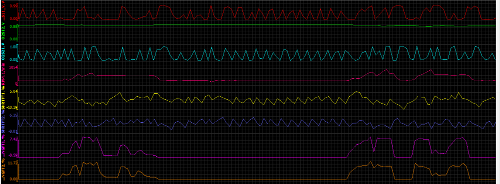

Someone suggested to me recently to check the oxygen sensors on the car so I've been using Forscan on my laptop connected to the ODB port of the car to check things, but being a novice I'm not really sure what I'm looking for. The engine has three sensors on it, two upstream, one on either bank of course, and a single downstream after the main cat. Looking at the oscilloscope function of Forscan it seems the upstream sensors are at least working as they do seem to be constantly switching back and forth between lean and rich. The downstream sensor stays fairly constant after the engine starts to warm up.
From top to bottom, it's OS11, OS12, OS21, RPM, STFT1, STFT2, LTFT1 & LTFT2. That screenshot shows the first two minutes from when I started the car from cold and just left it to idle while it warmed up.

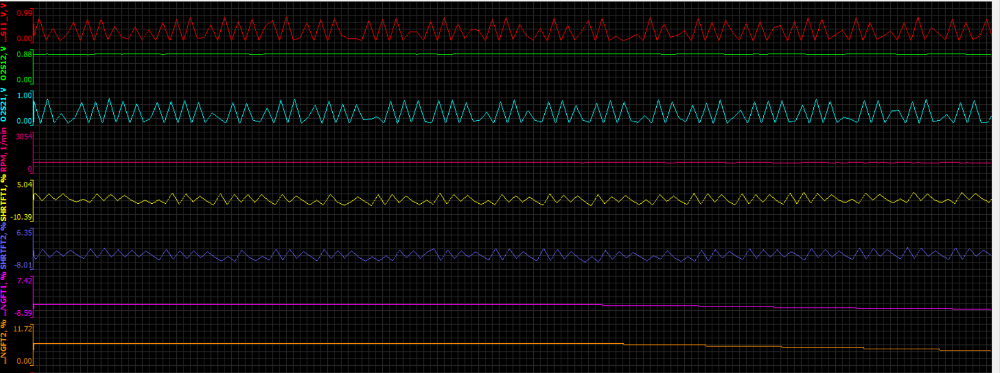

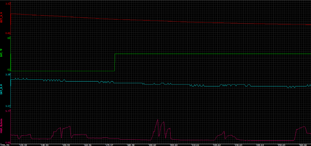

This screenshot shows it from ten minutes onwards after it had warmed up. The only thing on these graphs that I would say seems off based on my (very) limited knowledge from what I've been reading is the LTFT on bank 2 seems to be riding positive all the time, and never goes negative like the other LTFT, so I assume the problem is on bank 2.
I recorded the data while idling but I also went out for a drive in it while still recording too, hence why I added the RPM data:
This is around the twenty minute mark, driving around town. I know what I've provided is fairly limited, but I would appreciate it greatly if at least someone could give me some suggestions and pointers as to how I might go about continuing to diagnose this. Many thanks!
6 years 1 month ago #43500 by Hardtopdr2
From the looks of the bank one sensor 2 (the one after cat) looks like it is toast but you will need to test it to confirm (unplug vac line see if it goes lean then feed propane in it to see if it goes rich after hooking vac line back up). if it still is smelling like fuel when adding propane you will need to check if fuel injectors are leaking or not closing with a fuel pressure tester. This test is done with key on engine off with fuel pressure gauge installed. You just need to see if fuel pressure is dropping past regulator pressure. If it is lift up the fuel rail with injectors and look for dripping fuel from injector nozzles. If nothing there then you will need to check fuel pressure regulator to see if it is sticking by cycling key on while watching fuel pressire which should go to 50-60 psi at first then drop to rest pressure ~45 psi (you will need to consult service manual for known good pressure) if that is good and no bleed down in pressure you will need to check injector drivers for switching ground using test light clipped to bat positive. If all injectors switch (aka light blinks) then drivers are good. This leaves th o2 sensors to blame for rich condition ( longer injector on time)

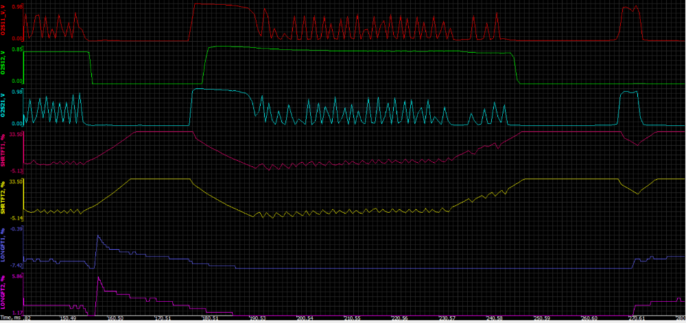

6 years 2 weeks ago - 6 years 2 weeks ago #43745 by tl58

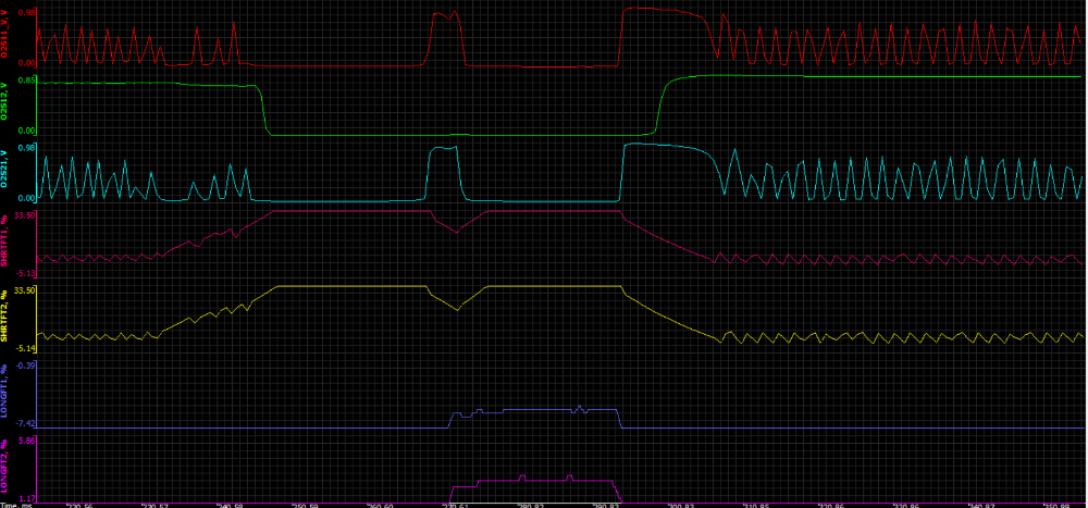

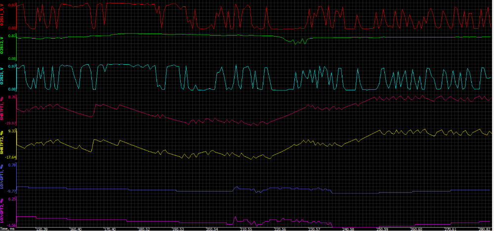

Hi again. I managed to get some time to try the lean/rich test on the sensors just now as suggested. I let the engine warm up for a couple of minutes until the sensors started to work, then popped a vacuum leak on the inlet manifold, which nearly stalled the engine but I managed to cap the leak enough to keep it going.
Then I tried it again with some revs.
I did the rich test too, plugged the vacuum leak then ran propane into the air intake. I couldn't quite manage to get a steady flow of propane into the intake because the valve on my propane bottle is a bit dodgy but you can see where it went rich a few times:
So, looks like the upstreams both reacted to the rich condition but the downstream didn't change much.
I will also note that I couldn't smell fuel while I was doing either test, I usually only smell it when the engine starts up anyway.
At any rate, does that downstream sensor look kaput then? I'd love it if that's all that's wrong with the thing, because that sensors actually nice and easy to get at and I do have a new spare downstream sensor I can fit.

6 years 2 weeks ago #43751 by Tyler
It sure looks to me like the downstream is doing its job? :huh: Or rather, it looks like you have two healthy catalytic converters. There's a noticeable delay between you opening/closing the vacuum leak, and the downstream sensor switching. That suggests some level of oxygen storage. The test drive data also suggests there are no significant exhaust leaks between the upstream and downstream sensors.
Did Forscan list a Rear O2 Fuel Trim in the PCM data list? Probably not, given the model year, but it might be fun to check. :cheer:
Did any of your previous captures show the hesitation in 3rd/4th or when accelerating hard up a hill? If not, could you get a capture of that and post it? Because your trims are pretty good, IMO. :silly: Little bit of a positive change in the long terms on acceleration? But that's not unusual on a 19 year old vehicle.

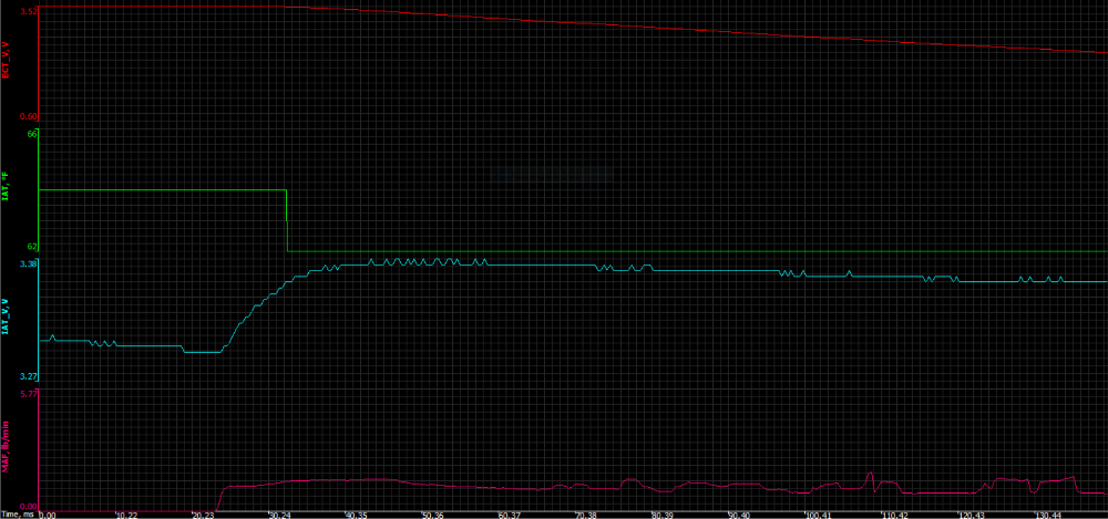

6 years 1 week ago #43862 by tl58

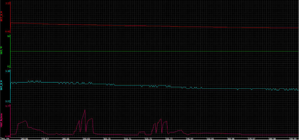

Well I had a look for temperature and MAF PIDs in forscan, there were several PIDs and I wasn't entirely sure which ones to use so I guessed, looking at it I must have missed the ECT actual reading in °F but I put the voltage reading there.
Top to bottom it's; ECT sensor voltage, IAT °F, IAT sensor voltage, MAF lb/min. Graph begins a few seconds before I started engine from cold and drove it for a while until it had warmed up.

Sorry for the late reply been busy which is a good thing for me lol. The thing i dont like is how the rear o2 returns to .83 v and stays there. So either you have an injector sticking open or a pressure regulator leaking. Possibly something else causing it to run rich

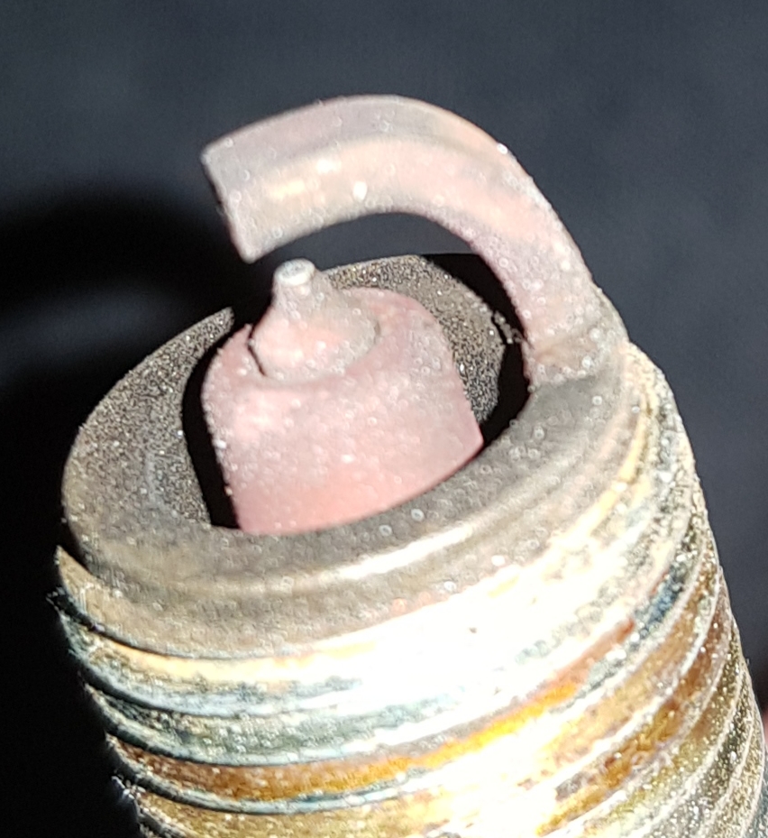

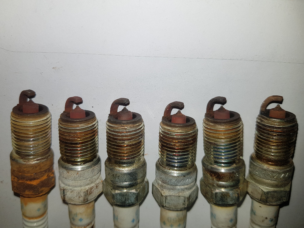

As you know I changed the spark plugs earlier in the year hoping it was part of the problem, but it wasn't. I've never actually looked at the old plugs but I still have them and it occured to me I might see fouling on one or more of the old plugs potentially showing a potential culprit. But they mostly all look the same as this one:
I'm certainly not going to pretend I can say for sure they all look OK, but based on pictures I've searched for on plug condition "reading", aside from the red tan which I'm lead to believe is normal due to fuel additives, they're all fairly healthy looking (unless I'm utterly wrong but then that's why I'm posting the pics so someone can tell me as much).
