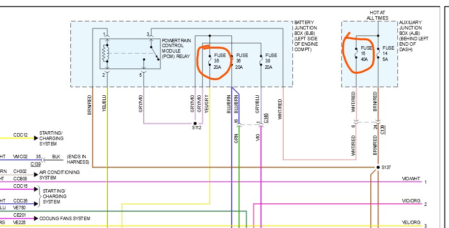

Fuse 35 is good and the connectors are clean, I don't have the aux battery system, will I still have the aux battery junction box? Next I will check for power at pin 5 of the PCM relay and get back to you.
Thanks
Bill
5 years 10 months ago #43182 by Chad
Replied by Chad on topic 2015 ford transit no crank/no start
Do you get power on Fuse 35, with the key on?
I believe, you will.

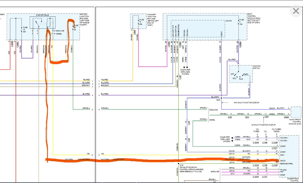

Can you start the engine by turning the ignition to the RUN position and cranking the starter by applying POWER to the Gray/Orange wire on the starter Solenoid?

Back again, I have looked at the diagram and it looks to me like I am looking at it backwards, should the power be coming in to pin 3 on the PCM relay and going out to the #29 fuse? If that is the case I have no power on the relay pin 3. That would be a problem in the aux junction box?

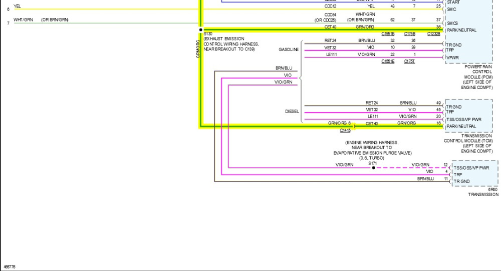

The highlighted circuit is the Park/Neutral circuit. I'm not sure what voltage should be on this circuit. I would, simply, look for a "Change" from High to Low, or Low to High, while shifting from PRNDL Make sure the "change" is the same at all 3 point.
Do you see any signs of PATS? (Passive Anti-Theft System)

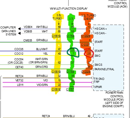

Monde wrote: My question is: shouldn't we check for power on pin 7 and ground on pin 37?
You are correct. That is what we did in the second post of this thread.
Chad wrote: Do you have power on Fuse 29 when attempting to crank? If so, the PCM is sending power to the Starter Relay. If not, do you have power at Pin 37 of the PCM? If you have power at Pin 37 and Fuse 29, then that is good. The relay is getting control POWER (barring any problems with the relay socket). The Yellow wire should receive a control GROUND from the PCM on Pin 25. If you have power on Pin 25, while cranking, then the PCM is not providing a control GROUND.
By checking for power on Fuse 29, we are checking Pin 37, as Fuse 29 is powered by Pin 37.
Do to this diagram covering multiple engines, with a few differences, I mis-quoted the Yellow wire as being on Pin 25, instead of Pin 7.
Last edit: 5 years 10 months ago by Chad.
5 years 10 months ago - 5 years 10 months ago #43210 by Chad
Monde wrote: My question is: shouldn't we check for power on pin 7 and ground on pin 37? Usually, in a relay, you always have both powers at the top and grounds at the bottom.
Re-reading your question, I see that you asking if Pin 7 is POWER, and Pin 37 is GROUND. Pin 37 CANNOT be a GROUND. If Pin 37 was Grounded, Fuse 29 would blow.
I'm not saying it isn't done but, I have never seen a fuse on the ground side of a circuit.

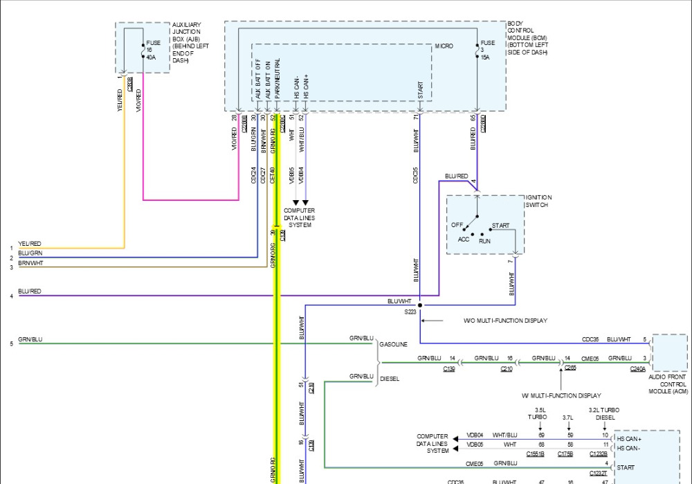

That fuses function certainly isn't obvious. Might be there to configure the vehicle for engine and/or audio front control options rather than provide overcurrent protection??? Wouldn't be the first time an OEM used a fuse to turn something on or off....
Either way that same diagram shows start signals landing on the BCM and the audio front control module. Time to step away from the DMM and start checking PIDs IMO.

Hi guys, I notice that the audio mod is somehow involved in the starting system, has anyone had a problem with that?
One other symptom I had not thought about. when I turn the key on the radio comes on, I turn the radio off but the next time I turn the key on the radio comes on again
