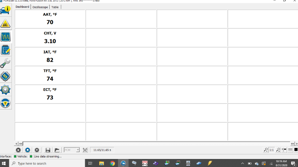

  • Tyler's Avatar Topic Author
5 years 7 months ago #42683 by Tyler
These are the various thermistor temps prior to startup, after sitting overnight:

5 years 7 months ago #42685 by Hardtopdr2
Replied by Hardtopdr2 on topic 2012 Ford Fusion - VERY intermittent no start
Was your outside temps at time of data capture 82 degrees? +/- 5 degrees
5 years 7 months ago #42691 by Tyler
Hardtopdr2 wrote: Was your outside temps at time of data capture 82 degrees? +/- 5 degrees
76 degrees, according to my phone. :silly:
5 years 7 months ago #42692 by Hardtopdr2
Ok all sensor readings are normal then.
