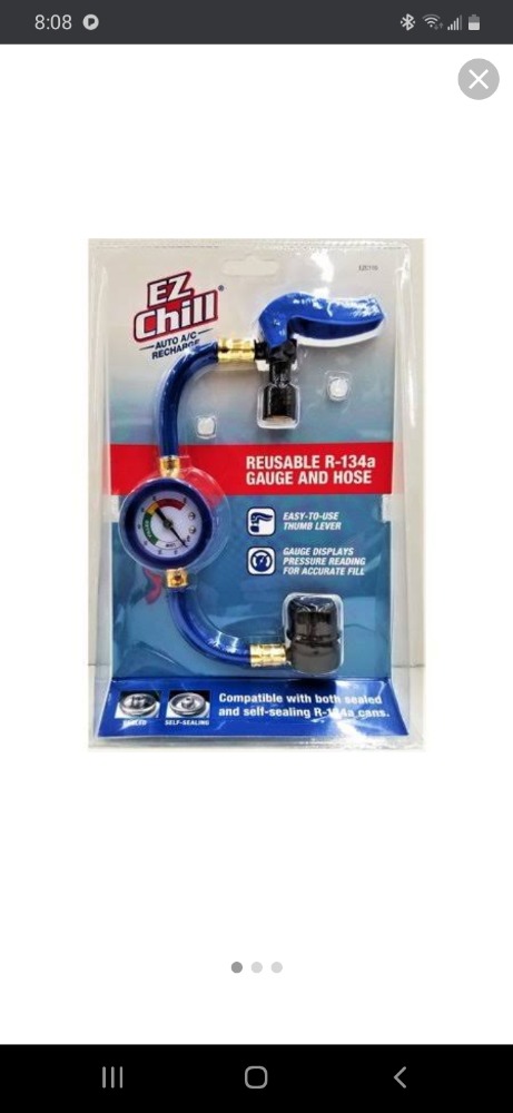

6 years 2 months ago #42024
Replied by Noah on topic A/C leak
The following user(s) said Thank You: Andy.MacFadyen, al514

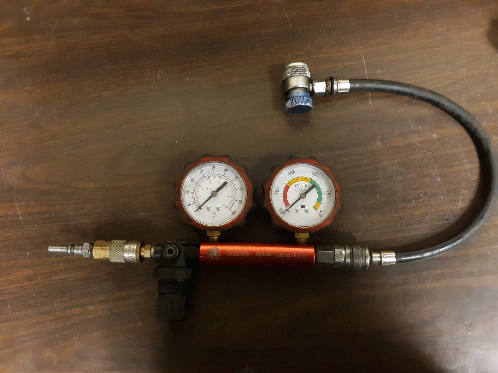

6 years 2 months ago #42034
Replied by Chad on topic A/C leak
The following user(s) said Thank You: Noah, Tyler, Andy.MacFadyen

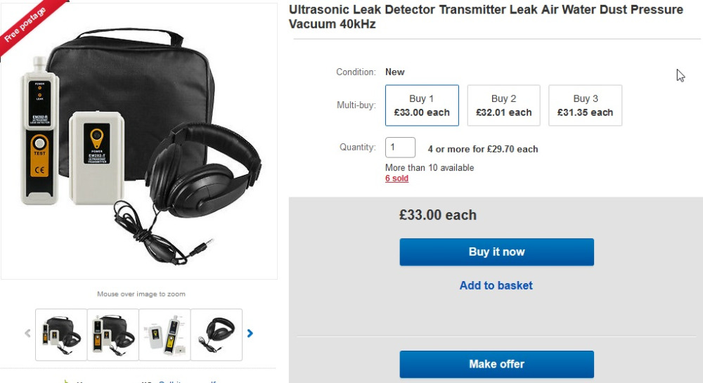

As above a little air pressure Ultrasonic leak detector is very good for pinpointing leaks this is the cheap one I use

Man, this site has shown me how far behind the times I am as far as diagnostic methods and equipment goes!
As far as ultrasonic detectors go, about how small of a leak are the more inexpensive units accurate to and would they be able to pick up a leak from, say, an evaporator core? The bane of my existence has been A/C leaks lately and any extra edge I can get in finding the things I'll jump on.
6 years 2 months ago #42038
Replied by Andy.MacFadyen on topic A/C leak
A sniffer test to give you the general area then ultrasonic is very good for tracking down to within a few mm. When I got mine I tested it on a car with a really tiny leak from the LP Schrader valve -- it found it with no problem the leak was so small when I gave it a soap bubble test it was only prosducing about a single 1mm bubble every two or three minutes.
It also works on inlet vacuum leaks, no so good for windscreen and door seal water leakds.

That's perfect, I just happen to have one of those laying around, I'll do high pressure smoke. And soapy water at the same time. Good ideas. Thanks all.
