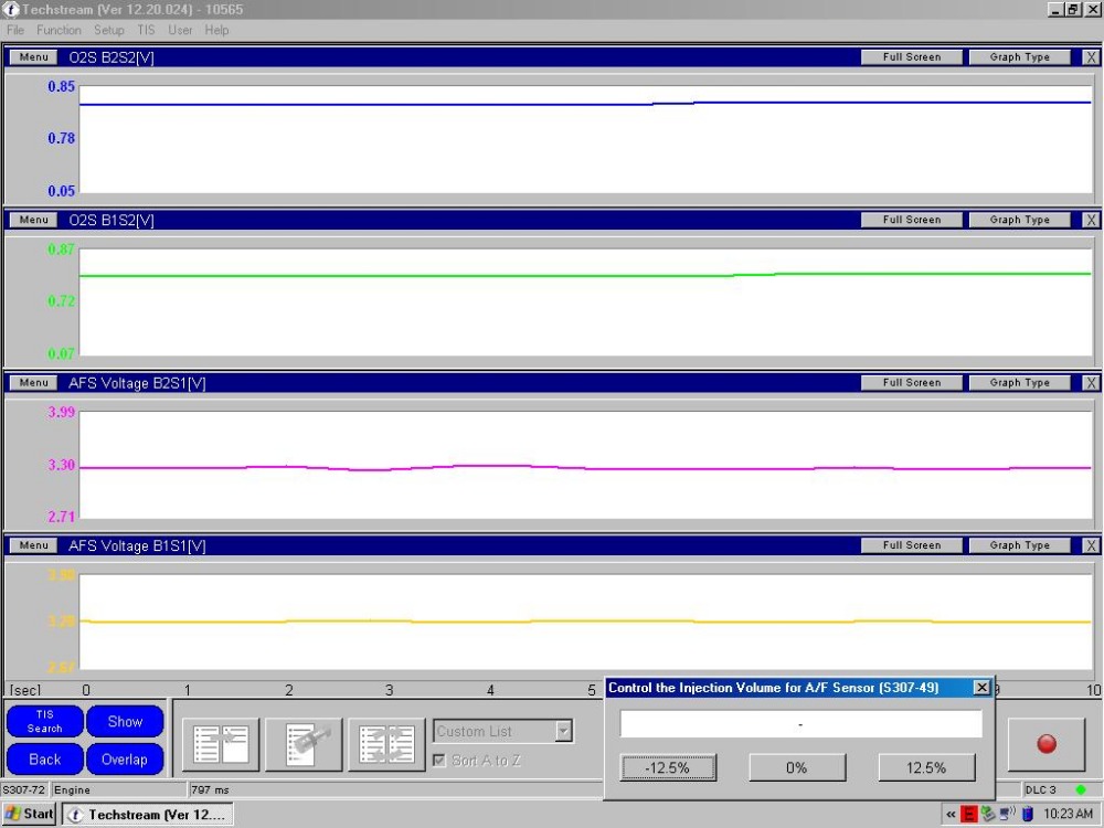

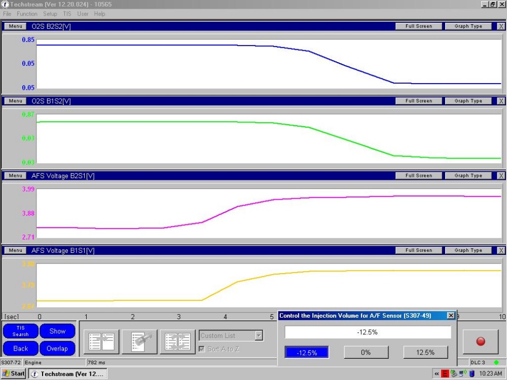

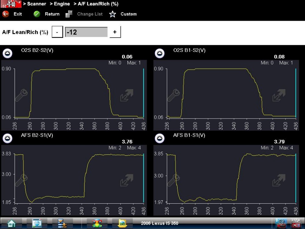

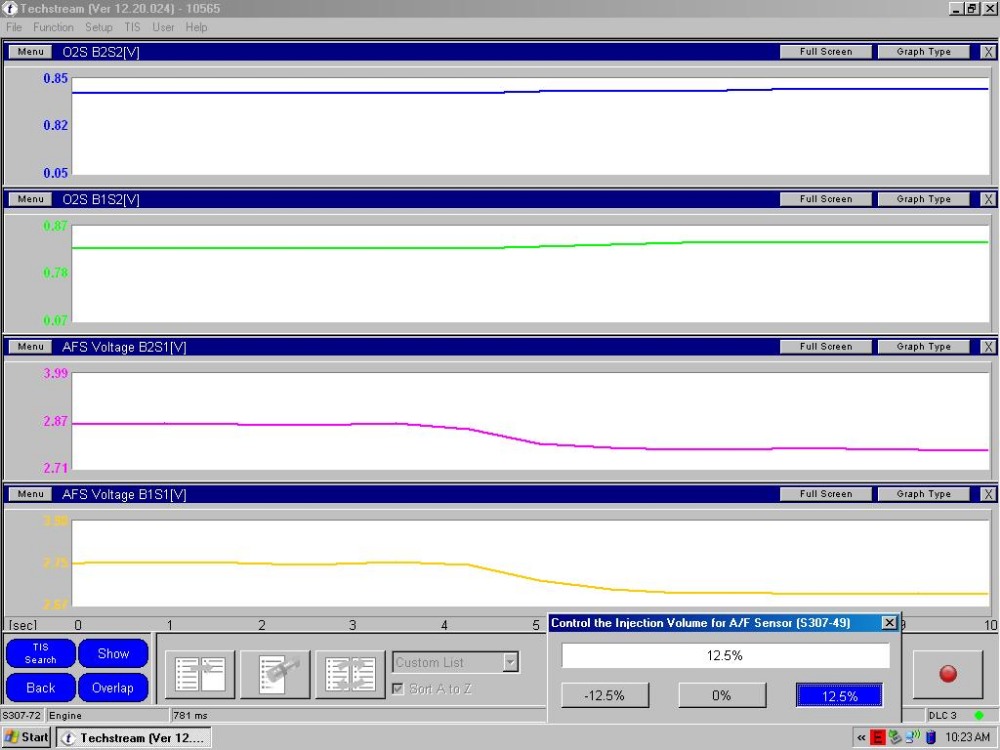

I ran the Control the Injection Volume for A/F Sensor test to monitor the A/f Sensor and O2 sensors but to be honest i don't know what i'm looking at
i took a couple of screenshots to see if someone can guide me what to look for

6 years 3 months ago #41549
Replied by Tyler on topic 2006 Lexus IS350 P0420 and P0430
It looks to me like your Injection Volume test showed good results? :huh: All sensors show rich and lean when you commanded the air/fuel ratio. The downstreams lagged behind a bit, and that's normal. The upstream sensors read close enough to stoich with no change commanded, and seem to move equal amounts during ratio changes.
I normally use that test to look for sensors that respond slowly, or to catch lying sensors in the act. For example, if you commanded a rich condition and one sensor refused to read rich, or was slow to change, that'd be a red flag.
What were your fuel trims at idle and while driving?

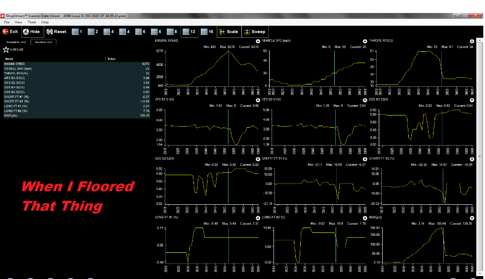

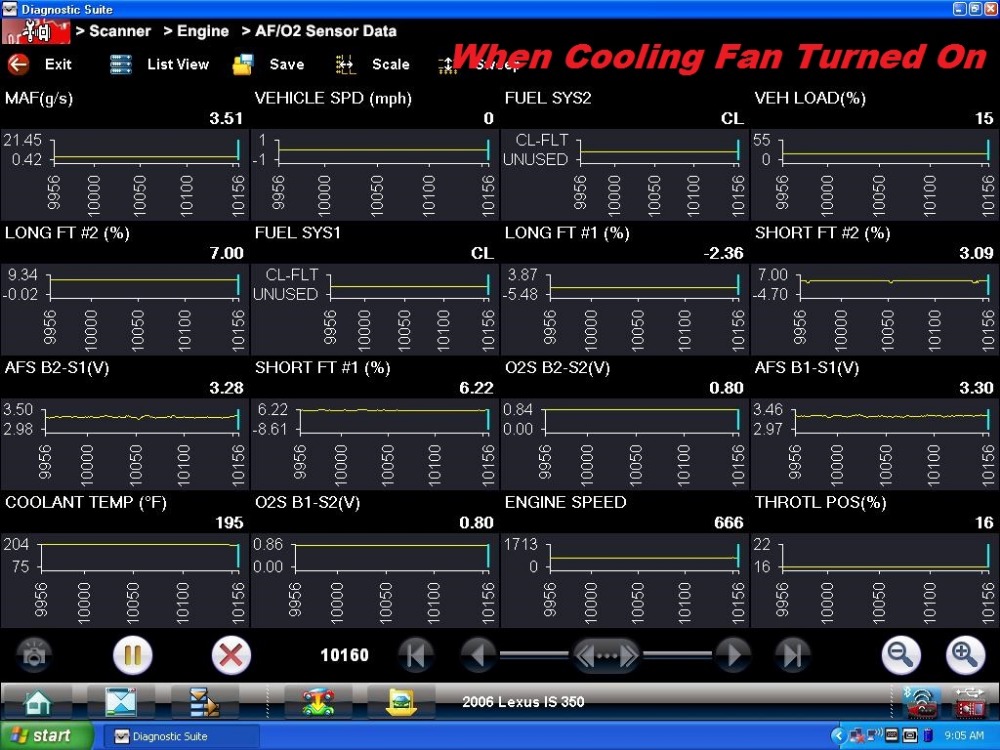

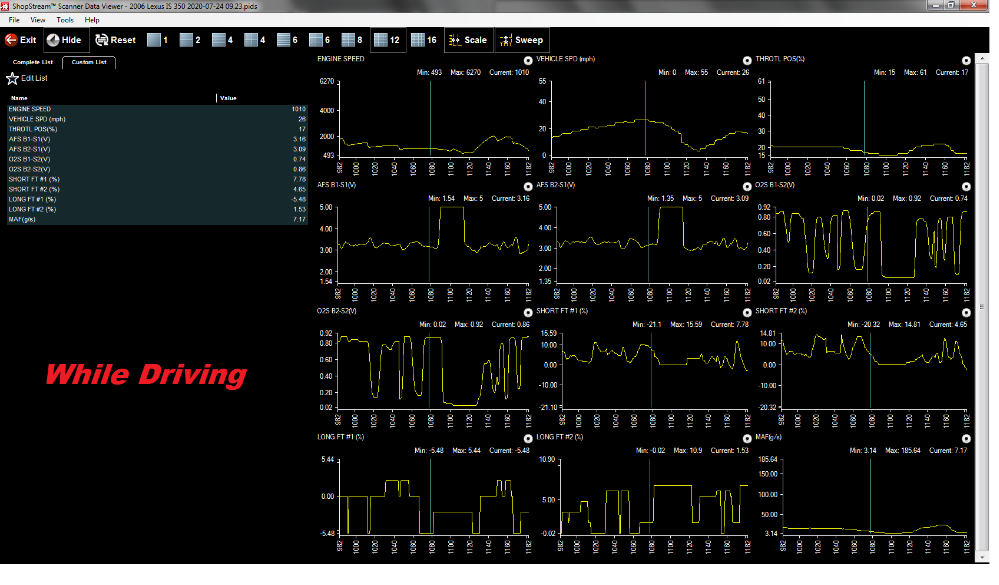

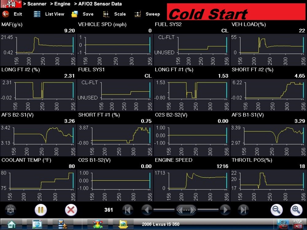

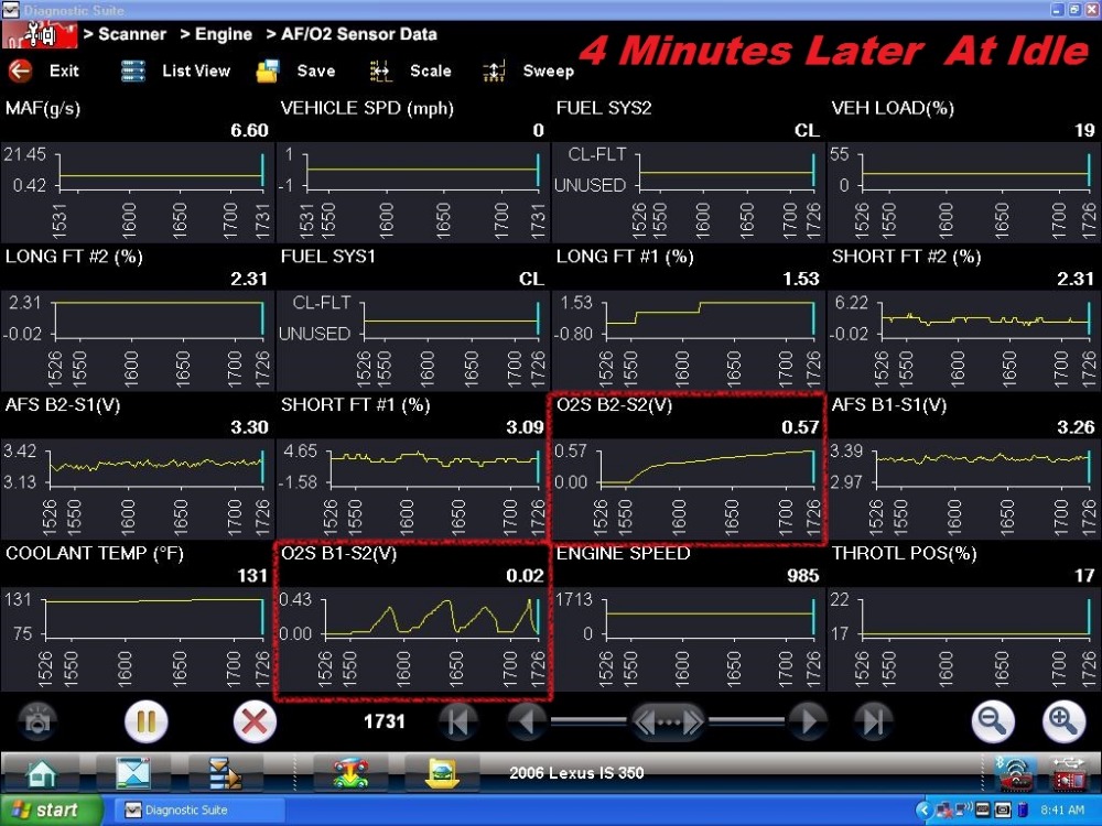

I have more information about this Problem.
I started the car when cold and i took more screenshots when cold start, when purge valve started working and when the cooling fan turned on
also when i was driving on part throttle and WOT

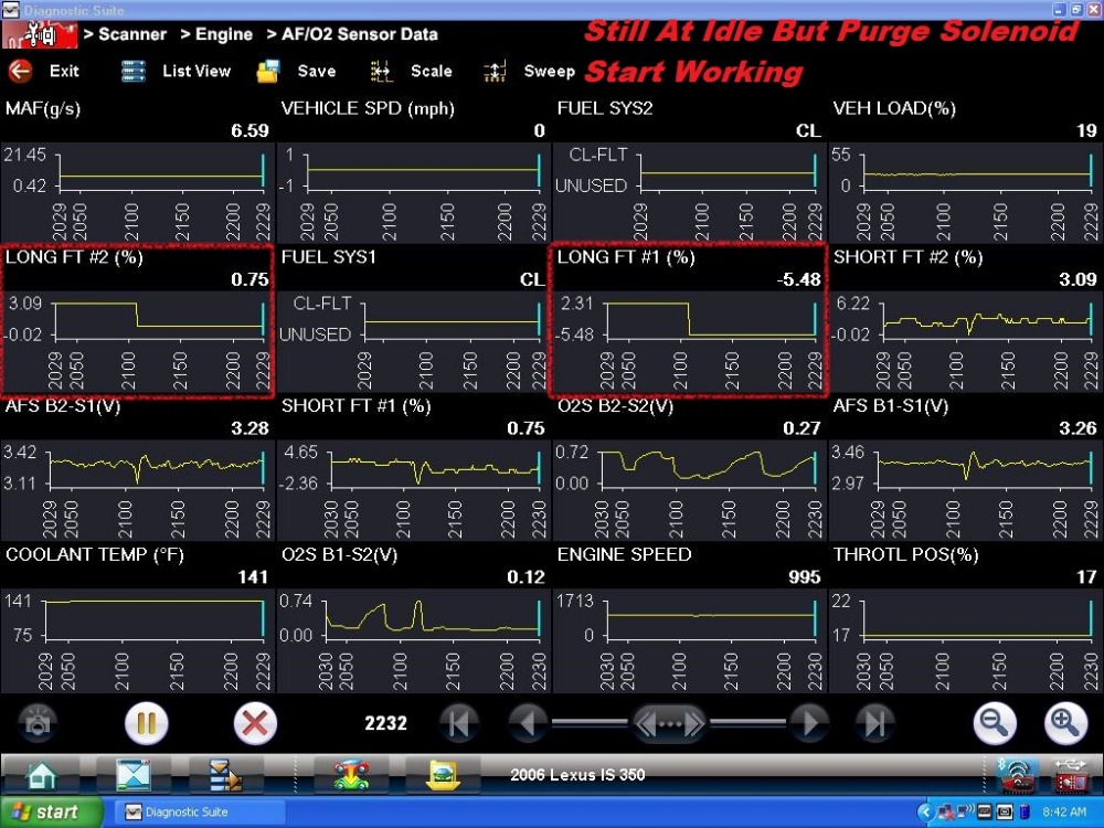

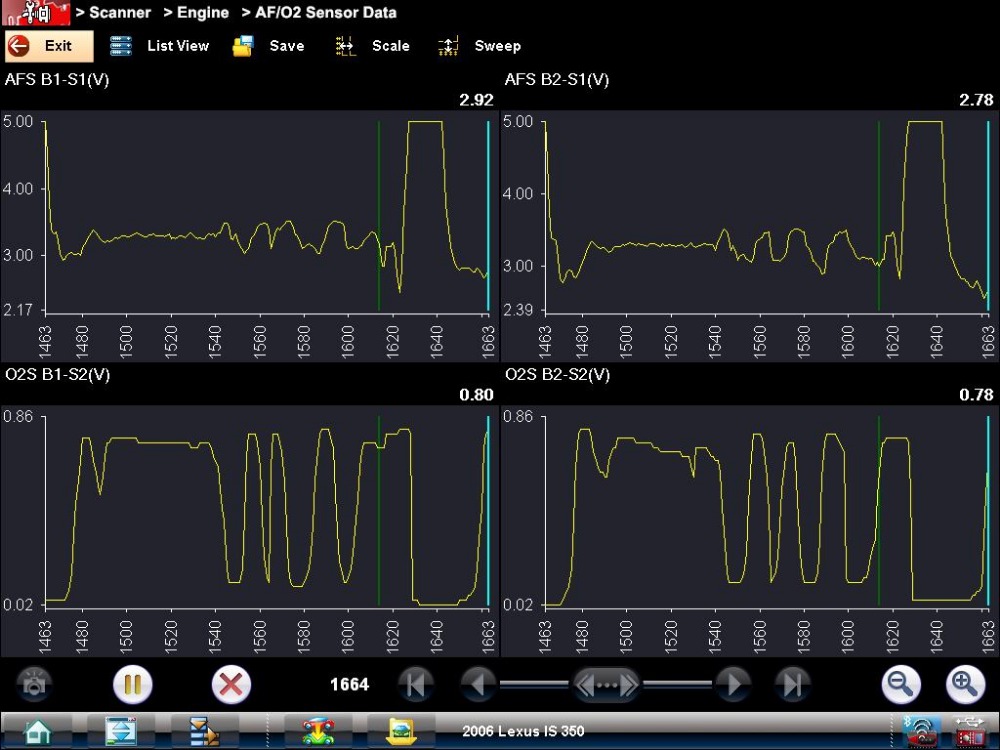

- Posts: 6146
6 years 3 months ago #41688
Thanks for the additional info.
I see the trim shift when the purge comes in, but the total trims are still very reasonable, IMO. As a matter of procedure, I'd have like to see a capture of WOT from a rolling stop through the 1-2 upshift, just to make sure there's fuel enrichment capability. Your upstream A/F's did go rich, just not as rich as I'd like to have seen. I believe this is because you 'rolled into' the throttle instead of matting it.
Those downstream O2's are switching quite a bit while driving. That's not a smoking gun by itself, but combined with the P0420/P0430, I think you're done.
Check for any TSB's, double check your exhaust, then suggest cats.

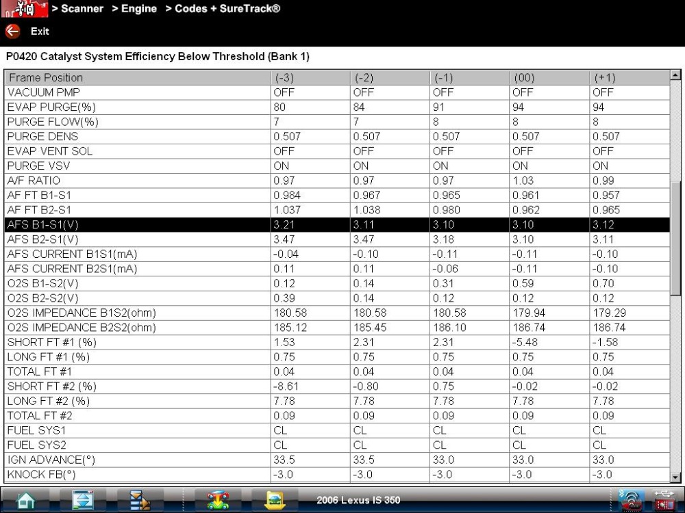

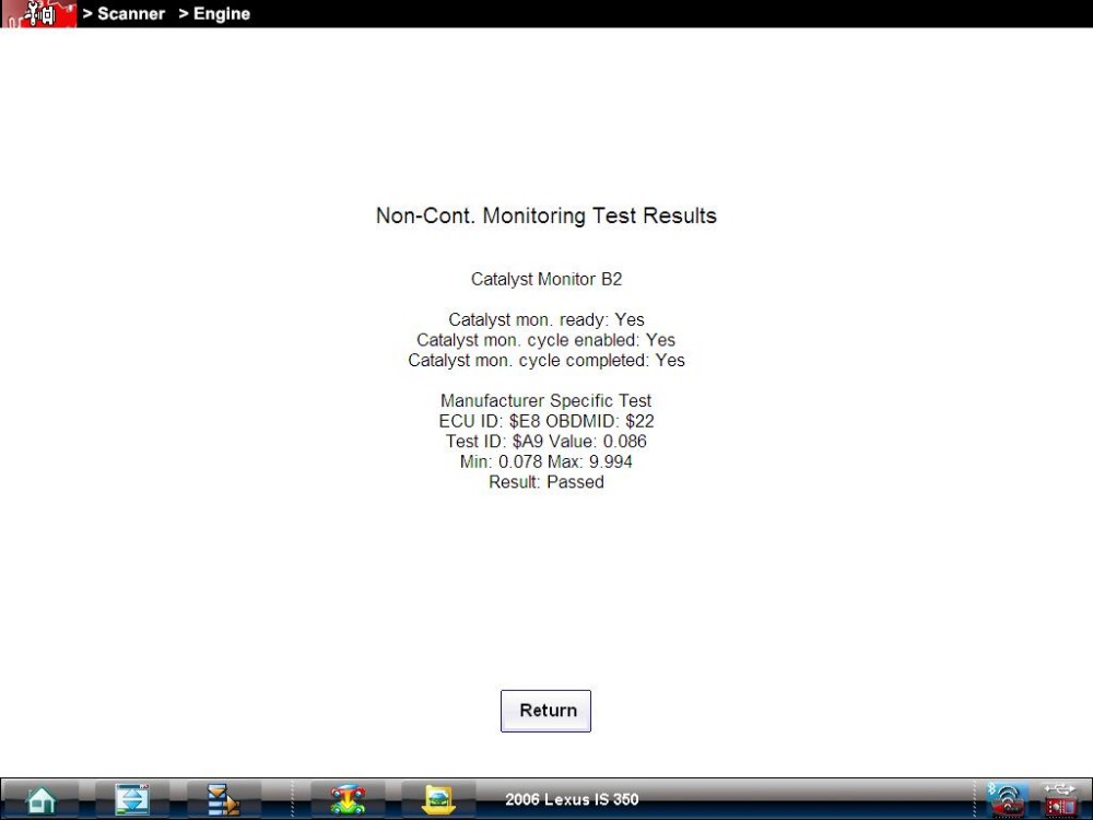

(UPDATE)

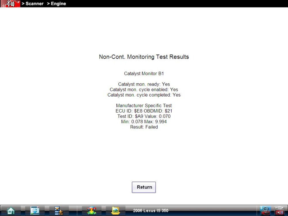

i double check for any leaks again in the engine and exhaust and i didn't find any leaks, i swapped the A/F and O2 sensors from left to right to see if there were any changes or something, i cleared the codes and drove it 2 days for 15 miles each time and i'm getting only the P0420 now .
i ran the test again and took screenshots for mode $06 and i suggested the both front cats. I don't have access to check TSB's.I'll wil post the results after i change the cats, on the meantime these are the screenshots after i swapped the sensors.
