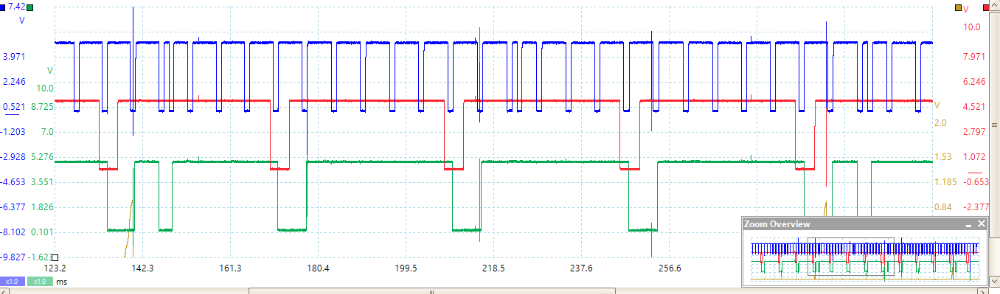

Yes we did. We tried starting fluid. This one really has me thinking so I’m open to any help I can get and thanks to everyone who has responded already. I finally was able to take a cam and crank waveform from it but I can’t get it to upload

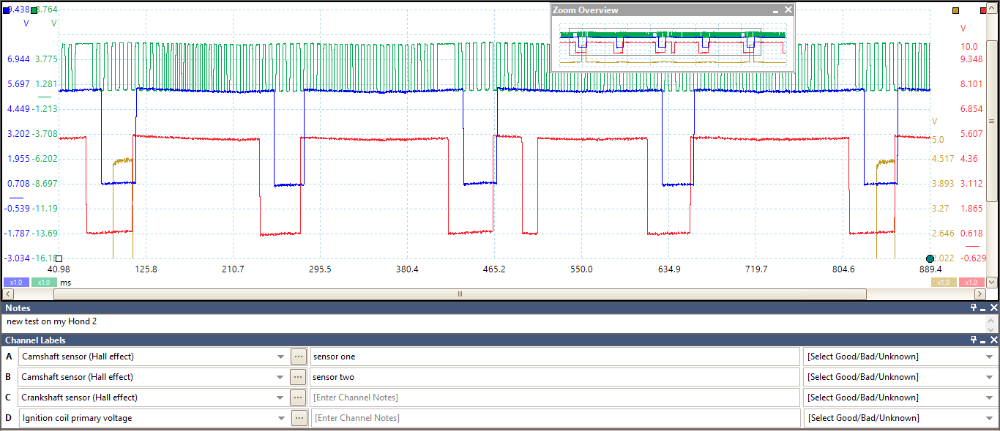

5 years 8 months ago #41563 by Tyler
Replied by Tyler on topic Re:2008 Honda Accord 2.4l
Are you trying to upload screenshots? What scope did you use?

5 years 8 months ago #41572 by Da Beginner
Replied by Da Beginner on topic Re:2008 Honda Accord 2.4l
We’re using a pico scope and yes it’s a screenshot.

5 years 8 months ago - 5 years 8 months ago #41598 by Tyler
I haven't seen anything yet? I'll keep checking this morning.
EDIT: Never mind, got it!
I'll have to find another known good. :huh: The CKP reluctor wheels are completely different.

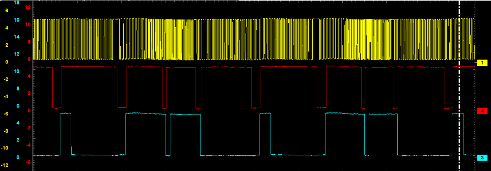

5 years 8 months ago #41602 by Tyler
Has this engine been apart recently? Used engine? Chains replaced?
From what I can tell, two things happened around '08. One, the CKP reluctor changed, from 12+1 in the known good I posted, to yours with too many teeth for me to count right now. :silly: Two, the exhaust CMP reluctor changed, from the 4+1 in mine, to one that looks like the trace in blue:
I can't find any waveforms that have your particular combination of CKP and CMP. :angry: In every example I've found, if the vehicle has the new CKP waveform, it also has the new exhaust CMP waveform.
Am I missing something here? :huh:

5 years 8 months ago #41622 by Da Beginner
Tyler to answer your question yes the engine taken apart to change the head gasket. It came from another shop also can you email me the known good cam and crank wave form you have please. michael.francis3261@gmail.com
I got a waveform from a 2010 with the engine and the Patton ain’t the same I will send you that too, please send me the one you have as well thanks
