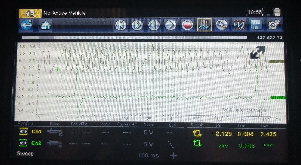

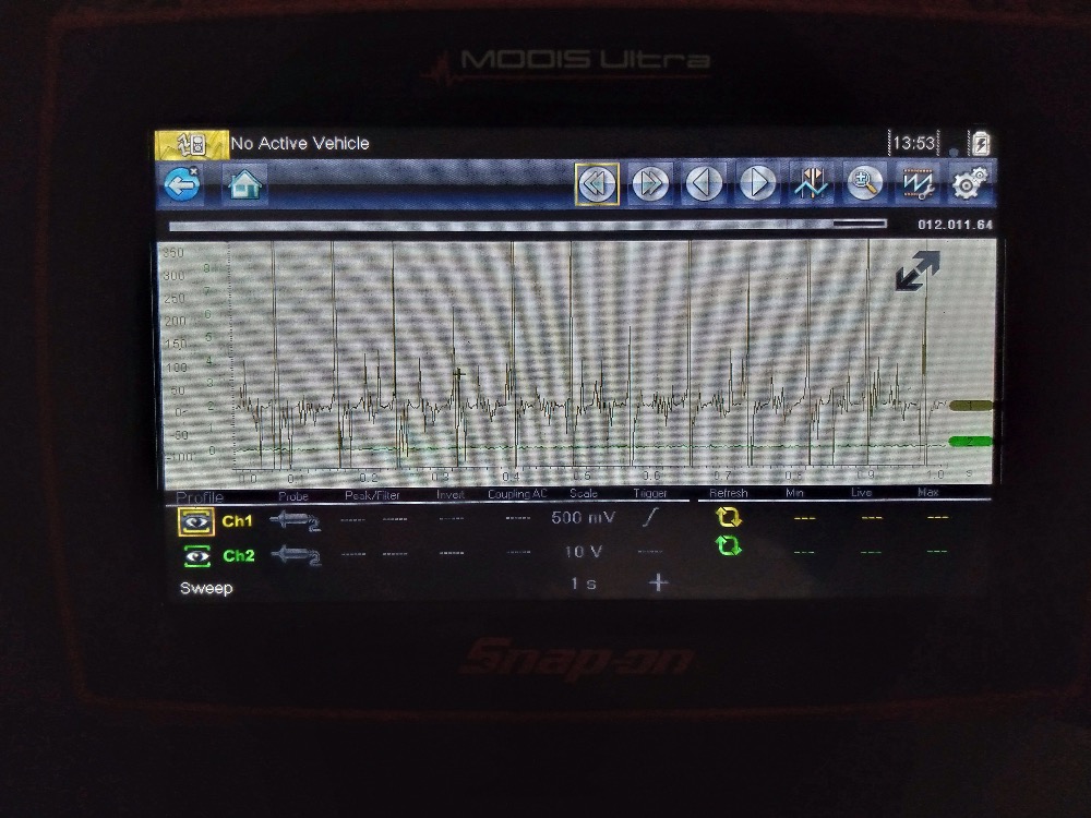

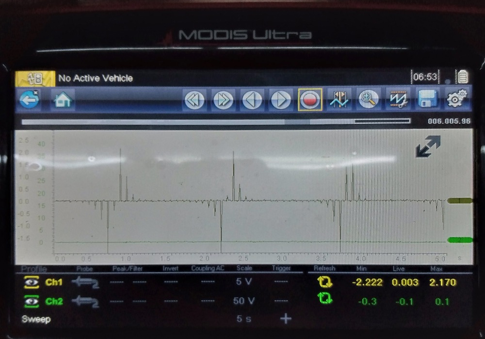

Thanks guys. I'm trying to make sense of the inconsistent spikes in the signal. Bearin in mind I'm trying to diagnose an engine check light condition that brings a CKP code at idle that disappears at 2000 rpm.
The first two images were taken from either side of the sensor using chassis ground, and these next two were taken full spectrum with the earth on one side of the sensor and the probe on the other side.

6 years 3 months ago #41397 by Hardtopdr2
Replied by Hardtopdr2 on topic Two wire CKP sensor question
Oh ok lol the first photo in your last post is how it should look.

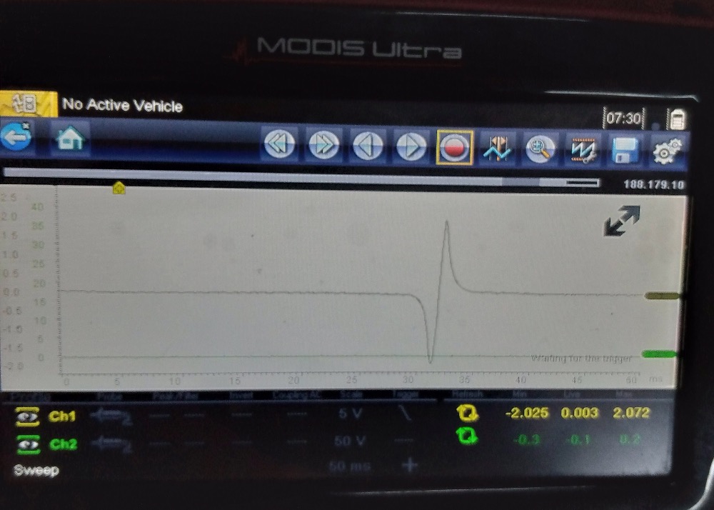

6 years 3 months ago #41408 by Darren
Replied by Darren on topic Two wire CKP sensor question
Thanks again Hardtop. Yes, I agree that the first image is how it's supposed to look, but bear in mind I set a trigger to "zoom" in and freeze it, but I was trying to get a 10sec frame to analyze the consistency of the signal and that where I get those weird spikes. I would have expected to see consistent spikes over a longer time frame? The four progressive spikes which are then immediately inverted has got me stumped.
Another thing that came to me last night at home is I remembered that the rev counter is not working on this vehicle, which leads to to believe that the NE signal on this vehicle may not be working? It's hard to believe because this vehicles starts with no issues and has no drivability issues either, just a CKP code that comes on at idle or deceleration.
Still, I'm not 100% convinced that this is a good CPK signal.

Another thing is the first two images of this thread is either side of the CKP using chassis ground on the oscilloscope. One side is crazy noisy. I would have expected similar patterns?
6 years 3 months ago #41410 by Hardtopdr2
I noticed in the last two one had a trigger set the last one didn't so that may be why but dunno

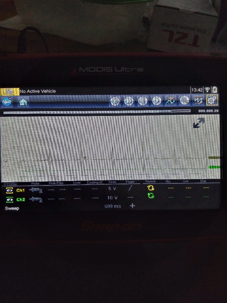

6 years 3 months ago #41455 by Darren
I managed to get a half decent capture of the CKP on channel two and the NE (from the injector pump) on channel one..
To my untrained eye I don't see an issue with this waveform? Why is it bringing on a CKP error code? Any thoughts would be greatly appreciated.

Thanks for the input guafa. This is a 1kz-te Diesel engine from a 1996 Hilux Surf

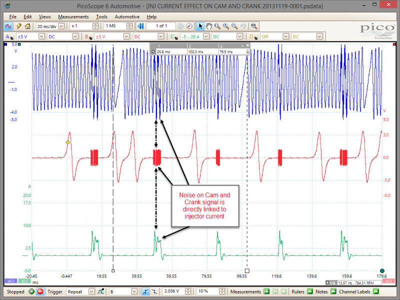

6 years 3 months ago - 6 years 3 months ago #41464 by Hardtopdr2
Ok i have a quick question are you probing the sensor or at the computer/pcm? And if at the sensor where is your sensor located at that your probing? From what i looked up the single wave your getting is the camshaft sensor. Attached is the crank sensor waveform
Ckp is blue
Cmp is red
Injector is green
