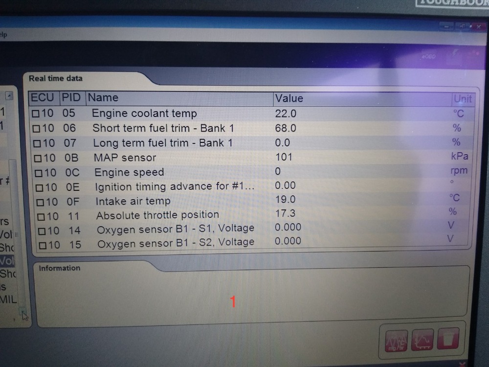

Hi, I have a 2003 1.6 zeetec ford focus petrol. The engine has a MAP sensor but no MAF. It has high emissions. It has high LTFT at idle. No codes have been set. The car drives and runs fine otherwise. The car has a history of short journeys.
O2 sensors are functioning as expected. I have looked for a vacume leak using brake cleaner and smoke in the engine. I could not find one.
The evap solenoid is closed at idle. If I pull the vacuum pipe off whilst the engine runs, causing a vacuum leak, the engine revs increase and the LTFT drops to zero.
I checked the exhaust for leaks and found the manifold leaks. I replaced this and re-tested the exhaust for leaks. The exhaust is now not leaking, but the LTFT remains at 25%.
I have cleaned the MAP sensor and this appears to work fine. The coolent temp sensor and throttle position sensor also appear to function correctly.
The PCV is in good condition and does not appear to leak.
What else can I check? Could this issue be caused by a leaky intake valve?
Thanks

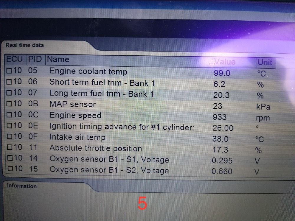

6 years 4 months ago - 6 years 4 months ago #40915 by Ant
Replied by Ant on topic High LTFT at Idle.
On a warm engine LTFT = +20. On a fully hot engine the LTFT shifts to +25. I guess this means that the problem deteriorates with temperature. The idle speed on a hot engine is approximately 800RPM. When the engine RPMs are increased, the LTFT drops. At 2600 RPM the LTFT is zero.
Tomorrow, I have access to an oscilloscope and I have made a exhaust pulse sensor. I will use this to see if I can see any problems with the valves. Although I have already checked the exhaust, I will recheck this, because I think the information above suggests a leak near the O2 sensor, thoughts?
One last point, I think the exhaust smells rich.
I will post back with what I find.
Regards

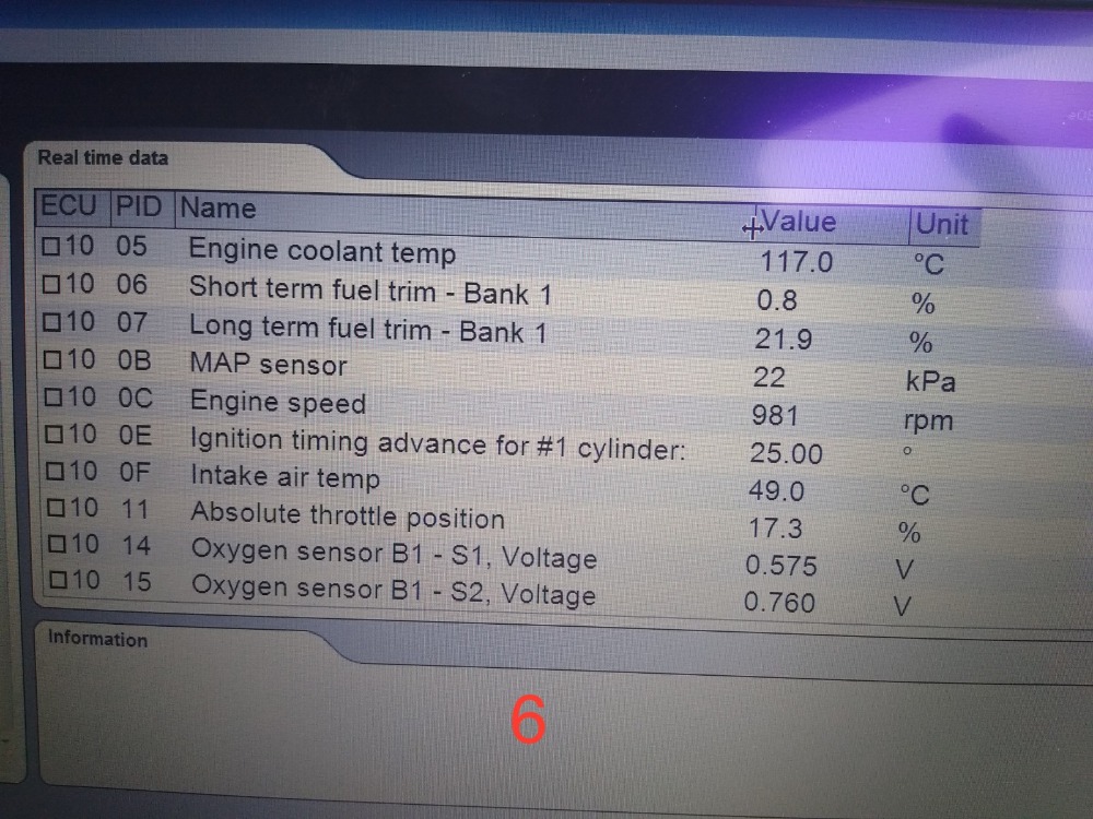

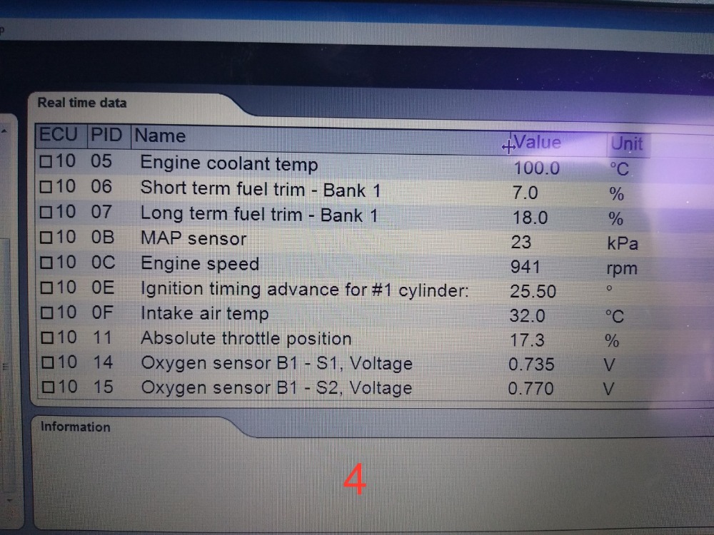

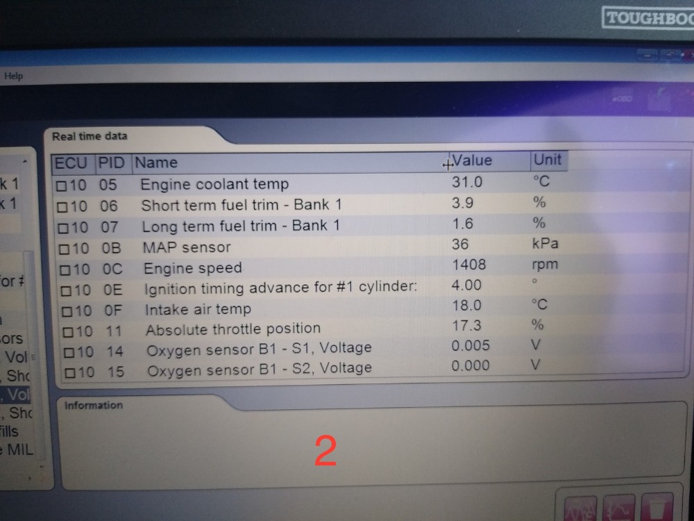

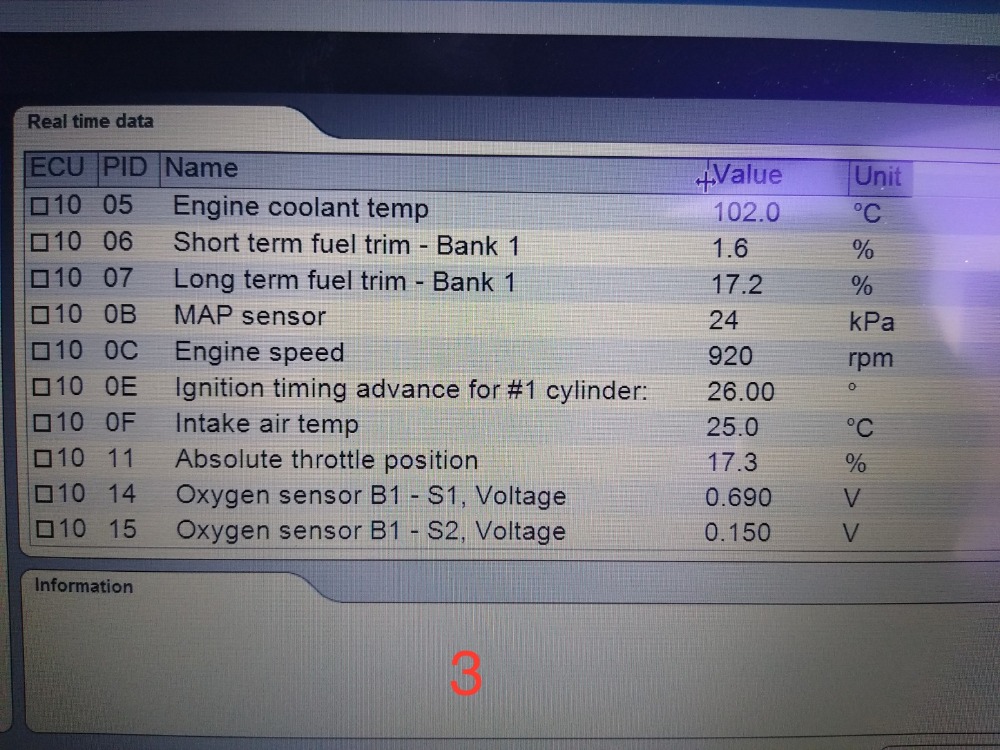

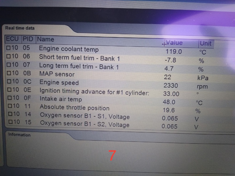

6 years 4 months ago - 6 years 4 months ago #40919 by Ant
Update on my last;
I have retested since changing the manifold and I have different results. Also the weather is considerably cooler then when I last tested. Today it is 19 degrees C and I have a faster idle speed. It was previously 800RPM, today its over 900RPM. Im putting this down to denser air because its approximately 15 degrees C cooler then when I last tested.
The LTFT on a cold engine at idle starts at +1.6. As the engine warms to operating temperature the LTFT creeps up to 21.9 at idle. This seems to go up in line with the intake air temperature. On hotter days the LTFT creeps up further to +25 on a hot engine. Im guessing this is because the thinner air on a hot day translates to a slower idle speed on a MAP system??
I have taken a series of live data photos, starting with the engine off, then cold through to hot and then at higher RPMs on a hot engine. Im sure the answer is hiding in the data there somewhere! Please see attached. Apologies, I can't get them to load in order. The file names run from a to g.
Last edit: 6 years 4 months ago by Ant. Reason: Remove duplicate files

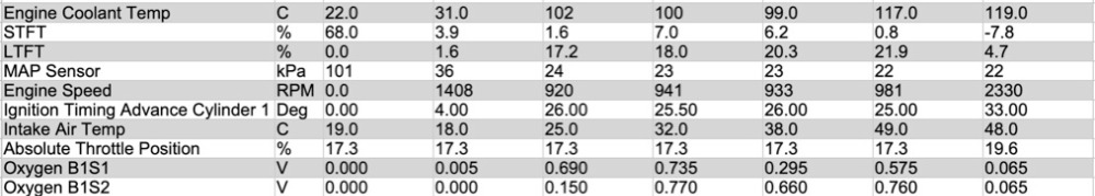

6 years 4 months ago #40946 by Ant
Tabulated data attached. Starting with engine off through to engine hot at higher revs.
