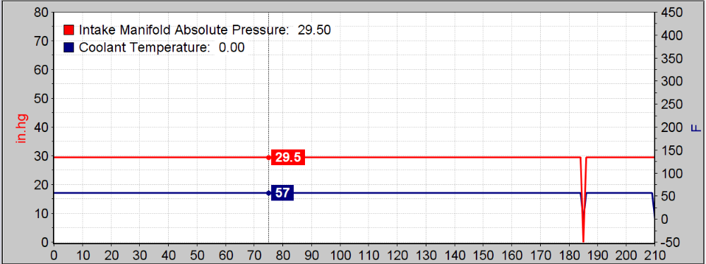

I've been trying to troubleshoot a random misfire. In the process i've been learning about and applying the use of a scanner by autoenginuity. I plugged it in to my 2005 Chevy Suburban and started watching live data on a graph with several sensors being monitored. Everything seemed to be normal and then out of nowhere a little blip occurred and it would occur every so often across all sensors. It would occur intermittently, and sometimes as close as 15 sec apart. All readings at an exact moment would drop to a reading of zero for about a millisecond. This must be the cause of the misfire. Is this perhaps a bad ECU or an ECU that needs to be reprogrammed? It doesn't make any sense.

I doubt an '05 is updating several PIDs once per mS or better. Do these drop outs coincide with noticeable misfires or is it just something you're seeing on the screen?

Here is a snapshot of monitoring intake manifold absolute pressure and coolant temp with engine not running. The same thing occurs with the vehicle running as well. Also, this occurs with 02 sensors and fuel trim readings or any reading at all. For checking injector pulse width and ignition waveforms are you saying to do that with an oscope? I don't have one but will look into getting that test performed.

andyru wrote: Here is a snapshot of monitoring intake manifold absolute pressure and coolant temp with engine not running.
I've seen the exact same phenomenon when using my Launch Pro Mini to view Global OBD data on similar year GM's. OEM data works perfectly. Do you have another scanner to try?

When I think I may be dealing with sensor dropout, the scope is the next step.

6 years 4 months ago - 6 years 4 months ago #40755 by andyru
So I’ve got the enhanced add on for AE and almost all of the misfiring is coming from cylinder 2. But for some reason when a trouble is thrown it usually says random misfire or misfire from cylinder 1. I’ve checked the spark plugs, spark wires, coil packs. The long term fuel trim on bank 1 is about -6% to -9% and bank 2 is closer to 0%. I decided to run a fuel injector test anyway. Everything checked out ok (although I’m not sure how accurate that test is). All the data on the AE doesn’t show anything really suspicious accept that intermittent glitch. But, it doesn’t coincide with the misfiring according to the AE scanner.
