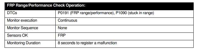

I suspect you were experiencing an in-range failure. The sensor signal may have been skewed, but not skewed enough to trip any of the traditional P0190/P0191/P0192/P0193 codes that these sensors usually produce when they fail. For example, here's the code set criteria for P0191 on your truck:
www.fordservicecontent.com/ford_content/...orcraft/OBDSM804.pdf
The kicker is the monitoring duration - eight seconds. :ohmy: I dunno if this problem happened for eight seconds or more at a time? But that's a huuuuuuge amount of time when you're talking about catching intermittently failing components.

johnt wrote: I think faulty fuel pressure would have instantly indicated a problem in them and a follow up from there. again, why no code? there is a po code for this sensor. why the ECM never triggered it is beyond me

6 years 6 months ago #39518
by johnt
Replied by johnt on topic no code; fuel pressure sensor
thank you! this is a big help! I didn't know about the three parameters. Just the same Im surprised given the poor state of performance the truck exibited. My judgement of this is biased based on the lenght of time it would take to throw a code for a coil. I do not have a nice data scanner to view the fields, but at this point that would have been my only option to get an indication of what was going on. thanks so much for your help, very appreciated. John E.
