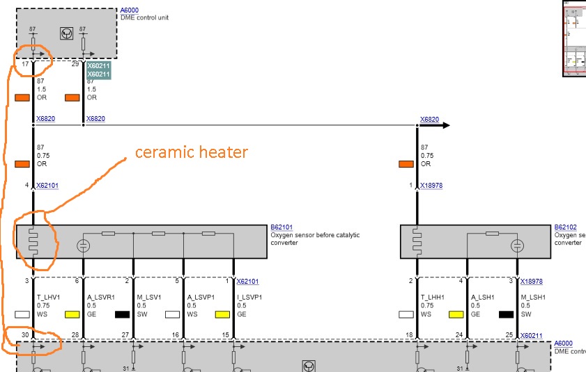

6 years 6 months ago - 6 years 6 months ago #39088 by MinionDK
@Monde: I found the wiring diagram for the upstream wideband O2 sensor earlier today, but I havent found the pin assignments yet (2 white wires are the heater circuit, one woud presume). Would I need to test the voltage?

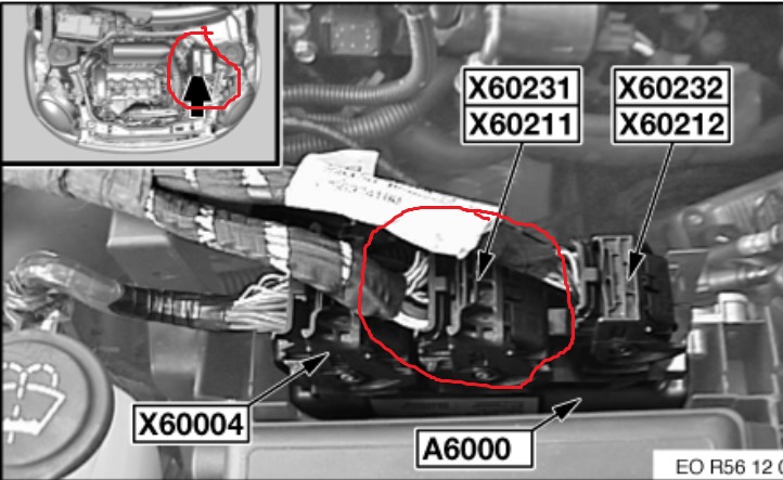

6 years 6 months ago #39136 by tech25
Hey there... thanks for the PM.. Ok... I would first measure the resistance of the heater element in the pre 02 sensor with a DVOM. Do this by disconnecting connector X60211 on the DME. then looking at the pins 17 and 30 Measure the resistance ( ohms ) from those pins, should be around 3.5 - 4.0 ohms.
see included pics for connector and pin locatons.

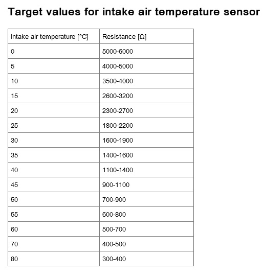

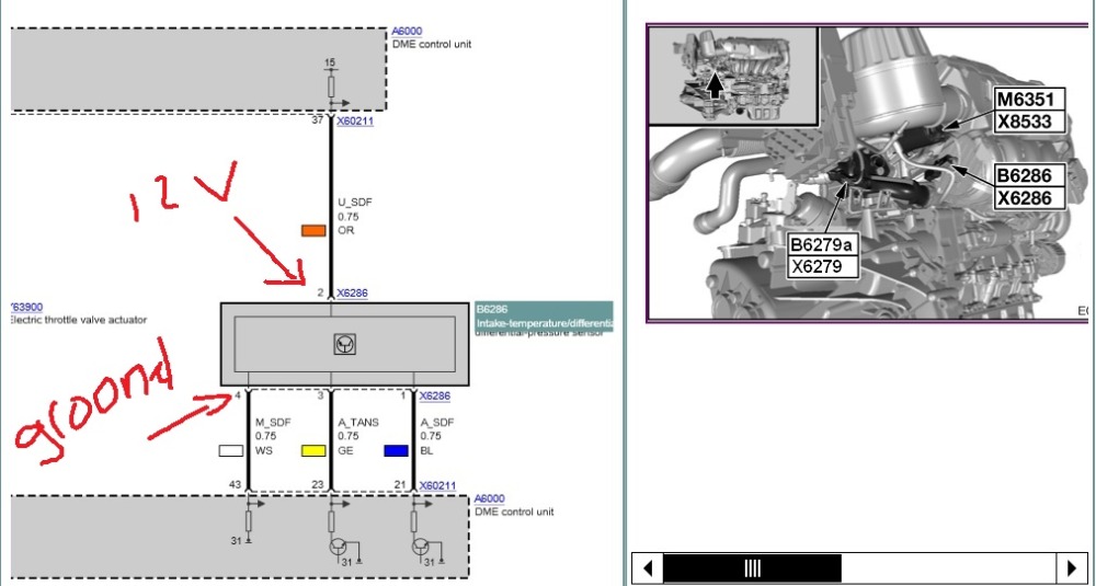

I wouldnt really worry about that now... test the 02 sensor, and probably replace. however if you want to test. maybe you can. but not really well. you either have a analog sensor, and a digital sensor. I'm not sure what one you have.
however you can back probe either pin 1, or 3 and see what you get. one is the temp sensor, and one is the map sensor.
check resistance according to the chart from measuring resistance from pin 2, and to pin 1 or 3 and see if any reading is close to the enclosed chart.
I attached a pico scope explanation on how you can kinda test it. normally with key on, engine off around 5v, and with engine at idle under a vacuum around 1.0v.
if you have have a digital sensor you have to measure the hz. edit... picture of 12v is probably not true, more likely 5v

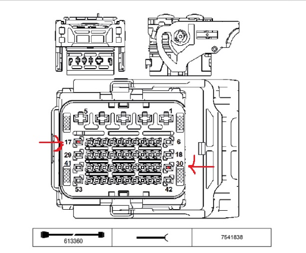

6 years 6 months ago - 6 years 6 months ago #39205 by MinionDK
Hi @tech25
I finally got a chance to carry out the tests on the O2 heater circuit.
I disconnected battery negative terminal before I began.
DME: pins 17 and 30 are reading O.L.
Sensor connector: unplugget it and measured resistance between pins 3 and 4 few times in the space of 5 minutes - got between 3.7Ω and 3.9Ω.
Should I suspect an open in the harness?

6 years 6 months ago - 6 years 6 months ago #39215 by MinionDK
All right, thanks. I will get to it in the morning.
I don't have bidirectional control. Having the engine ON might be the condition for the heater to be on. Is that an option for the ground check (back probing)?
Ok, so to elaborate on my last test: pin 30 & 17 on the PCM gave me OL, then I went down to the sensor connector, disconnected it, and measured sensor side (my 2nd picture) terminal 3 & 4 which had the proper resistance as specified. Would that be an open heater circuit or open in the wiring harness to the PCM? Just want to make sure there was no lack of clarity as to what I did, before we condemn the sensor.

6 years 6 months ago - 6 years 6 months ago #39223 by MinionDK
The two terminals on the sensor that were reading resistance are pin 3 and 4, which are connected to the orange and white wires, which I assumed to be the heater circuit, as per tech25's drawing. Or is it the two white wires (ie. pin 3 & 5)? I'm using the pin numbers from the wiring diagram because the sensor side wiring is wrapped up tightly and no colors are visible.
A little note: It's a wideband/air-fuel O2 sensor by Bosch (LSU 4.9). I found a datasheet here , it seems to suggest pin 3 and 4 are the heater ±.

6 years 6 months ago #39235 by tech25
please confirm there is no break in the harness from the o2 sensor to the dme. disconnect dme, and o2 sensor and test harness for resistance. no more than .7 ohms, and check for short to power, and short to ground.
