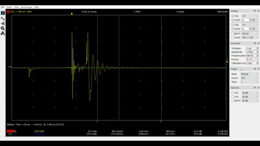

Hi, I have a 2010 kia forte with the 2.0 theta engine. I am getting an intermittent misfire on cylinder 1 under load, usually around 40mph it will happen. Although I have gotten p0304 before as well but it mostly seems to be p0301, I am assuming because it is the companion cylinder.
When viewing the misfire data it does not always feel like it is missing. I can feel it once the check engine light starts flashing, and sometimes it will stop and other times it will continue until you restart the car.
I have replaced spark plugs, swapped the coil and spark plug, cleaned the map sensor, new injectors and fuel sending unit (there was a high ltft, knock sensor code, and fuel filter was pretty dirty). Also checked compression and I believe cylinder 1 was highest at around 240 and cylinder 4 was lowest around 225 (I'm thinking my gauge reads high).
I got some secondary ignition waveforms for cylinder one after a short drive (using the probe connected to a penny taped on the top of coil, so not sure how accurate they are). Misfire data indicates misfires occured around 50 seconds, 1:30, and 4:30 in the video. At 1:30 the check engine light was flashing, and the waveforms look pretty crazy. Can anyone help make sense of these?

watching the capture after a while there you’ll see the end of burn line jump up really high. This signals a lean misfire.
I’ve included a screenshot of your video to show you what I mean.
Power brake it and with the scope if you can.
I’d move toward fuel.

That's what I was leaning towards after researching, thanks for the conformation. What do you mean by power brake it and with the scope? I will try swapping the injector though. I wish I could test fuel pressure but adapters are too expensive for this car. If swapping injectors doesn't work then I'm guessing the new fuel sending unit is no good. Either that or ecu isn't sending the injector signal. I guess I could add that to the second channel. Or maybe the ecu is turning the injector off when it sees the miss?

In this case where you have single cylinder miss I wouldn’t think fuel pump right away. That would have an all cylinder effect. Swapping the injector is a good idea.
Can you lower the time base for a more detailed capture? I want to rule out worn cam lobes.

It looks, to me, that your Firing and Spark lines are both low. (maybe just a characteristic of the Penny-probe) How is the spark plug gap? Can you post a waveform of a good cylinder to compare?

I'm gonna be that hater and say you may still be dealing with an ignition problem. :lol: I completely agree that the high 'tail' at the end of the burn line screams lean. BUT, I really don't like the strong coil oscillations that come after. That coil is RINGING. :silly:
Have you tried any swapnostics on your replacement coils/plugs?

I believe that is just due to the penny probe, as another cylinder looked the same. I will get a waveform from a good cylinder. Spark plug gap is good, about .042" I think.

Yeah those oscillations were pretty concerning.. I'm wondering if the ecu is shutting off the injector when it starts missing/mil flashing? Misfires at around 50 seconds in the video did not cause mil to flash.
I swapped the coils and plugs with no change.
