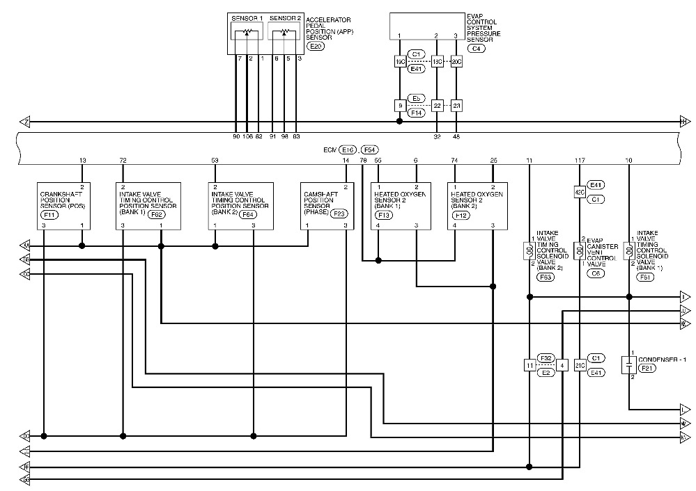

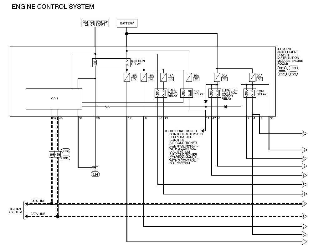

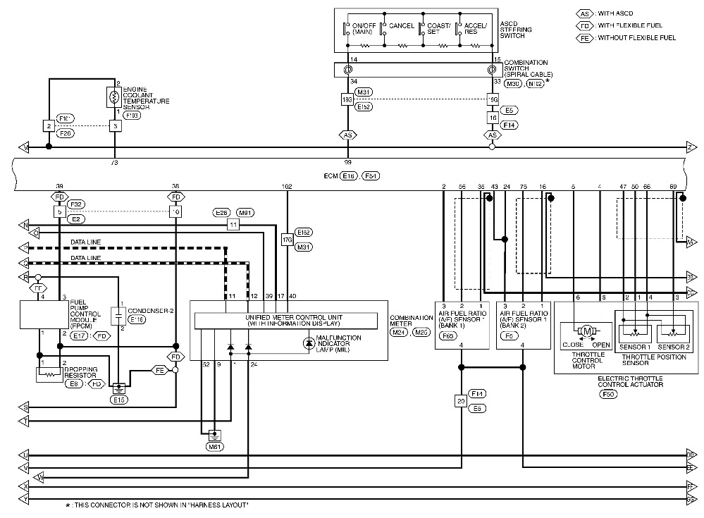

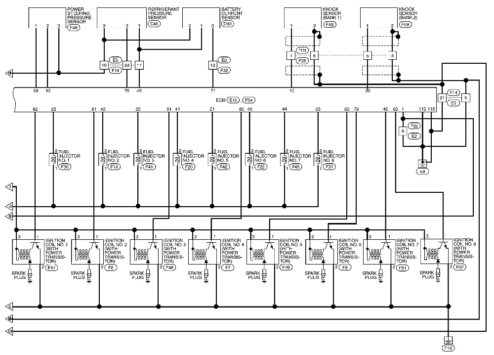

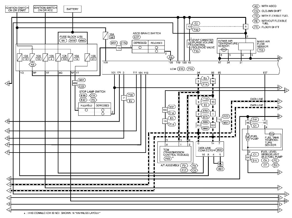

6 years 7 months ago #38461 by John Curtis
Replied by John Curtis on topic MAS showing 1.14g/s with engine off?
Here’s diagrams.
I agree that it may be a wiring issue.
I would test by other means than a scan tool as you should never completely trust your scan tool data.
I’d be curious and put a fan in front of it with KOEO and see if the MAF value changes. Not high tech but sometimes simple things give good direction.

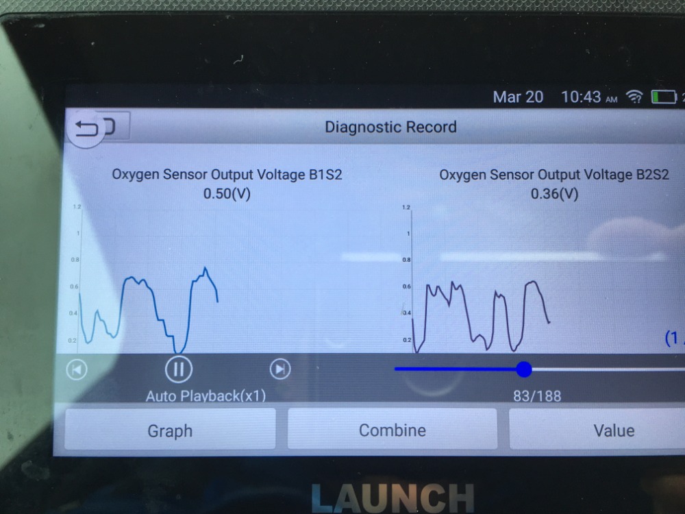

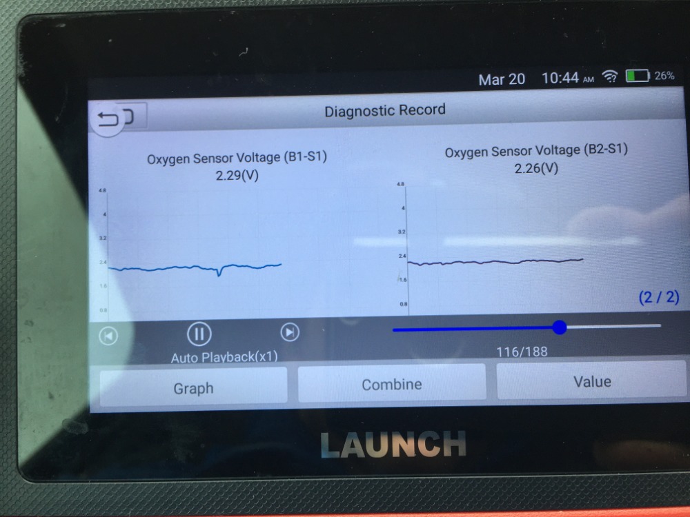

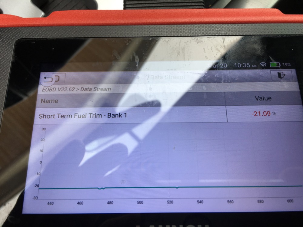

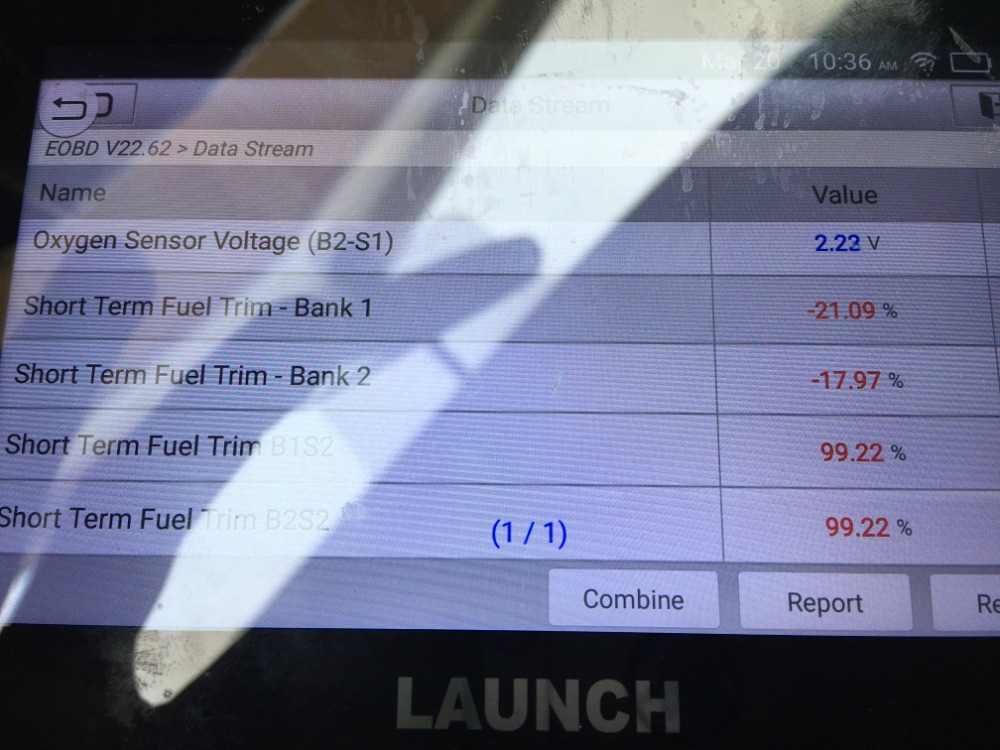

6 years 7 months ago #38505 by 9w1911
Replied by 9w1911 on topic MAS showing 1.14g/s with engine off?
Did not check voltage at the MAF today it was a bit cold, windy and snowy. I did get some live data to show and interested in the feedback. Thanks!
The feedback I got today was cold air intake caused the truck to run super lean and trash the cats.

  • VegasJAK
  • VegasJAK's Avatar
  • Silencing the Parts Cannon
6 years 7 months ago #38534 by VegasJAK
Replied by VegasJAK on topic MAS showing 1.14g/s with engine off?
the sensor reading you are seeing are air fuel sensors... they will be a steady voltage reading. for nissan its 2.2v. the important trim to look at are the LTFT's. your STFT are neg 21 and 17, but its important to know what the long term trim are.
don't get too worried just yet about the cat's... that MAF sensor can cause what you're seeing. unplugging the MAF is a test you can do, but it's not full proof. when plugging the MAF back in, turn off the engine and key off for about 5sec before restarting. this will reset your MAF pid so it reports properly again.
your engine is getting too much fuel so the pcm is taking it away in an attempt to return to stoich.
