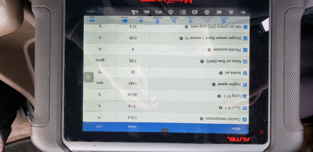

Working on a 2000 Toyota Tacoma with a idle at warm up around 1100-1500 RPM's. When I first start the truck the idle seems to be a little low in open loop at around 900 RPM's, but when it goes to closed loop it idles very high from 1100-1500 RPM's. Also, the short term and long term fuel trims are negative at around 14-20 percent. Any help is great appreciated. See attached picture.

If I pull a vacuum line the truck will idle down considerably. I have verified that the ECT sensor is good. The O2 sensor B1S1 is reading correctly as well. Originally the truck had no power and when I did a WOT test, the O2 B1S1 was reading very lean and this was because of the dirty MAF in which I cleaned & eventually replaced. Either way though the high idle was before and after the MAF replacement. The power has been restored to the truck, but there is still a very high idle and negative fuel trims. I also checked the fuel pressure before the regulator which was 44 PSI. I have not checked it after the regulator as it is hard to get access to. Originally, it had a P0171/P0174 lean codes, but I believe that had to do with the dirty MAF as no codes have come back since then.

what is your PID data on the following
RPM
Desired RPM
IAC position
  • BLEE
  • BLEE's Avatar Topic Author
6 years 8 months ago - 6 years 8 months ago #37596 by BLEE
RPM - 1393
Idle Air Control Duty Ratio - 22.6%
There is no desired RPM PID available.
Last edit: 6 years 8 months ago by BLEE.

IAC position % is showing that the IAC valve is almost closed. Check the throttle bore where the throttle plate comes in contact with the bore and look for black carbon build up. Clean with a tooth brush and carb cleaner. Too much air getting past the throttle plate, IAC compensates by closing.

Nice info on the IAC. Thank you. I unplugged the MAF and it dies. If the IAC is at 22.6%, it must be getting air from somewhere else or like you said maybe a worn throttle body perhaps? I am not sure why the fuel trims are so negative though. Although they are only negative at idle for that RPM and load range.
