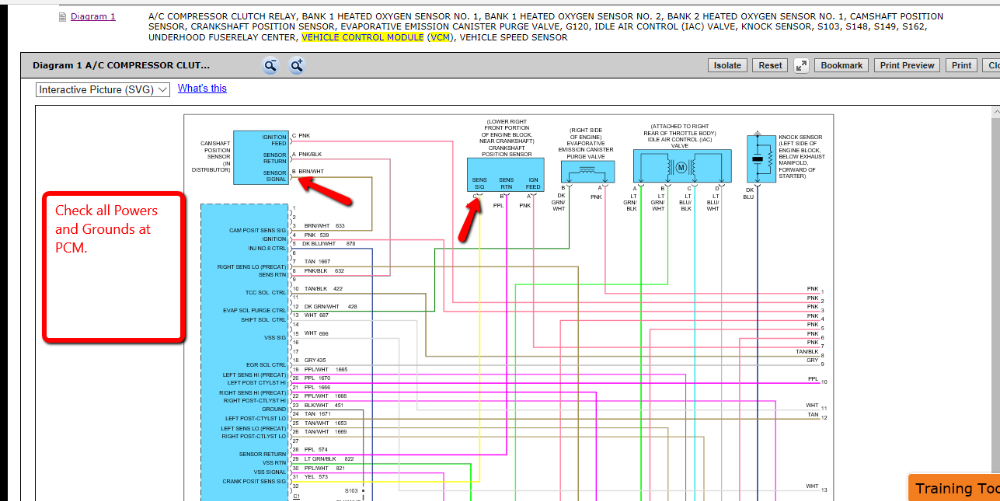

6 years 8 months ago #37742 by rpd1125
Replied by rpd1125 on topic Re:Crank no start
Hey this is Ruben in Phoenix az.
I have attached wiring diagram for this vehicle below with two simple checks that should give you some direction.
Check waveform signal with any labscope at cam and crank sensors at most easily accessible location for you. PCM is always a good place usually up front by radiator driver side.
You should have waveform on both of those sensors. You clearly have voltage at them so now time to check signal.
IF you have signal at both( if you can upload waveforms on both would be great), Next step is to check the powers and grounds at PCM. Can you communicate with PCM? Im curious if you are.
IF you don't have spark this is the first place to start to get a better idea we gotta have the inputs to the PCM and check them.
Hope this helps
