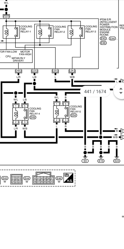

I would start with the No Communication. The cooling fans running, and the starter not cranking ( I am assuming that it is a No-Crank, No-Start? ) could be a symptom of the communication problem.
Disconnect the battery and check the resistance between pins 6 and 14, at the DLC. You want to see 60Ω.
Diagrams are attached, below.

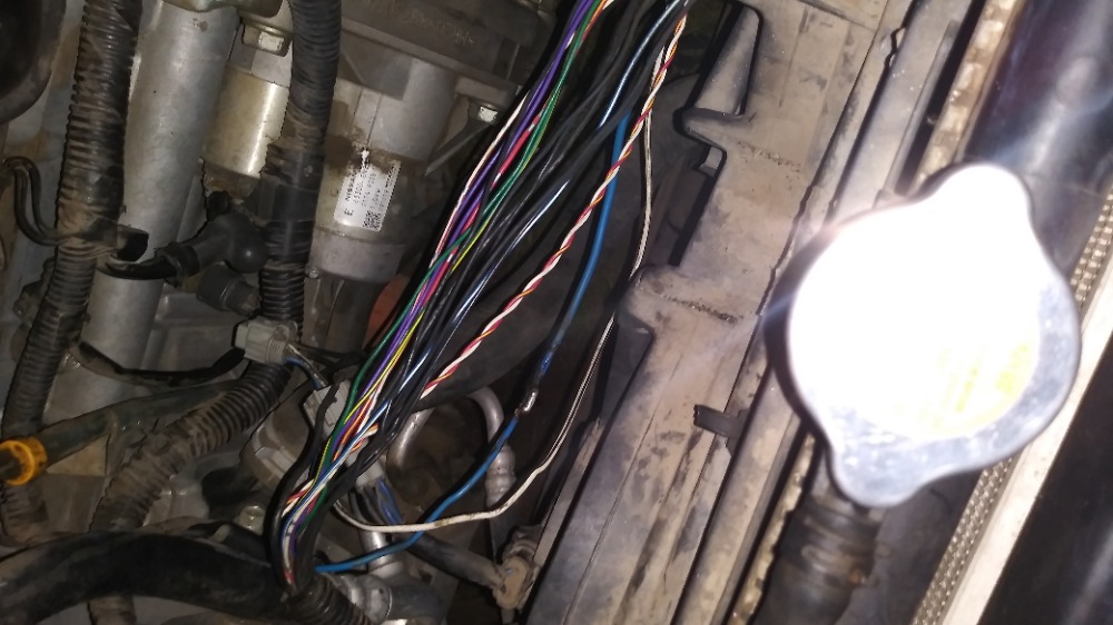

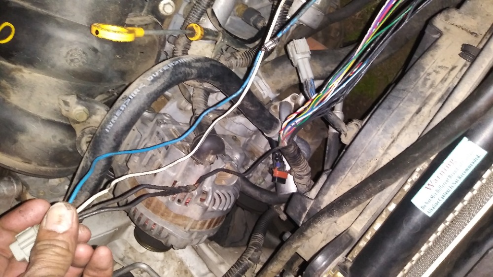

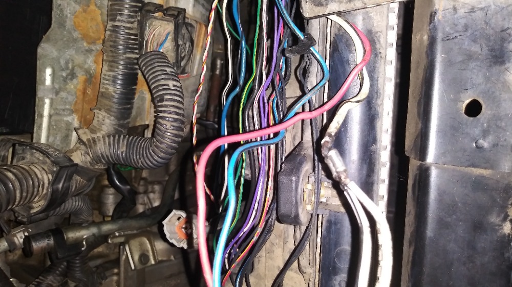

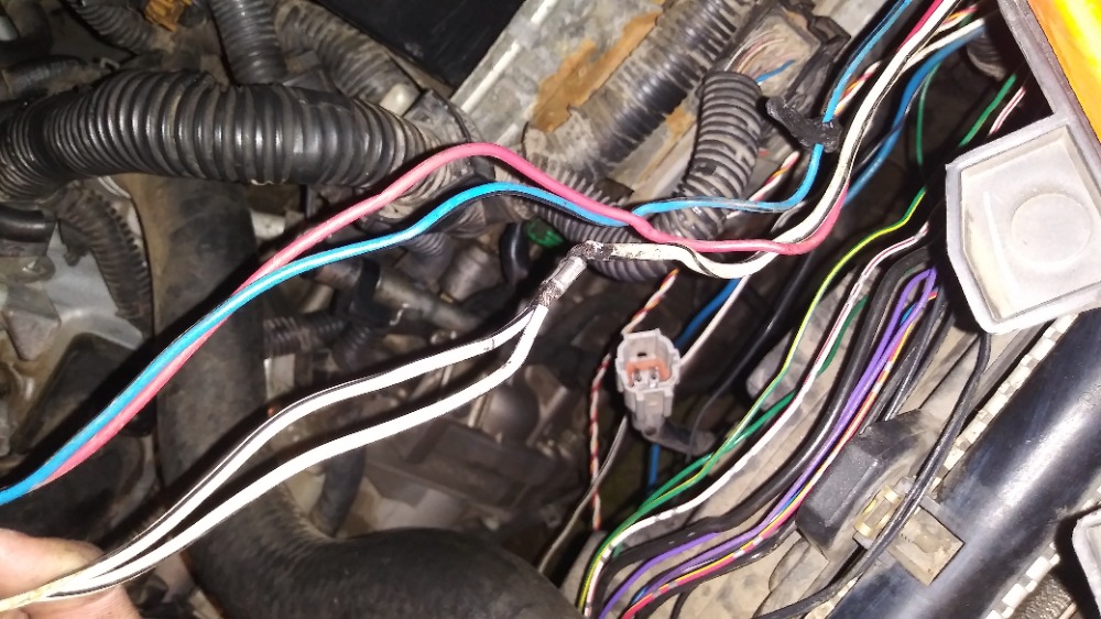

Car kept blowing low beam fuse .
Found out today it's a salvage that had front end smashed in and fans were connected where they found power with no regard for where or to where it was going aslong as fans came on there is one Blue with black stripe wire connected to a white with black stripe wire
Another white with black stripe wire connected to a solid white wire both connected to power distribution box.
I looked at wire dÃagram and it's just don't seem right could that be cuasing the problems also?

Yikes, I just saw the picture of the wires. This is gonna get good...
