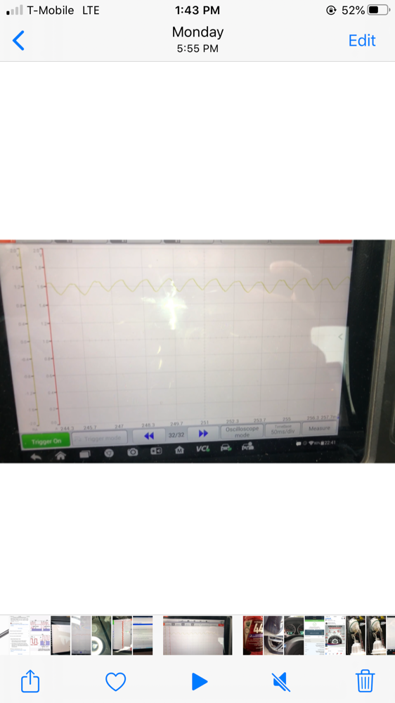

Either your new pump is junk, or you have some kind of voltage drop in the pump circuit. ;) If you have an amp probe, you can measure pump current to check for a voltage drop concern. Otherwise, you'll need to get to the pump connector.
You can do direct voltage measurements with the pump plugged in (if possible), or unplug the connector and substitute a heavy load. Two headlamp bulbs would work. If you have power and ground, your new pump is bad. If you find the bulbs won't light brightly, or you find excessive voltage drop, pursue the offending circuit.

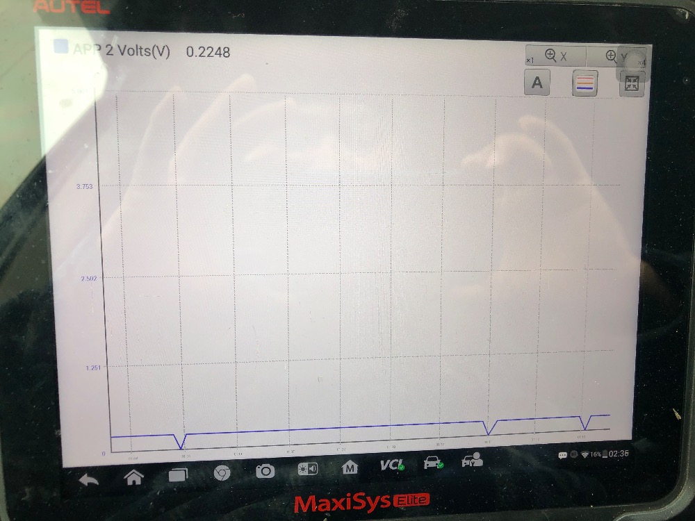

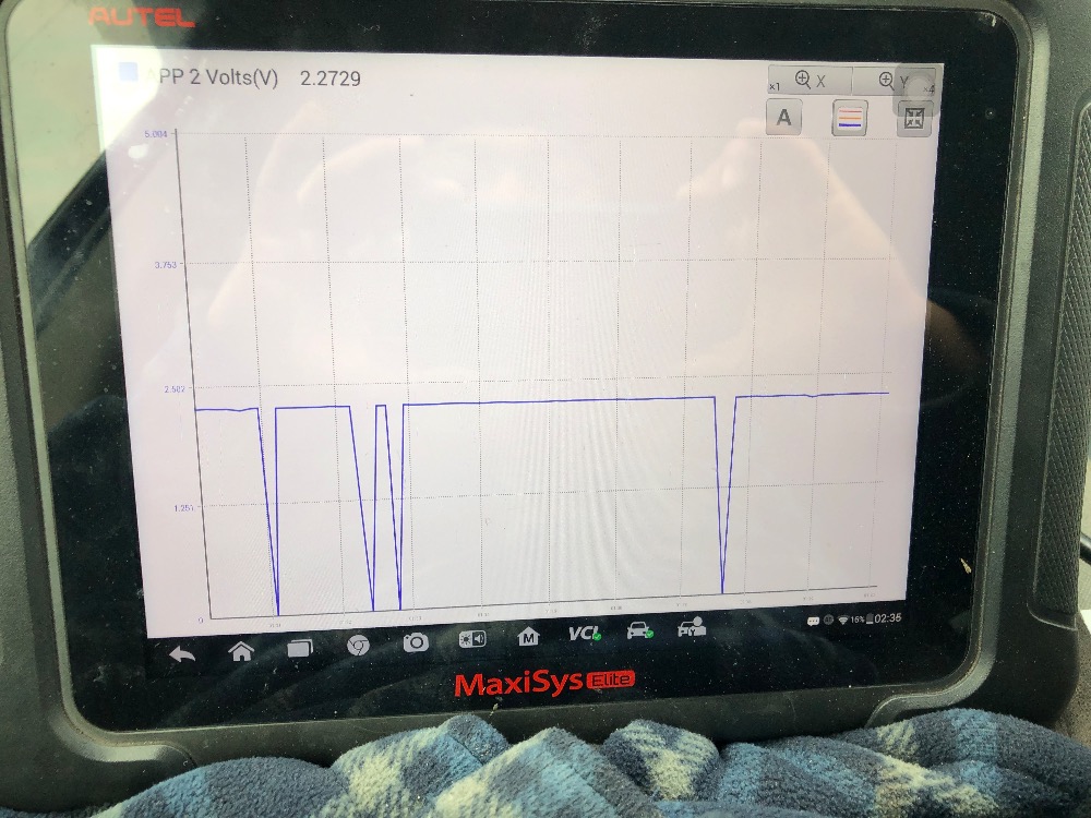

6 years 8 months ago - 6 years 8 months ago #37421 by gerber
Do yo think the throttle body has to do something with this problem. Because i see voltage drop app 2 and i know this voltage drop is not right first picture is without press the pedal. And secound picture is at wot.

6 years 8 months ago #37424 by Tyler
You only see the dropouts on APP 2, right? I'm pretty sure you're looking at a PCM circuit fault detection strategy. ;) It's intentional, weird as it sounds. The PCM will pulse APP 2 to ground and look for the same pulsing in APP 1. It's there to check for shorts between the two circuits.
If you were to scope the same circuit, you'd see the pulsing to ground is actually far more frequent. It only looks that way on the scanner because of it's limited data rate.
So the short answer is, no. :silly: Normal condition.
6 years 8 months ago #37425 by Tyler
I can't see the scale on your scope capture. :( Looks good from what I can see. If it's in the 7-10 amp range and stays there during a WOT snap, you're done. Pump time (again).

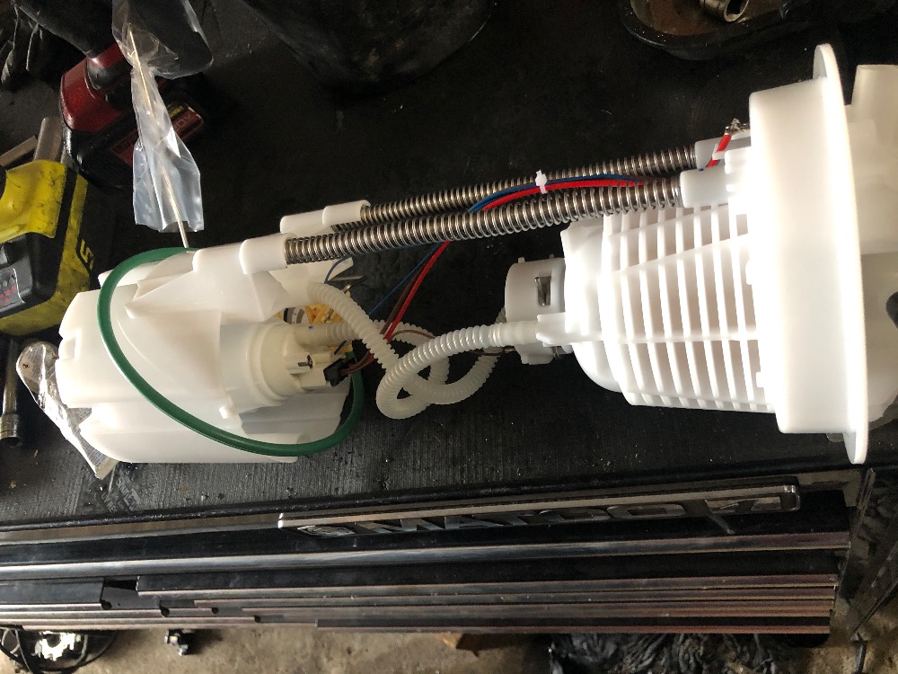

6 years 8 months ago #37430 by gerber
I just i stall another pump because has warranty. But still the same .
At idle works at 60. But at (wot) drops
To 30
6 years 8 months ago #37431 by Tyler
Are you replacing just the pump itself? Or the pump assembly?
If you've been getting assemblies, and power/ground at the pump is solid, then the new pumps don't have any excuses. :lol: Switch brands if you have to.

6 years 8 months ago #37433 by gerber
App 1. is not doing stay in a parallel line when i press the gas pedal

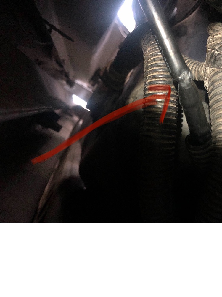

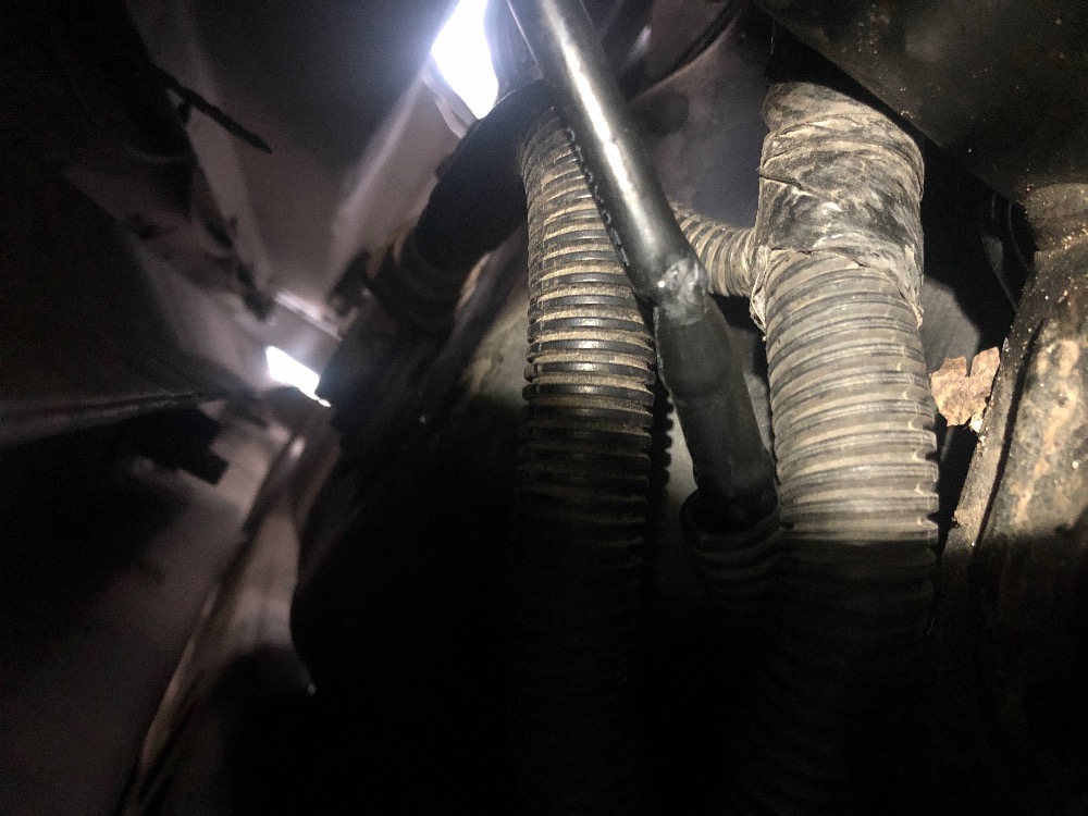

6 years 8 months ago #37439 by gerber
I think i find the problem look at the picture. Some one boosted the line qnd twist.

6 years 8 months ago #37447 by Tyler
gerber wrote: I think i find the problem look at the picture. Some one boosted the line qnd twist.
I think you're onto something. B) Had the pump been changed before you got to it?

6 years 8 months ago #37466 by gerber
Yes some work on it before me. That was the problem
