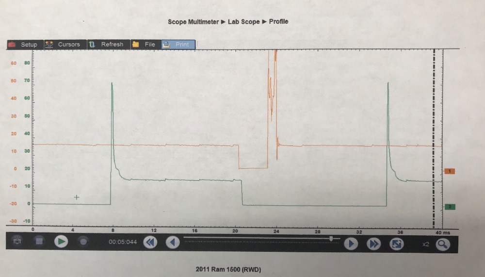

So I’m having a fun day trying to figure out why I have a cylinder 5 misfire on a 2011 Ram 1500 with a 5.7l. Compression is good, good coil and plugs, no intake leaks, vacuum test tells me valve sprigs are good, and solid cam and crank signals, also a good injector balance test. Then I saw the waveform of coil and injector and wondered why injector is spraying fuel at the same time the spark takes place. Truck runs good until the PCM turns coil and injector off at 55mph.

That kind of injector timing isn't unusual, in my experience. You'd think it'd fire on the intake stroke, right? But few do. My car fires the injector during the exhaust stroke. :silly:
Definitely pursue the difference in running compression. With those numbers, and the misfire you're describing, leads me to think about worn cam lobes.
