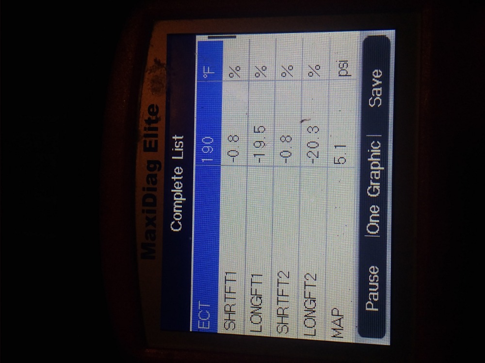

2005 f 150 with 4.6 drive by wire with -20%LT fuel trims on both banks .It stays at -20%LTFT at all loads and rpms . My second issue, is that it also has no power and very poor throttle response at dead stop in 1st gear/reverse. when I push the gas peddle to accelerate normally ( half throttle) nothing happens for 2-4 seconds while rpm is limited to 1600. During this event the truck rolls forward very slowly, as if i'm only applying 10%throttle. Then finally after reaching about 8 mph in that state, it will finally rev up beyond 1600 rpm and acts normal. it has plenty of power, and responsiveness in all other gears and speed ranges beyond 8mph.
fuel pressure is at spec .( 38 psi at idle) and jumps to 45 psi when push the throttle. (Has 45 psi during hesitation)
oxygen sensors are oscillating from .1 to.9 like they should. +/- 5% on short terms and respond instantly to vacuum leaks and added propane.
parts i have replaced with no change to the above mentioned conditions.
1 MAF sensor
2 EGR module with MAP
3 up stream 02's
4 throttle body/TPS
5 FPDM
6 All coils, its not misfiring.
7 all injectors,with KAM reset. it relearned - 20% LTFT on both banks agin.
I have been trying to find the issue for a year now unsuccessfully . it just doesn't want to rev up at a stop and pulling out in front of people is a concern because sometimes it accelerates fine but some times it just slowly eases along no matter how hard i push the peddle. ive gon over all the causes of neg fuel trims and cant find the cause, any input is greatly appreciated

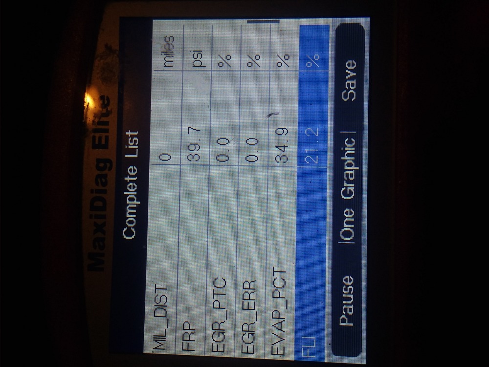

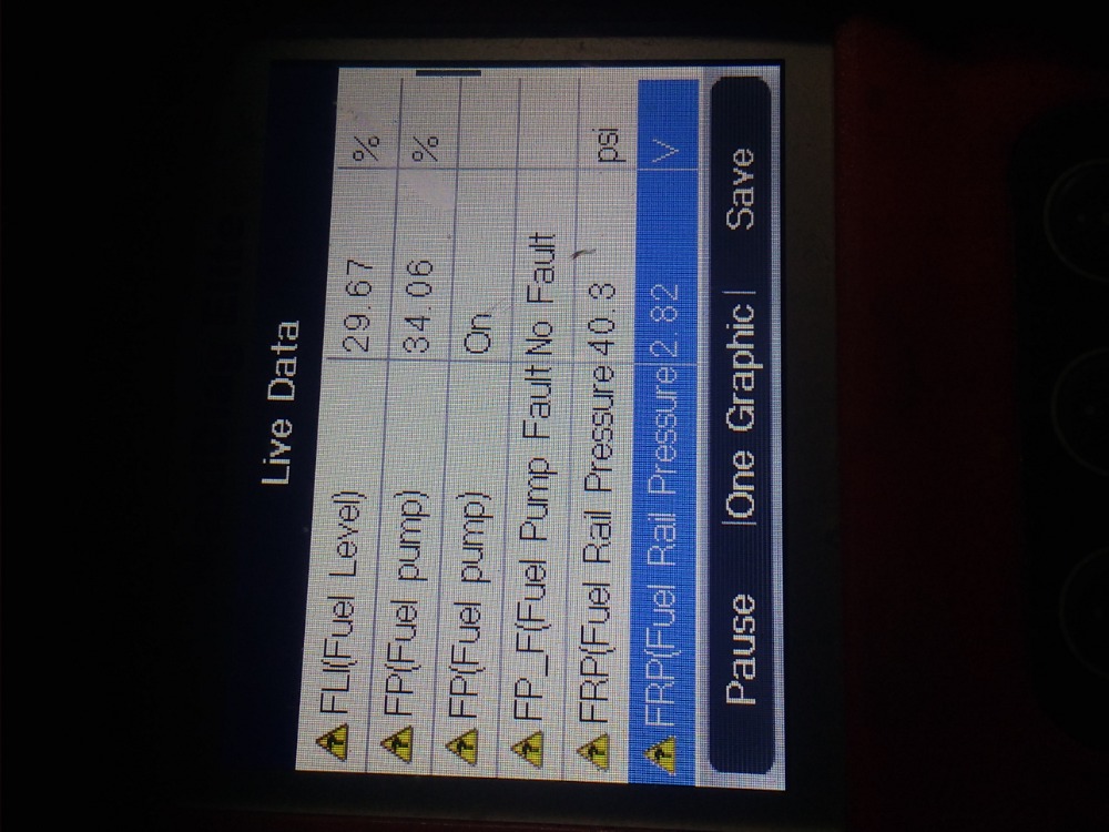

Its an electronic returnless fuel system with a pressure sensor on the fuel rail.(I have changed it also) when i remove the vacuum line on the sensor, scan tool shows no change on scan tool psi, but on a mechanical gauge it rises to 47 psi. when i disconnect the FRPS scan data says 75 PSI but mechanical gauge says 20 psi .

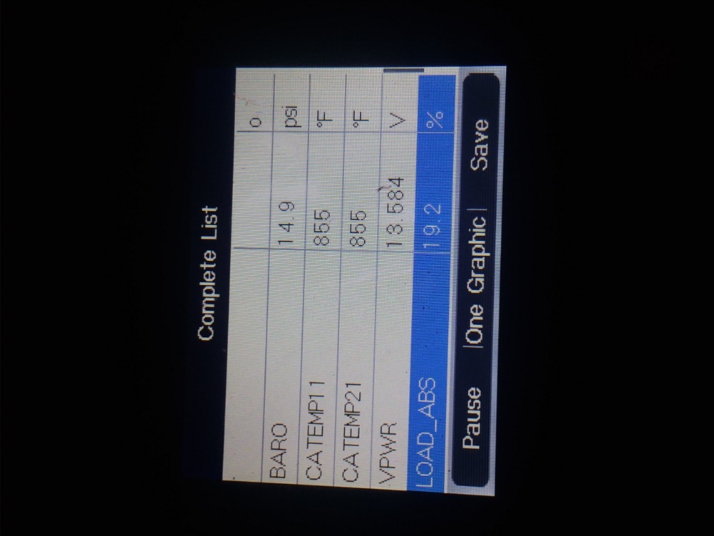

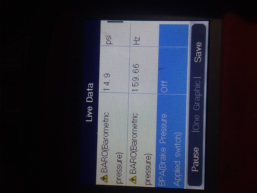

These are my pids at idle after getting the engine to operating temp.
rpm 700
calculated load 25-30% at idle with all accessories off. ( i think its high)
STFT1 +/- 5% LTFT1 -20% up stream 02's are both switching like normal with current trim numbers
STFT2 +/-5% LTFT2 -20%
ECT 190 'F IAT 79 ' F
MAP 5.1 psi MAF 0.01 lb/s
FRP 40 psi EVAP % 34.9%
BARO 14.9 psi / 159.66 HZ
SPARK ADV = 12.5 degrees
While gathering this data just now, my LTFT on both banks maxed out at -26.6%, which puts it in open loop fault and then trims go to 0's and codes p2196 and p2198 set (02 sensor signal biased/stuck rich). I have never seen it get this bad until now. I drove a few miles and checked again and they settled back at -20 on the long terms. .

6 years 8 months ago #37248 by VegasJAK
duty cycle on fuel pump is staying at 50%. the cycle is controlled by the pcm from input from the temp sensor and rpm. temp looks low... should be around the 210 mark. check rpm signal as well. cycle should drop to 25% after startup.

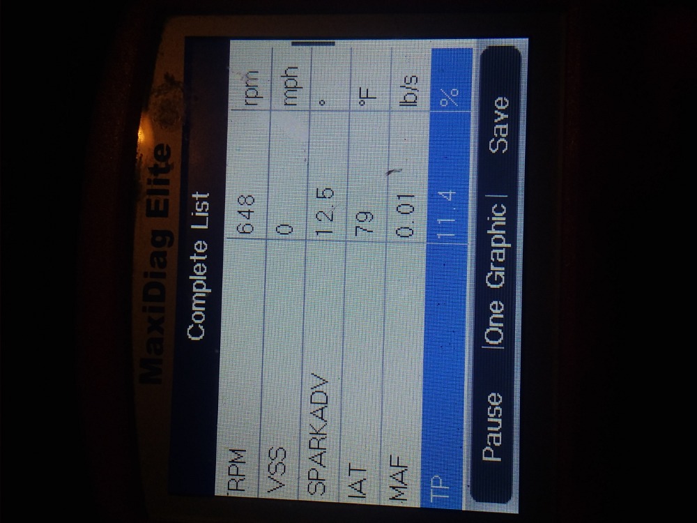

6 years 8 months ago #37269 by guafa
Maf: 0.01 lb/s instead of 0.1 lb/s? Please confirm.

6 years 8 months ago #37270 by Patrickreaves
Replied by Patrickreaves on topic 2005 f 150 4.6 has -20% fuel trims on both banks
Maf reading at idle

6 years 8 months ago - 6 years 8 months ago #37272 by Patrickreaves
Yes . maf reading at idle is 0.01lb/s, and with a WOT snap it maxed at .32 lb/s

6 years 8 months ago #37276 by guafa
0.01 lb/s x 60 sec = 0.6 lb/min.
This is a low number for me. I would expect at idle about 4 lb/min.
6 years 8 months ago #37281 by Tutti57
I was thinking that too, but am not sure about the g/s conversion, so that number might be ok?

6 years 8 months ago #37286 by VegasJAK
coolant range for ford 4.6 is 190 to 225. that is the thermostat opens at 190. is the upper coolant hose hot to the touch? might want to test that coolant temp manually.
the .01lb/s comes out to 4.5g/s for the MAF as it should be.
