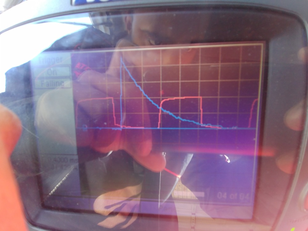

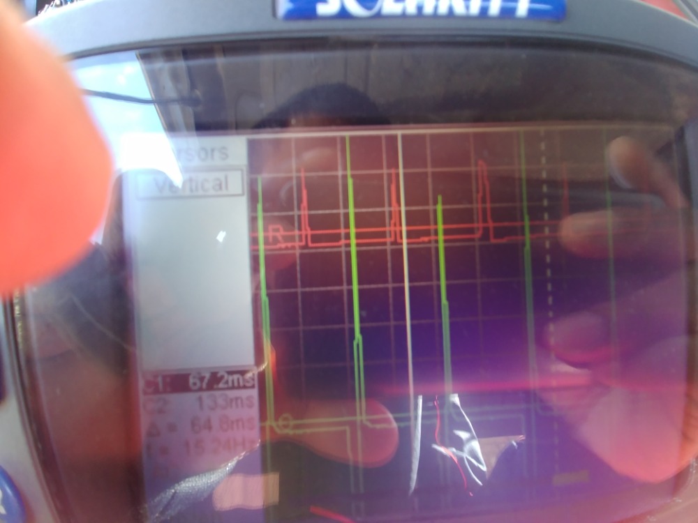

Ok. so ive been racking my brain on this thing. any and all help appreciated!
Warning: Spoiler!
symptoms: idles well, but as soon as you get on throttle it stumbles and sputters. If you ease into it, it will go normally.
codes p0340, but distributor and wiring has been checked and swapped distributors.
What ive done: checked timing chain, distributor timing, firing order, compression, TPS signal and adjustment, MAP signal, Knock Signal, ECT sensor, o2 signals, and im sure im missing alot more.
Ive had a scope on it and verified spark happening on time. the only thing that i found that was off of what nissan specified was maf signal. it was fine on low load and idle, but when you rev to 4k rpm the voltage does not reach what is specified. I checked the wiring and tried a known good sensor and still no dice. Also it seems as soon as you get into throttle it falls into open loop mode until you let off again. as soon as it hit open loop under load it fucks up. But i need to know what is causing it to go into open loop. Am i doing something wrong???? Missing something????

Vacuum is about 17in hg on a compound gauge and I checked timing marks on the cam and crank sprockets, as well as with a timing light for ignition timing. The pics I posted above were of cam signal and coil voltage on negative of coil. Also on scan tool ignition advance is 20° which is what nissan specifies give or take 2.

Firing voltage is around 7 to 10k. I dont remember burn time and oscillation off the top of my head but they were all equal across all cylinders. I had scope hooked up on a test drive and amplitudes didn't change when it started messing up. Voltages were still constant and waveforms were still in time with cam angle and spark event. I do think theres a slight leaking injector as when I pump up pressure and lock off supply the pressure bleeds down slowly. But I mean like a few psi in half hour slow. I dont think that would cause total loss of power on load but revs fine in park or neutral. I've also tried swapping a good ecu in from another running car and same issue. I notice the code hasnt come back since new distributor but still same issue. This is absolutely ducking my brain. I have been thinking about the open loop operation. The only think I can think of that I didnt check is o2 heater. Coolant temp reaches 190 to 205 ish, o2 waveform cycles 100 to 900 in about a 100 milliseconds. But what if the heater circuit has an issue. It would default to open loop. I think sensor is new but I'll verify with owner and check circuit and see what I can find.

If you scoped the ignition coils showing clear burn times etc then likely not an ignition issue. So in my mind that leaves fuel and air, what are the fuel trims reading? Does it smell rich? because a stumble can be caused by both lean and rich conditions.
