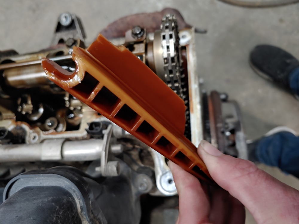

I have a 2005 ford mustang with 4.0l v6. It has a dtc p0106 map sensor out of range. It has no power and upon diagnosing ive ran across the followong, pid for map was showing 10.44 hgs vacuum at idle followed with a gauge with the same result. Snap the the throttle it drops to 0 and bounces to 21 22 hgs then back down to 10. Holding it at 2500 rpm the vacuum raises to 15 hgs. Compression check is around 105 to 115 on all cylinders, leak down test tested good so I'm leaning towards late valve timing causing this. Idk what to do next, timing advance at idle bounces from 3.5 up to 34 degrees and all around. Any incite into how to diagnose this problem the right way would be greatly appreciated. Also I watch a lot of your videos and habe learned so much thanks in advance...

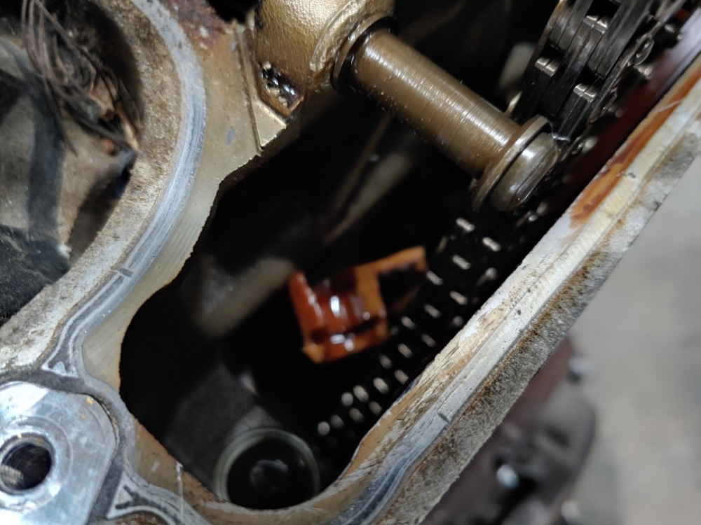

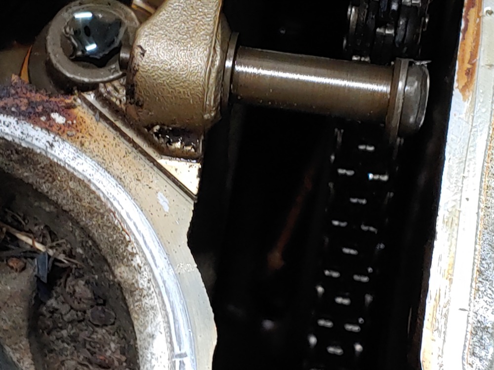

6 years 8 months ago #37148 by Theshorefix
Replied by Theshorefix on topic P0106 with low manifold vacuum
Yes I will, confirmed broken rear cassette.
  • Theshorefix
  • Theshorefix's Avatar Topic Author
6 years 8 months ago #37149 by Theshorefix
Confirmed, pulled motor and rear cassette is broke clean off, I don't know how it wasnt making any noise. That's for the help tho
  • Theshorefix
6 years 8 months ago #37150 by Theshorefix
I pulled the valve covers and my theory has been confirmed. Broken rear chain guide
