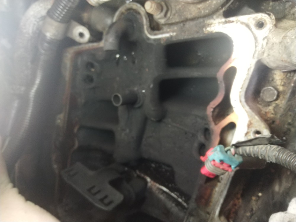

Was this taken at idle? The computer seems to think the engine is running lean, especially bank 2, so it's adding a lot of fuel to compensate. This could happen because of vacuum leaks, EGR stuck open, dirty MAF, clogged injectors or bad sensors (though all 4 o2 sensors are showing rich so I don't think it's them).

Yes it was taken at idle, I pulled the intake manifold. Lots of carbon buildup on top of the plenum. I also picked up a updaated spider injector from junk yard. Im going to swap the old one out and replace the gaskets.
